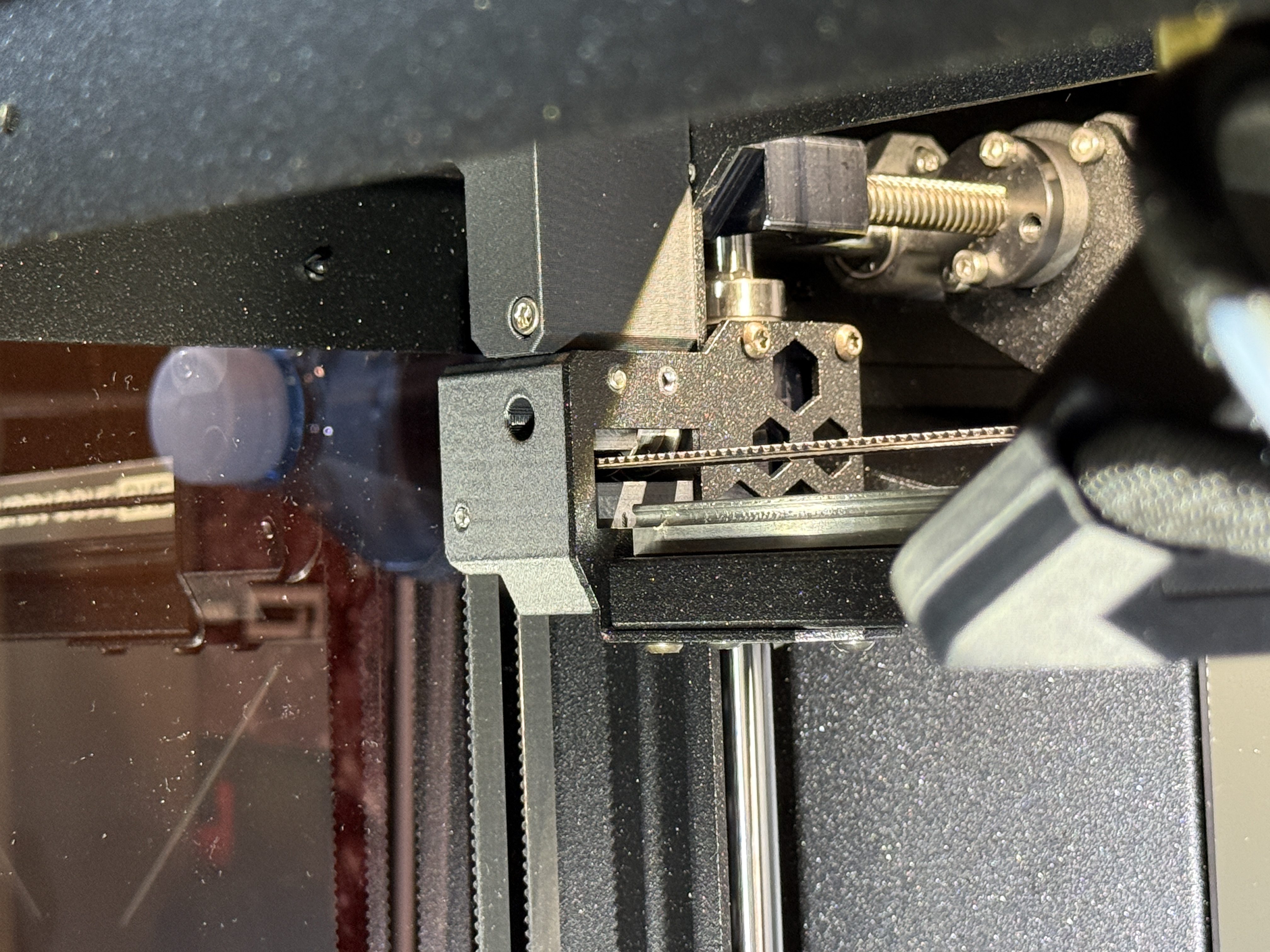

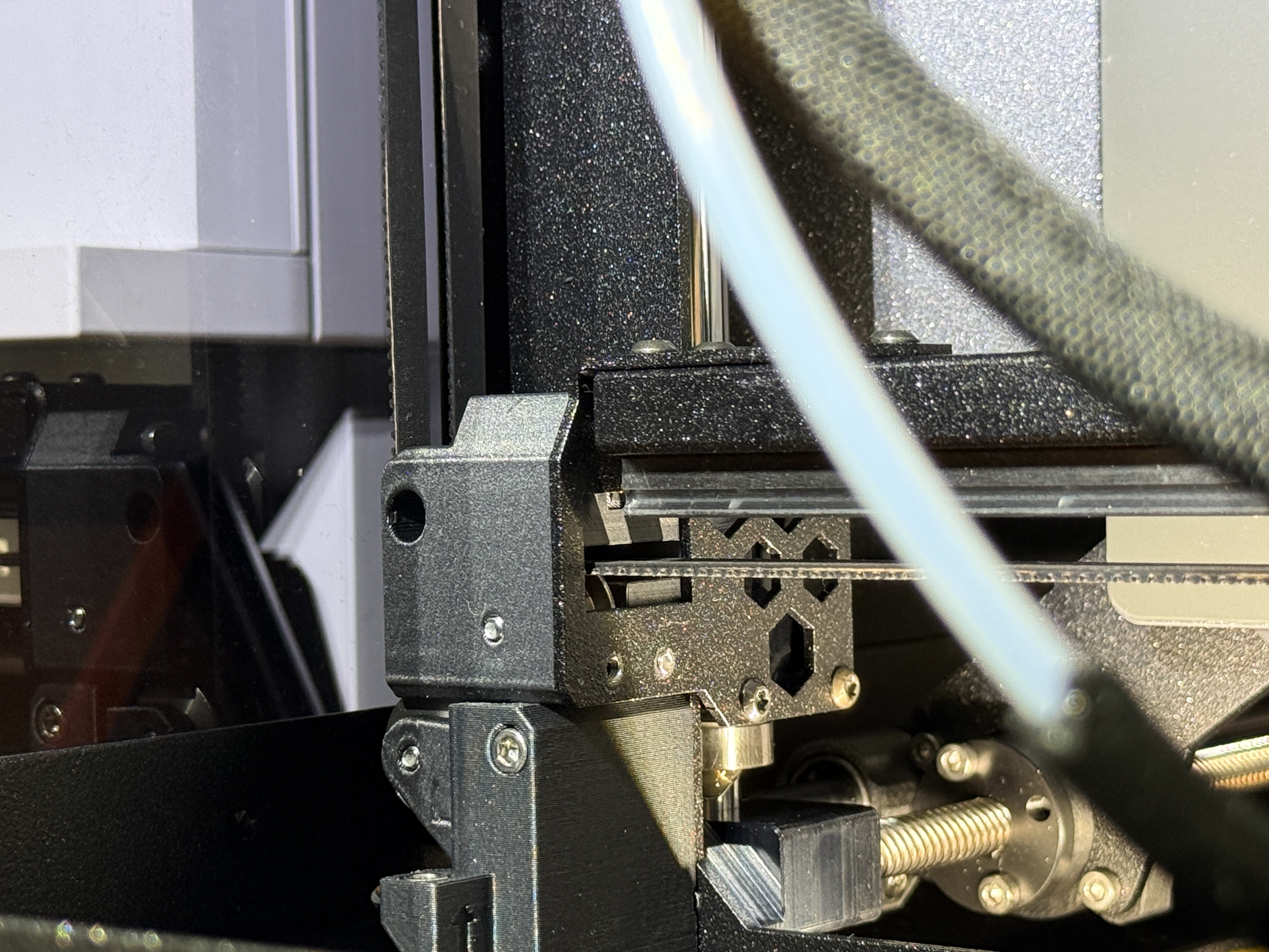

Hello all,
I have the same x/y axis calibration failure, however, the x gantry is square with the stops and I can achieve a perfect 85hz on both sides. I’ve been through this entire post and tried everything that was suggested with the exception of bending and shimming as it’s not necessary. No obstructions for the y-axis.
Aside from doing everything that was suggested already, I also performed a few hard resets to clear any memory that may be lingering to no avail.
Any and all suggestions are welcome. I reached out to support via email as chat isn’t available right now.

  1. Second image wouldn’t add.
Posted : 28/04/2025 7:13 am

Posted by: @nick-27
Hello all,
The gantry can temporarily square up when it's driven into the front stops, when in reality it's out of square in a metastable state, and will shift around and cause these sorts of errors. You should disable the motors, loosen the belts completely, and then check for squareness by moving the gantry to the front by hand. You can also move the gantry to the back stops and observe spacing on the opposite side.
Another thing I noticed with the gantry being out of square is that the print head will jump left or right (x-axis movement) if you drive the gantry (with the belts properly tensioned) along the y-axis into the back stops, and then into the front stops. This is an example of the instability/metastability I described above.
Posted : 28/04/2025 7:46 am

I appreciate the reply. Please see the attached video I just took. It seems there is no drift on the x-axis, and there is less than a 1mm gap on the rear left stop.
Posted : 28/04/2025 8:03 am

Before I point blame at Prusa, I’m going to approach this differently and assume that it was user-error that caused this; at least in my case. I’m going to disassemble the gantry entirely and then reassemble verifying square on all assemblies and parts.
What would help, and it’s something I think Prusa should provide, are torque specs for everything gantry related.
One thing of note, while some people are finding their linear holders aren’t bent at a perfect 90° angle, proper torque could possibly straighten these during installation.
I’ll keep you updated as to my progress with pictures if I remember.
