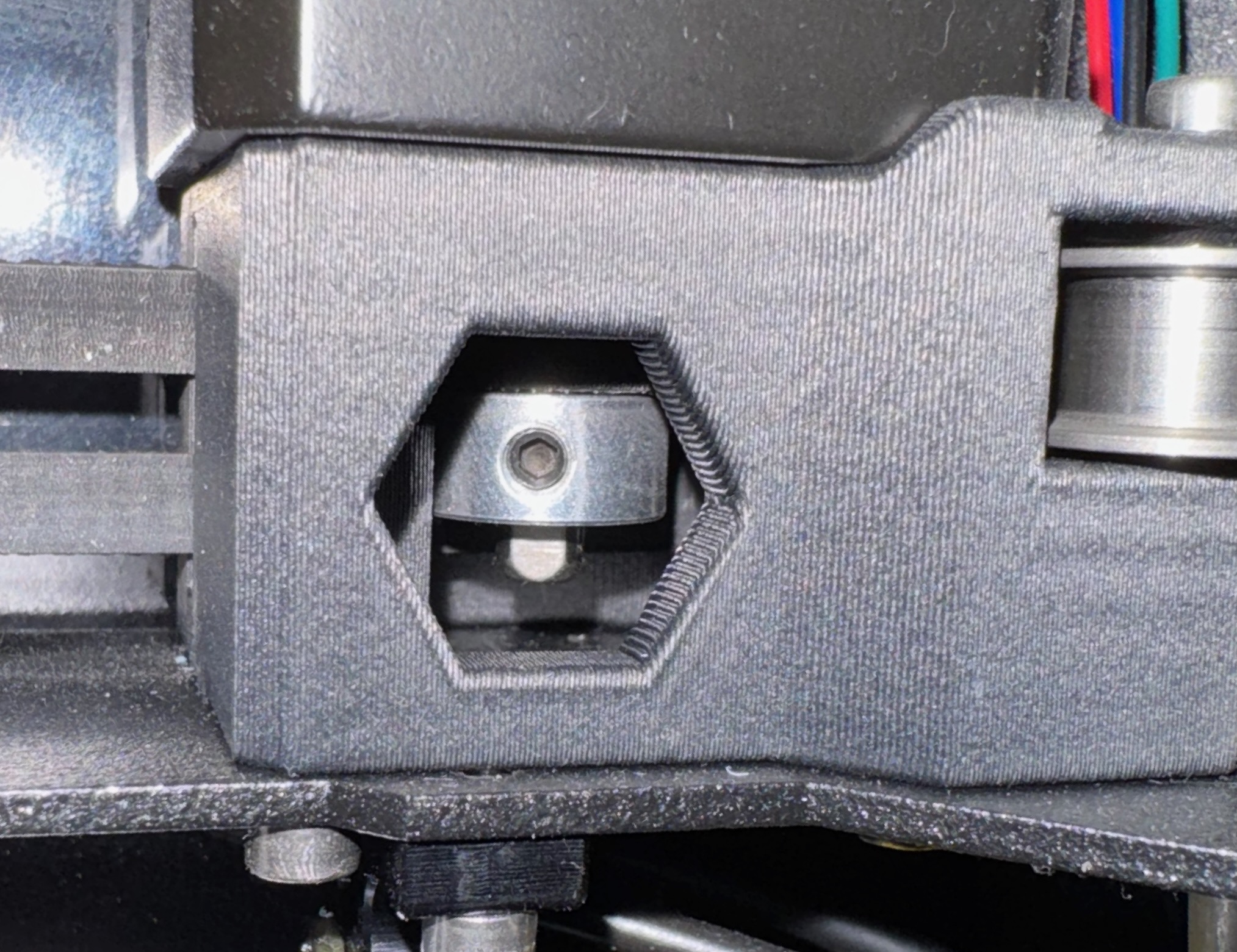

I seem to remember somewhere, there was a similar issue that was caused by the grub screw on the X or Y motor pulley that was not binding against the flat part of the motor shaft. This was on a factory assembled printer.
Yes, that's exactly what I tried to describe yesterday, but apparently was not clear. Can you find a photo for Martin which shows where to look, by any chance?

Here is the page that describes ensuring the grub screws are tightened against the flat part of the motor-shaft: https://help.prusa3d.com/guide/5-corexy-assembly_835522#843284
I've seen in a few places now, including a review of the Core One L on YouTube where factory assembled units had this problem. That is the person manually assembling the printer at Prusa wasn't following their own instructions.
Even if you didn't build the kit, it's worth reading through the assembly guide because there is a lot of useful information with regard to self-repair.

Thanks! The page shows the motor and pulley before they are installed on the CoreXY frame. My point was that it is not necessary to disassemble everything, but that the grub screws can be reached while the motor (and pulleys, and belts) are all in place. But there are no photos in the build guide which show that, since the situation does not occur during the regular build process.

Happen to be working from home today so here it is. For @Martin: there are two grub screws. One of them has to be tightened against the flat part of the motor shaft as in this photo. The other motor (Y) is hard to see because the pulley is flipped around, offset and covers the shaft.

Perfect, thanks! That's the view I was trying to describe in so many words...

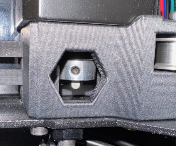

Thanks to all ! I checked about the grub screws (left and right) - there are two on either side and they were all properly tightend (enclosed the pic of both sides).

Hmm, the fact that the screws were not loose is actually disappointing. That was the hot candidate I could think of, based on the behavior visible (and audible) in the video. I'm running out of ideas, I'm afraid.
