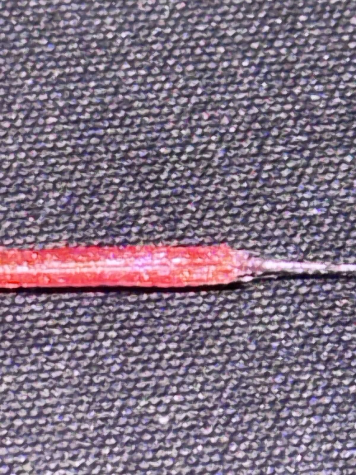

mnentwig
(@mnentwig)
For the failure mode I described, the filament will be physically stuck in the extruder and require a fair amount of force to pull out. A tube length mismatch would probably look different (filament not stuck in extruder).
For debugging, make sure the "preload filament" function works reliably (MMU cycles through all sources). This needs to run like clockwork or there is no chance a print with hundreds of tool changes will complete.

GBMaryland
(@gbmaryland)
RE: Core One / MMU3 Issues unloading filament (works fine loading it)
that’s what the filament looks like when it’s retracted from the extruder…
