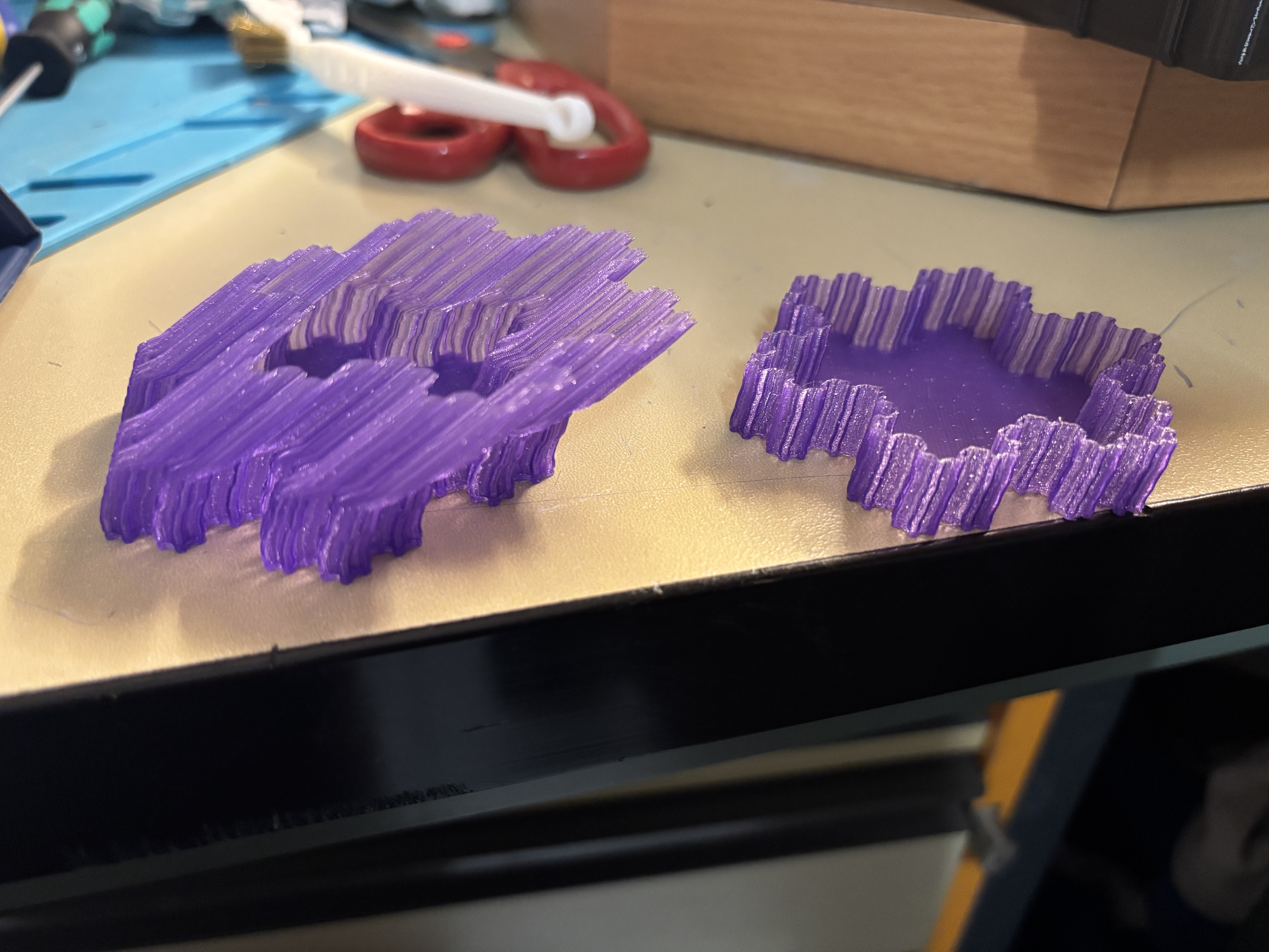

I had a continuous layershift in a vase model that should habe straight walls at the beginning at least.
i am puzzled. Did calibrate x and y again after aligning and belt tension.
any ideas ? Could this be a gcode problem.

It seems that the failed print is reproducible. Might be that all the strange geometry errors indicate a slicer or firmware problem.
Anyone having the Core one tried this model:
Extruded Fractal Flake von alecs.form | Kostenloses STL-Modell herunterladen | Printables.com

I'm seeing the same thing - shifting backwards in "Y" once the first layers are laid down.
This is quite odd, as the straight back shift means it's not just one of the motors.  To see if this was Vase mode, I printed part of a vase and it was fine.
I expect that your guess that this is a gcode problem is correct. Perhaps a math error building up over all of the repositioning being done by this model?
I'd suggest reporting this on Reddit (or to support.)

I´ve made the same experience today and sent also an eMail to Prusa Team with link to this thread, my picture, my 3MF file and the BGCODE file. Hope they found this problem.

I let finish the print, it is very strange that in the last few cm of the print it looks good (as intended by the model). I hope the Prusa guys will dig into the firmware carefully. This looks like a problem with signed vs. unsigned arrays, variables or something of its kind.

Did you try to disable the binary gcode setting in the Prusa Slicer - > Printer settings?
I don't know the exact setting right now, but there's a checkbox for binary gcode.
With normal gcode, you can open the gcode file with the Prusa gcode viewer to confirm the code is okay and still start the print over WiFi.
It'll just take a bit longer to transfer the file and start the print.
