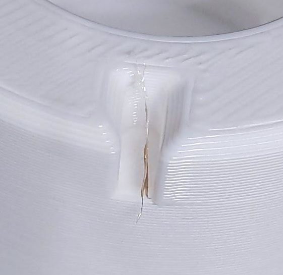

Hi all,
My week-old self-assembled Core One+ is my first 3D printer, and I've started printing PETG.  However I seem to get a few occasional wisps of what looks like brown burnt material appearing and I'm not sure what's causing it.  Has anyone seen this before?
A burnt fragment on a 3D print
It's not so bad in the above photo because it's outside the model so I can just pull it off with tweezers, however sometimes there's a large lump of it and it gets squashed into a layer so I end up with a brown bit in one of the layer lines which looks weird on an otherwise all white object.
It almost looks like it's burned and the PETG has discoloured, however I'm using the Buddy3D PETG profile in Prusaslicer which apparently contains all the correct settings for this particular filament.  I tried lowering the nozzle temperature by 10 degrees from 255 to 245 but it didn't seem to make any difference.  The filament doesn't seem to be dirty, although it did arrive with a tear in the bag (no damage to the box, so the tear happened before it was packed) so perhaps some dirt has gotten in?  I've printed about 200g of the 2kg spool so far, so you'd think any dirt or dust would be on the outer layers of the spool, which have long been used up, yet it still happens.
On a recent print I got quite a large brown piece come out, and I happened to be watching so I could remove it with tweezers before it was embedded into the next layer, but it was way more than you'd expect from the amount of plastic normally extruded (maybe 4cm long and looked like 3-4 strings tangled together, similar to the above photo's two strings).  It's almost like it was build up from somewhere but I can't see where it would be accumulating.
I have printed a few PLA models and haven't seen anything like that with PLA.  I haven't tried any other PETG spools yet, only this Buddy3D White one.
Has anyone seen this before, and knows what the cause might be?

You may need to clean your print path.  When I purchased my printer, I was advised to purchase cleaning filament as well.  Going from low temp filament to high temp filament can cause issues.  A cold pull or a higher temp purge may help you.

White filaments are often tricky to print because of the high pigment load, this can cause strange issues when the melt becomes non-newtonian.  Are you getting some stringing? Stringing can adhere to the nozzle and overcook for a while before dripping into the workpiece,
A torn bag suggests that filament drying is even more important than usual and moisture causes stringing too.
I suggest you reserve the white for non critical prints for a while and use darker colours while you learn the ropes.

I am getting a little stringing but it's not particularly significant.  I think you are right though and it is probably overcooked strings causing it.  It's just a bit strange because I'm not missing any layer lines anywhere on the printed model so I'm not sure where the 'extra' filament is coming from.
I don't think it's a print path issue because it doesn't seem to happen with other filaments, just this white PETG from the torn bag.
I bought the white PETG cheap on sale to use for non-critical prints so it's not a problem, I was just wondering what was causing it.

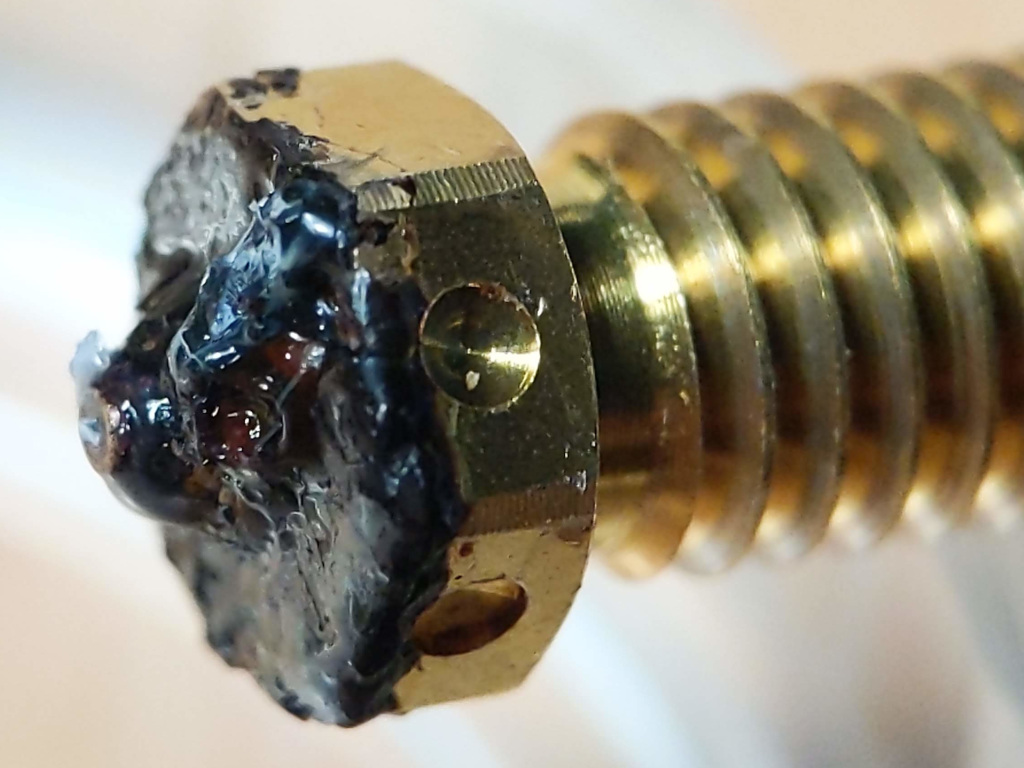

I did get some cleaning filament but I don't think it will help in this case, as the problem I have now discovered is build up on the *outside* of the nozzle.  The humidity seems to cause stringing, then some of those strings blowing around get stuck on the nozzle as it moves past in future passes, and for long prints there's enough build up that at some point the buildup gets deposited onto the print in one large lump.
I have recently printed a bunch of sample prints of all different colours and I have not had any issues with colours combining, even changing between blacks and whites, so I don't think the cleaning filament will help in this particular case as the inside of the nozzle does not appear to be blocked at all.
It seems that if I use tweezers to pull the build up off the outside of the nozzle every 15 minutes or so, then for the most part it keeps things under control.
I think the ultimate solution would be something like the silicone cover for the hotend, but one that extends all the way down to the nozzle opening to make it harder for the strings to accumulate.

I would definitely start with a silicon sock. Also choice of nozzle will determine how much buildup it collects. Some nozzles like Obxidians have a non-stick coating and some like Diamondback are naturally non-stick but expensive. One idea is to install a nozzle wiper and inject g-code to wipe the nozzle at fixed intervals.

Well as it happened I had an Obxidian nozzle I was about to use to try some abrasive filaments, so I might leave that on for a while and see if it makes a difference.
I tried printing PLA today with the Obxidian and a large chunk of the previous filament (magnetite) was stuck on the nozzle but it came off easily, so I'm undecided about that.  I'll keep printing with more normal filaments for a while and see if there's any build up.  For the first time I had some of the previous filament mixed in with the new one on the first layer in the print, but I think that was down to the previous filament having a higher temperature so it hadn't been fully pushed out by the lower temp PLA.  I can see how in that situation you might want to use the cleaning filament.  Previously it'd been mostly like for like (replacing PETG with a different PETG colour for example) so there wasn't a need for the cleaning filament as the new one just pushed all the old one out during the purge stage.
When I removed the brass nozzle it was pretty clear how much build up it had on it.  I put it back in and heated it up and the brass wire brush didn't really do much - I didn't want to damage the silicone sock though so I wasn't too vigorous, so instead I just used paper towel and got most of it off.  I put some cleaning filament through it too.  This photo is after the cleaning filament went through, but before I cleaned the surface.  No wonder the strings were so readily sticking to it.
