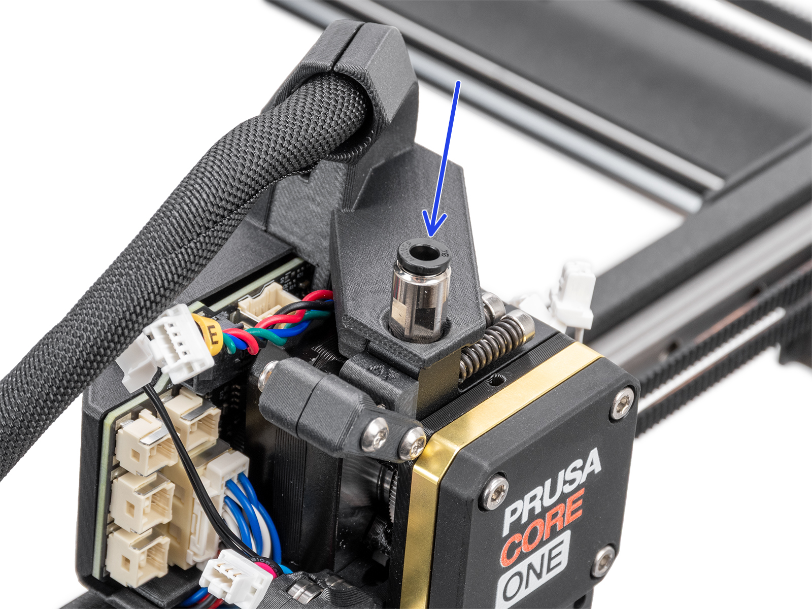

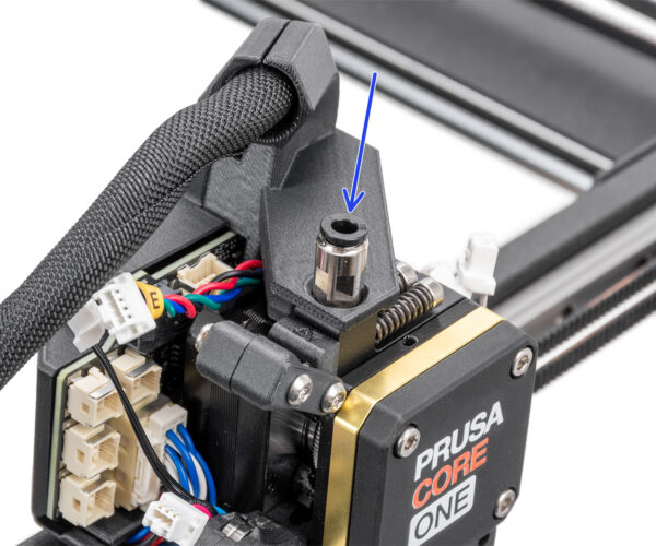

I had the same issue today. After fixing the belts and reassemble the print head, I found this cute tiny rubber O-Ring laying under my print bed.. Does any one knows if it come from the printer or if it just pop in my printer by magic ?^^
I've rewinded the whole assembly manual but I didn't find any mention of this part.

I believe that o-ring should be on the PTFE connector that gets screwed into the Nextruder. It goes on the thread side inserted into the Nextruder.

Yes! You're right! 😉
