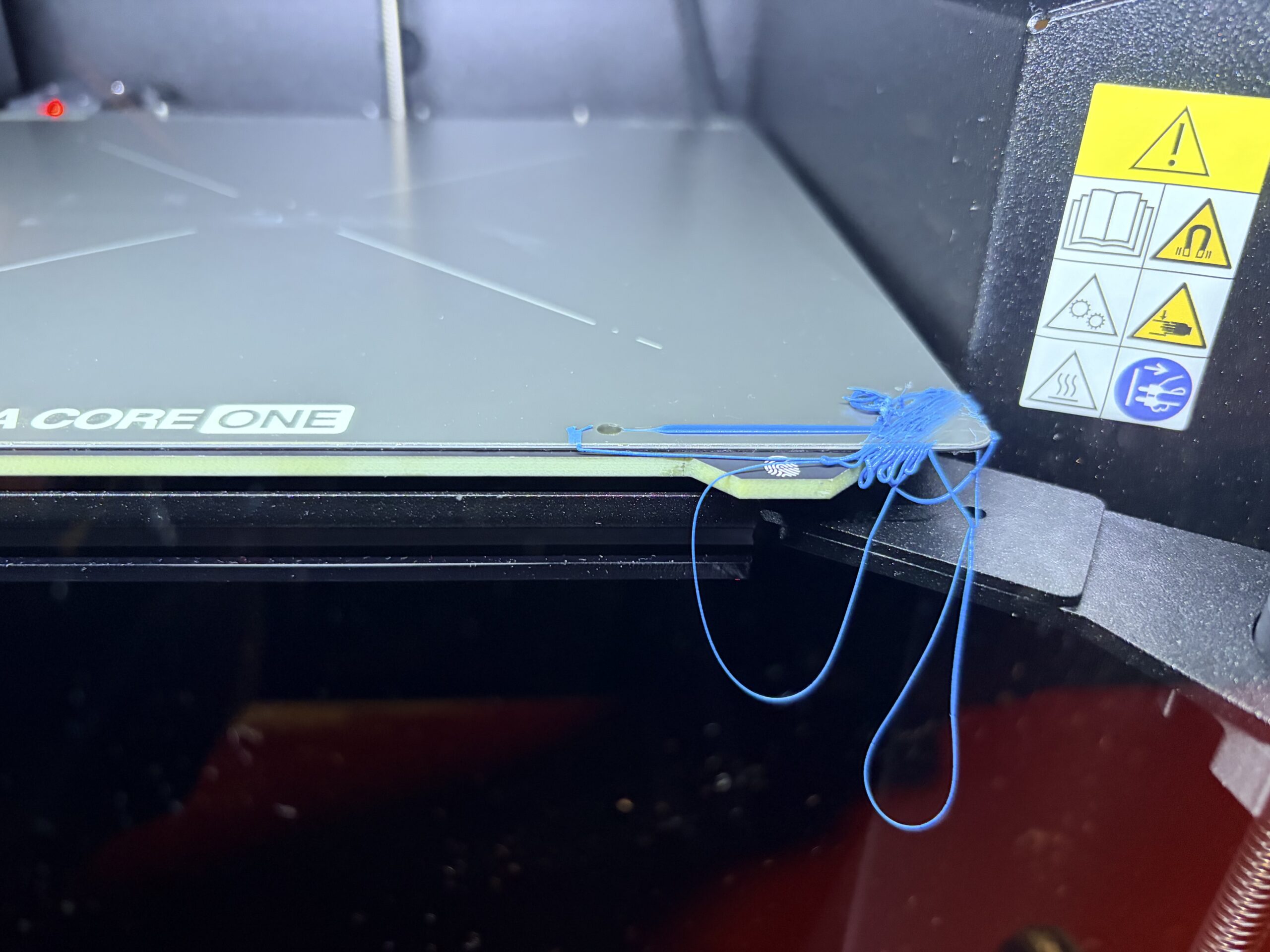

After 5th print and switching Filaments, printer suddenly prints off the print paf
First 4 prints worked perfectly.
in the middle of the 5th print, it started to print a layer about 2cm to the side.
I stopped the print. Did a successful rerun of the setup calibration.
Now on every new print it prepares fine, the nozzle test works fine.
but then instead of moving to the middle of the pad it moves pf the pad and starts printing layers in front of it. See picture.
what can I do?

Is it a pre-assembled printer or a kit? If a kit, have you possibly mounted the pulley upside-down on one of the motors? (Such that the belt runs over the smooth section instead of the toothed one.)
It's an easy error to make, especially on the Y motor, since its pulley orientation must be the opposite of the X motor.
