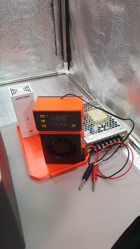

I'm now interested in using an Original Prusa enclosure for my resin printer if I could source UV light blocking panels. I've modified an Anycubic heater for inside my Prusa SL1S resin printer; it's a very tight squeeze, and I've made a heater for photographic lightbox enclosure that printer is currently in.
