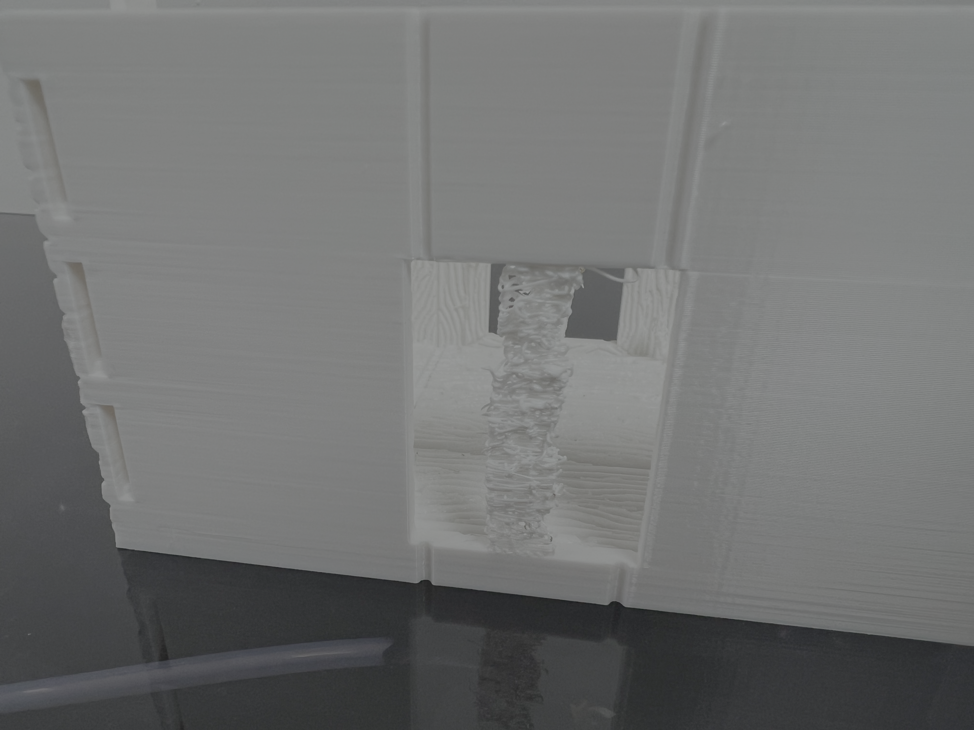

Marco
(@marco-9)
RE: Core One L - Minimal Layer Shift
UPDATE: Persistent Layer Shifts & Support Failure on Core One L (PETG)
Update on my previous issue: Unfortunately, the adjustments (Snug supports, manual nozzle cleaning in intervals) did not solve the problem. In my latest print I had one Layer Delamination for the first time and again two supports failed while all of them where showing since of poor quality.
Support Failure: Even with Snug settings, supports collapsed. As suspected, once a support failed, the nozzle started collecting "spaghetti" filament. This formed a blob on the heater block, which eventually caused a mechanical collision and a layer shift.

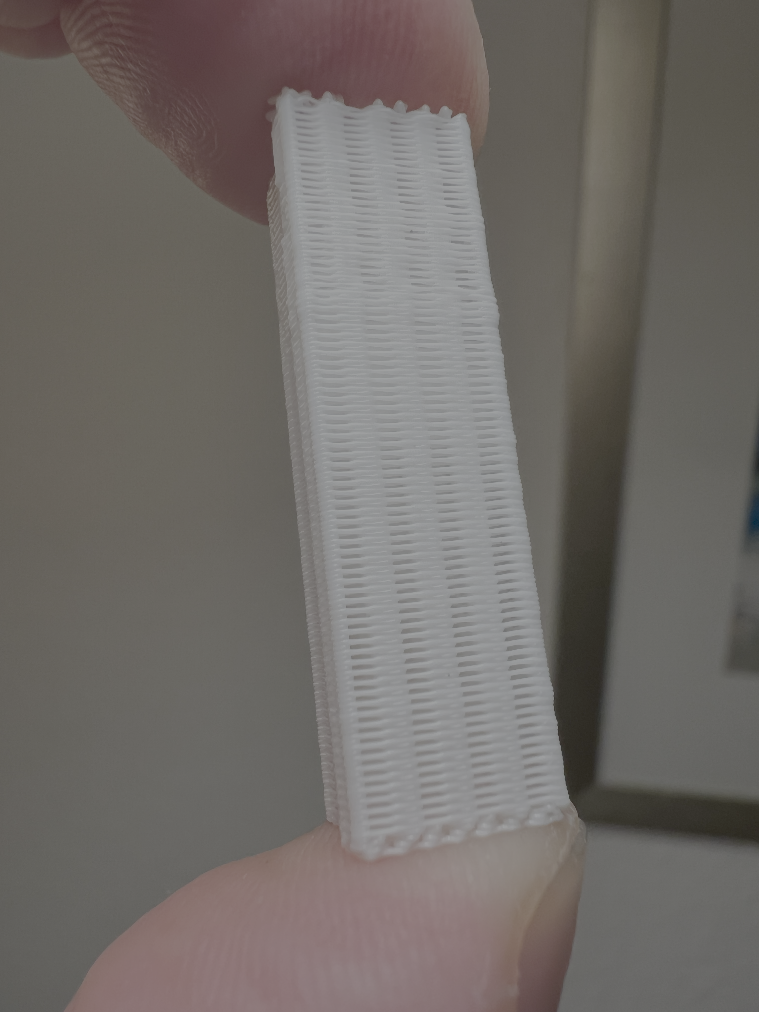

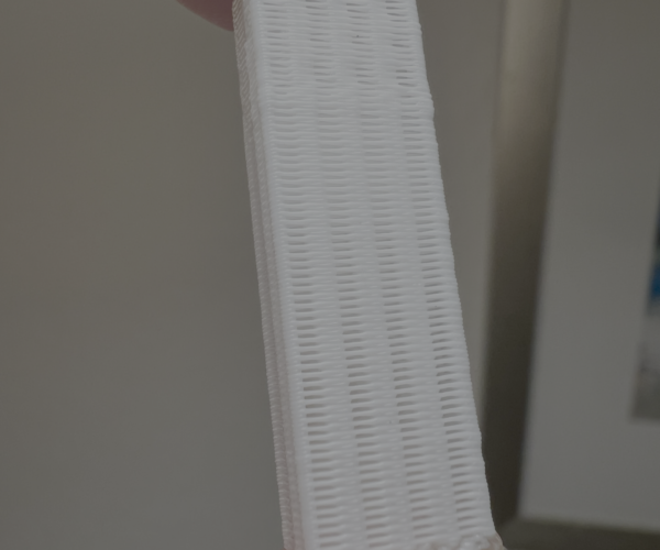

Marco
(@marco-9)
Thank you for the detailed suggestions and the settings!
I just finished the calibration cube test, and the results are interesting: The print quality is actually perfect. Even under magnification, the layers are barely visible on the inside and bottom of the cube. It seems the Core One L is mechanically very capable, but the settings for long-duration prints remain the issue.
Regarding the Extrusion Multiplier I found that minimal changes below 5% is not changing anything and when going to 10% changes its over or under extruding. I still think all the cues lead to something being wrong with the supports. While the model never gets finished the parts that actually print before and after the shifting layer / low adhesion layer are perfect. Both regarding structural integrity and optical appeal. at the same time even the supports that don't fail, just don't look like they print right.
Can you spot any indication for wrong settings on this print?

Ruebarb
(@ruebarb)
I can't tell from the pic if you got the extrusion set correctly, your calipers only will tell you that, it should avg .44/.45  Your 1st layer has issues, also the cube is warped, you don't have straight flat sides. This should be a perfectly square and even cube.  Temp and fan settings for the filament profile.

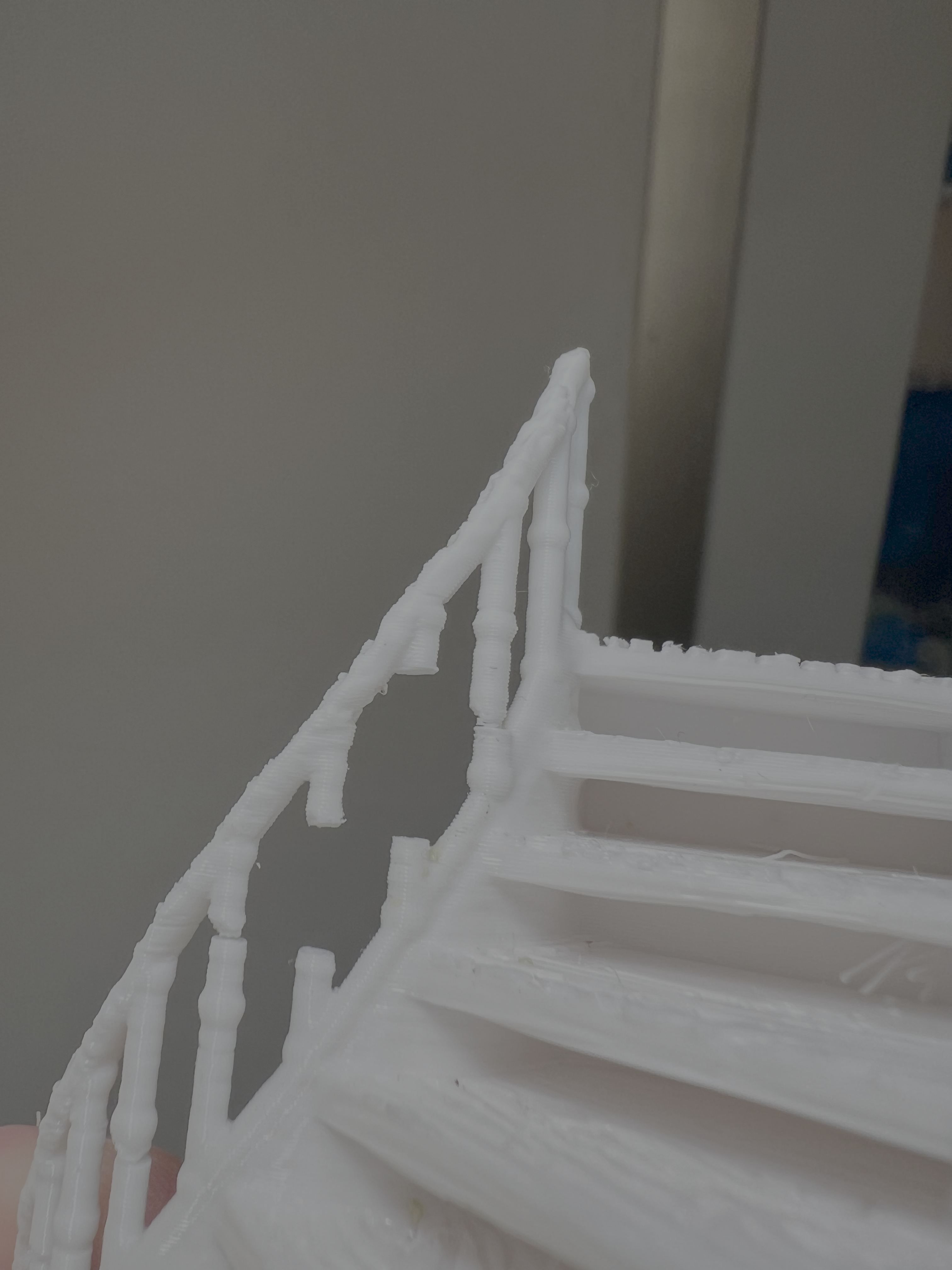

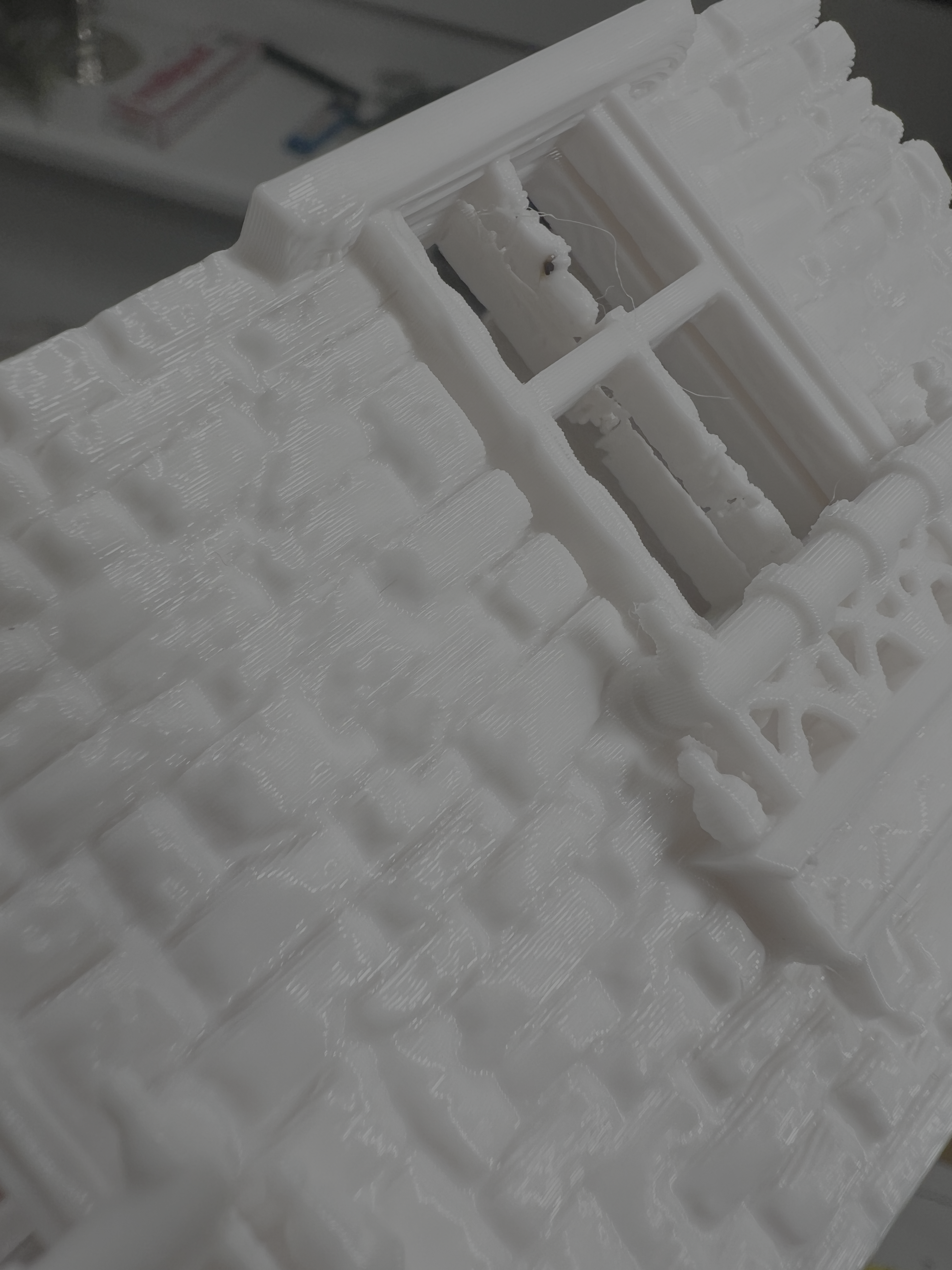

Marco
(@marco-9)
I have solved some of my issues while getting some new ones. First tweaking the nozzle temperature overall improved the prints at 0.2mm. Not going back to 0.16mm Layer hight for now. The Supports went form almost total failures to easily removable solid structures.
Now there seems to be an issue with narrow or slim structures. Like the vertical struts on this handrail. That printed well before and doesn't now. Also the struts inside the windows. I know it's possible to put a box around a specific part of the model and have it printed with different settings. im ist not sure what the problem is is here? Layer adhesion due to cooling? Printing speed? Thank for any help!
