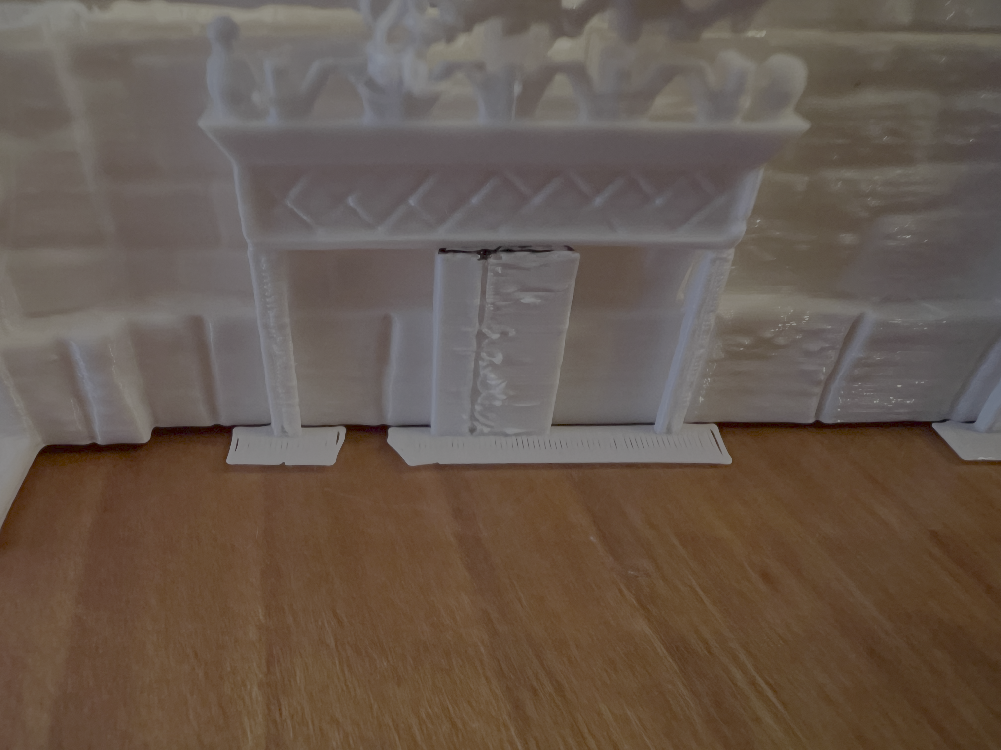

Hey,
My Prints experience very minimal Layer shifts. It's not consistent with any print profile or settings since I startet Working through a lot of options during the last Weeks with some prints coming out flawless and others having two to three of these shifts.
Any hints on next steps for troubleshooting are very appreciated.
I am experiencing 1-3 layer shifts during long 24h prints on my new Prusa Core One L. This happens in about 60% of my prints. The shift is a few millimeters and remains constant afterwards. In one instance, a support structure was hit/toppled and the Layer shift occurred afterward.
Setup & Material:
Printer: Prusa Core One L
Filament: Prusa PETG Signal White
Infill: 10% Gyroid / 15 % Gyroid
Environment: Enclosed, printer placed on a very stable base.
Steps already taken / Troubleshooting performed:
Mechanical Check: Both belts are tuned to 90 Hz
Gantry parallelism checked; X-axis is square to the frame.
Grub screws on motor pulleys are tight.
Slicer Adjustments (PrusaSlicer 2.8+):
Style: Switched from Organic to Snug and back to Organic
Support Stability: Enabled Support Brim
Z-Lift (Ramp): Increased Lift Height to 0.4 mm.
Ramp Angle: Increased Ramp Slope Angle from 1° to 5°
Avoid Crossing Perimeters: Disabled to simplify travel paths.
Firmware: Latest version installed.
Third print with layer shift on 24 hour print.
 Second print with layer shift on 24 hour print. First print with layer shift on 24 hour print.

mnentwig
(@mnentwig)
The collision with the support structure is a lead, but why?
Does the print detach from the print sheet at a corner, or otherwise warp, causing movement in Z that results in collision with the nozzle? This happens frequently at overhangs that curl up while cooling. But this should be less of an issue with PETG.
A time lapse video might give some insights.
Severe overextrusion could cause the nozzle to get stuck in the print, unlikely though.
Can you double-check that the print sheet will not slide on the bed e.g. because of debris in-between? The layer shifts I've seen from motors skipping steps were nowhere near as subtle. If the print sheet slides too easily, I could imagine some hair spray, glue stick etc. on the bottom side would help to make it more robust.

I suspect the root cause is filament accumulation on the nozzle. This starts when a support structure fails or partly fails due to the filament not connecting. The extruded PETG then sticks to the nozzle exterior or parts of the print, eventually growing into a blob that causes some stringing or debris in various quantities and sometime a mechanical collision and the subsequent layer shift. At least that's the working theory.
I will print the model with snug reinforced supports and limit them as much as possible. I will pauses to the print at certain intervals and clean the nozzle manually. Will have to add a silicone brush for automatic nozzle cleaning later if I am on the right track. might tweak some extrusion setting also but I am very happy with the print quality and wouldn't like to loose any of that just due to random blobs.
Still will keep you all updated and thank you so much for the very good ideas on where to look next. Troubleshooting alone is a struggle sometimes.

UPDATE: Persistent Layer Shifts & Support Failure on Core One L (PETG)
Update on my previous issue: Unfortunately, the adjustments (Snug supports, manual nozzle cleaning in intervals) did not solve the problem. In my latest print I had one Layer Delamination for the first time and again two supports failed while all of them where showing since of poor quality.
Support Failure: Even with Snug settings, supports collapsed. As suspected, once a support failed, the nozzle started collecting "spaghetti" filament. This formed a blob on the heater block, which eventually caused a mechanical collision and a layer shift.
It seems the default "Prusament PETG" profile on the Core One L might be pushing the material too fast or cooling it too aggressively for this specific geometry, leading to brittle supports and poor adhesion.
Updated Troubleshooting:
Belts/Gantry: Re-verified at 90 Hz, everything is square.
Nozzle: Cleaned, but PETG keeps accumulating once a part of the print fails.
Settings used: Snug supports, 10% Gyroid infill. rest standard Prusa PETG, PETG went directly into the drying box after unpacking.
Does anyone have a proven PETG Filament Profile specifically tuned for the Core One L? I am looking for settings that prioritize reliable Supports. Settings that prevent PETG from becoming brittle and snapping under the high accelerations of the Core One or any other suggestions. While it wasn't a problem before I just want to make sure the layer adhesion thing is coped with as well probably going for higher temps in the chamber and lower print head fan speeds?

Marco
(@marco-9)
RE: Core One L - Minimal Layer Shift
Thank you for the detailed suggestions and the settings!
I just finished the calibration cube test, and the results are interesting: The print quality is actually perfect. Even under magnification, the layers are barely visible on the inside and bottom of the cube. It seems the Core One L is mechanically very capable, but the settings for long-duration prints remain the issue.
Regarding the Extrusion Multiplier I found that minimal changes below 5% is not changing anything and when going to 10% changes its over or under extruding. I still think all the cues lead to something being wrong with the supports. While the model never gets finished the parts that actually print before and after the shifting layer / low adhesion layer are perfect. Both regarding structural integrity and optical appeal. at the same time even the supports that don't fail, just don't look like they print right.
Can you spot any indication for wrong settings on this print?

Ruebarb
(@ruebarb)
I can't tell from the pic if you got the extrusion set correctly, your calipers only will tell you that, it should avg .44/.45  Your 1st layer has issues, also the cube is warped, you don't have straight flat sides. This should be a perfectly square and even cube.  Temp and fan settings for the filament profile.
