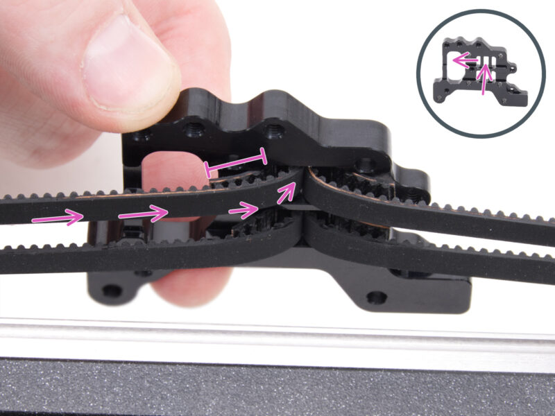

I decided to read up on another troubles they have had with the belt and getting it work with the nextruder holder. Therefore here is some of my most recent picture; at this point I have the belts though but getting 4-5 teeth though the holder for X-axis & Y-axis and getting them to stay, that is the most difficult.

I read, the more teeth the better; I gave it more teeth. Each time I give less teeth, it slips out.
Thanks for the photo it help a lot. This is way too many teeth exposed. I'm counting 10-12. You only need to pull through 4 - 5 teeth at the most.
Is that your photo, of your own printer? The belt ends are inserted wrong! The ends must not stick out freely. They must be looped back through the guides, such that they are pressed against the incoming belts, teeth against teeth.
Please examine this picture from the assembly instructions. Examine it closely, look at it with an open mind, compare with your own installation. Hopefully you can see the difference and correct your belt attachment. Then the regular 4..5 clamped teeth will secure the belts with no chance of slipping out.

Unfortunately I misinterpreted your photo which is why I deleted the post was going to rewrite with the correct information. I'm assuming you are tucking the exposed ends of the belt back into the harness? It is supposed to look like this:
Posted : 01/12/2025 11:30 pm
To clarify, my above photo shows the back view of the Nextruder mounting plate, before it is attached to the gantry. It is from this step of the assembly instructions:
https://help.prusa3d.com/guide/5-corexy-assembly_835522#864874
After attachment to the gantry, it must look like this;
https://help.prusa3d.com/guide/5-corexy-assembly_835522#864970
You can only insert the belts properly when you detach the plate from the gantry. After you screw it back onto the gantry, the belts will be clamped tightly.
Posted : 01/12/2025 11:31 pm
When you push the belt through the harness you have to loop it back around like this:
This is why your belts are coming loose. You didn't secure them in the harness correctly.
Posted : 01/12/2025 11:32 pm

OK, got it. But before you attach the nextruder please take some images of the belt carriage. The belts should not be slipping out if they are correctly routed. Start by unscrewing the belt harness from the linear rail then loop the belts back into the harness. Take a photo of the back of the harness before you attach it the linear rail. Only 4 or 5 teeth should be sticking out. Next take an photo of it after you have reattached it to the linear rail.

It doesn’t work like that. Please pay attention to the photos I sent. The belts have to be looped back into the harness
