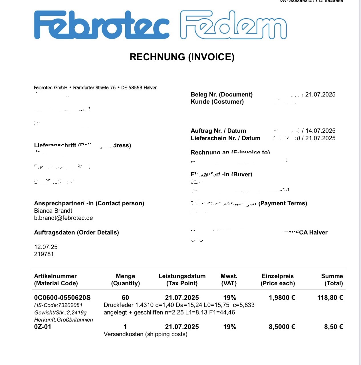

I was planning to make a few videos and add some pictures anyway.
Here are the feathers I used:
Posted : 22/05/2026 5:40 pm

Hello Jan
And thank you for the info. So you put a spring which sits around the stand of the tile and you adjust the height with the bed screws. Depending of the springs hardness, the tiles will be able to slide on the Z axis. I also tried to tighten the the bed screws but as I found this is not adjusting the height of the tile.  I had a discussion with Prusa support and they said that bed leveling should be able to manage a difference of 1mm but I did not measured it by now. However, when making tests w Prusa support connected I noticed a small plastic dirt on the nozzle. I cleaned that up and at the next run the bed leveling was successful which kind of confused me. Prusa support sait that this is normal but I not understand why. Apparently this is the bare minimum to have a sucessful bed leveling.
I attached a picture showing the bottom of a tile that I have. I am looking forward to see the picture with the mounted tile 😀 .

Hello Daniel,
No problem, I'm happy to help.
That's right—the spring, as shown at the top of the invoice, goes between the bottom of the heating plate and the aluminum support.
You can tighten the screws as much as you like without the springs, but that won't make the heating plates any flatter.
Support is right when they say that bed leveling can compensate for the unevenness. You can feel it very clearly when you touch the two Z-axis spindles with your fingers while the printer is printing diagonal lines.
This isn’t a big deal for small prints. But with large prints, you can tell that the print was made on a curved surface—the so-called “print banana.”
Before adjusting the 16 tiles with the 64 screws, it’s important to check whether the aluminum frame is straight at the four mounting points.
