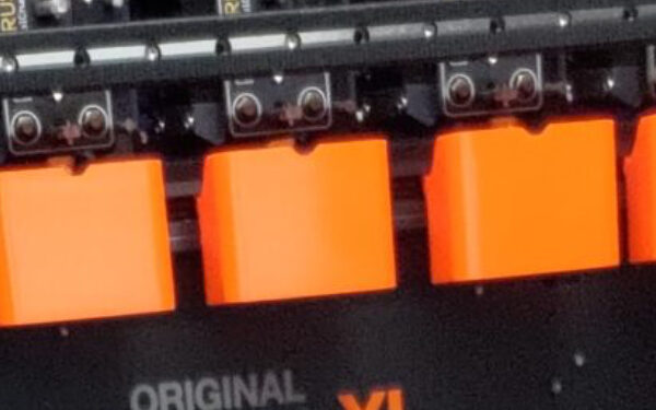

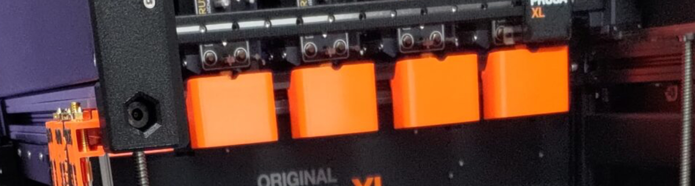

Very cool! I’m wondering what the orange parts below each parked nextruder are?

Hi, they are these, for collecting the rubbish that the brushes brushes off:
https://www.printables.com/model/644228-debris-bucket-for-prusa-xl-nozzle-brush-auffangbeh
