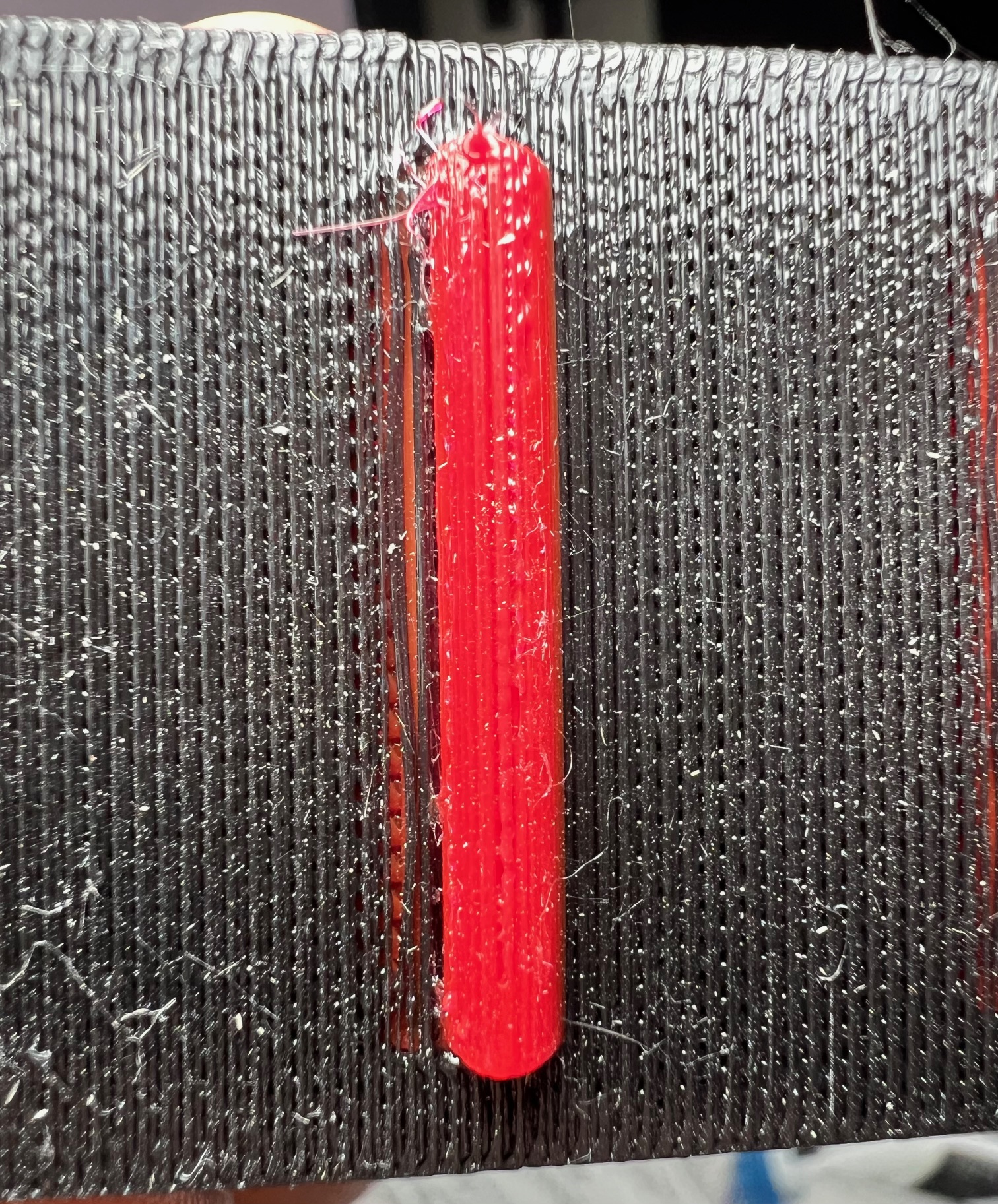

Well, after 10 stupid little cubes and couple more cancelled stupid little cubes I think I have something decent to live with.   The following are feeding the filament directly into the extruder and with filament sensors off since I still could not get the sensor on the tool head to detect the filament.  Quite honestly I did not see much of a difference when I stopped feeding through the PTFE in one test where that was the only change.  I kept feeding it this way though because of the major PITA it is to feed through it.
One thing I realized was the filament is way out of spec.  It is genuine NinjaTek NinjaFlex so I was surprised, especially since I had no issues with this same spool on the MK3.  Ii measures an average of ~1.66mm, but honestly it is all over the place but no where did I find 1.75mm.  With that set things immediately got a bit better.  I now wonder if this stuff has some sort of half life or something since it a few years old 🤣
I was able to get rid of the zip line by setting 'Retraction when tool is disabled' to 10mm.  Yay!
I'm going to run a Benchy with it tomorrow after it sits in the dryer again over night  If that is successful, or reasonably so, I'll probably post the settings and a 3MF over in Printables.  If not, and if anyone is interested, I'll attach it here.
How's this for a spool holder!
The circles are where detractions are happening. and leaving a gap  I increased the retraction which got rid of the blobs when it does the goofy circular retraction moves, which BTW completely ignore 'Avoid Crossing Perimeters'.  The only way I could find to get rid of them is by setting retractions to zero, which led to other issues.  Anyway, this caused gaps where it detracted so I added some 'Detraction extra length' which solved that, just need a little more.
This last test was done with lightning infill just to cause more restractions.  It certainly wasn't the best looking infill but it did do it's job.  the lack of infill is why the walls look a bit wonky.  When using grid infill this was not an issue.
Certainly an improvement over what I was getting previously.

RE: TPU (Ninjatek Ninjaflex specifically) on the XL
NinjaTek NinjaFlex PrusaSlicer Printer Profile for the Prusa XL
Not perfect but certainly better I think.
This pic a few minutes after it finished, still attached to the bed.   Look Ma, no zip line!
Looks like a small blob attached at the end of the rod holder, probably released from the mess that builds up on the nozzle when it moves from the purge line to the print area.  I have no idea how to prevent this aside from modifying the start gcode, but I do not want to have to remember to select a different printer profile when there is TPU loaded.  This and the cube tests are the first time the XL has seen TPU, and it is the only time I have ever had this happen.  It happened on every test cube too and the reason this print was moved nearer the purge line end.  Pressure build up in the nozzle is all I can think of as the cause.
Some reasonably light stringing which IMO is acceptable with this filament.  I was not watching when the chimney was printing so I have no idea how it got that odd, whatever it is.  Guessing it was wobbling as the nozzle circled around it.
Looks like the bow is a little oddly shaped too.  There was some curling there as it printed so possible some more cooling would help.  Same for the bridging, not bad but probably better with some more cooling.
