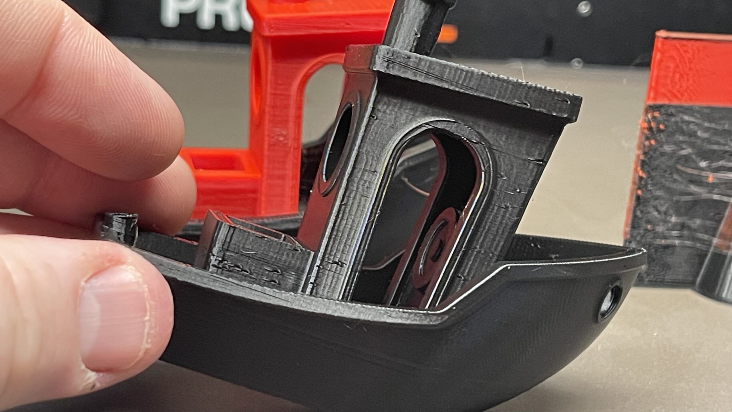

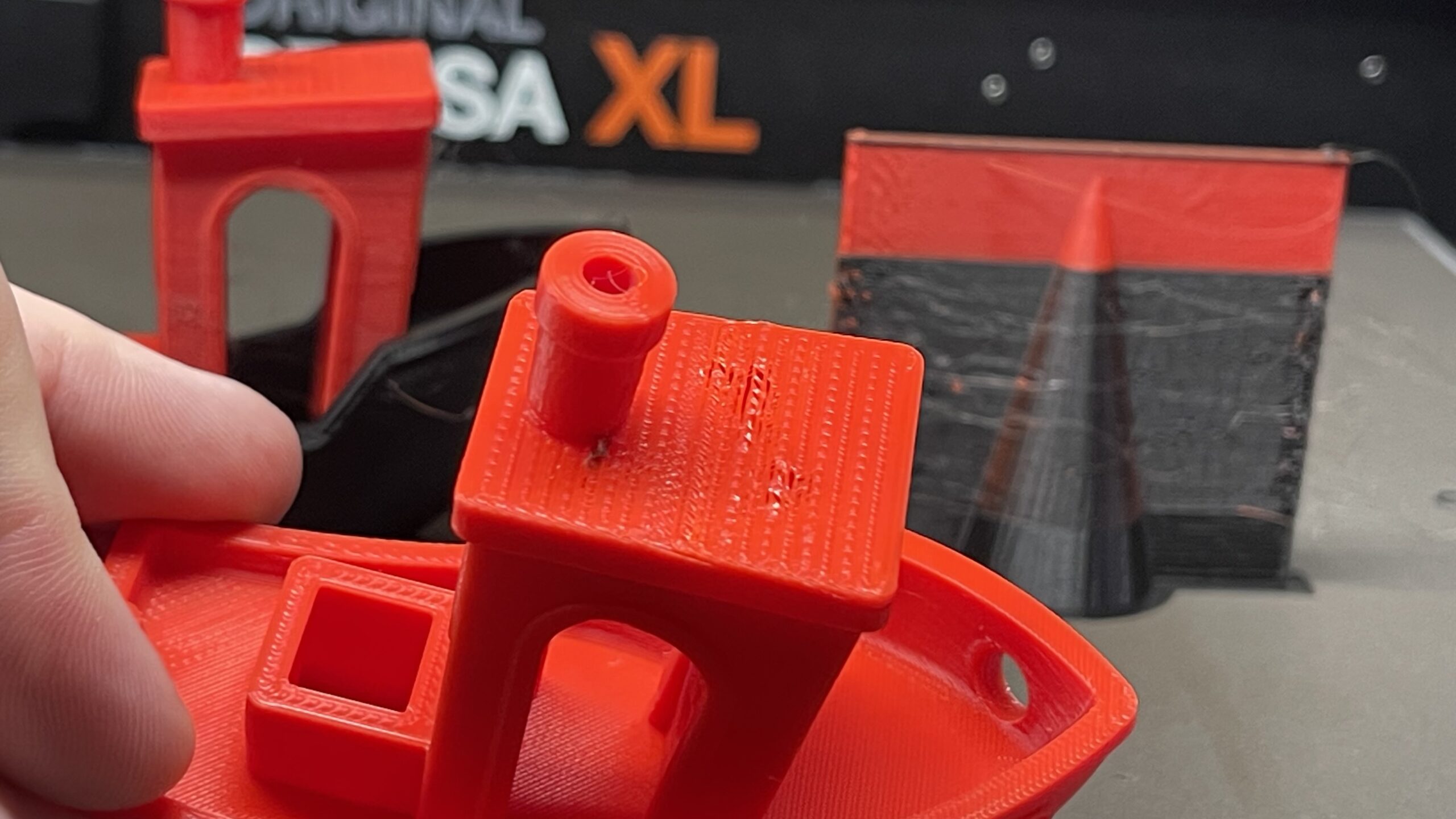

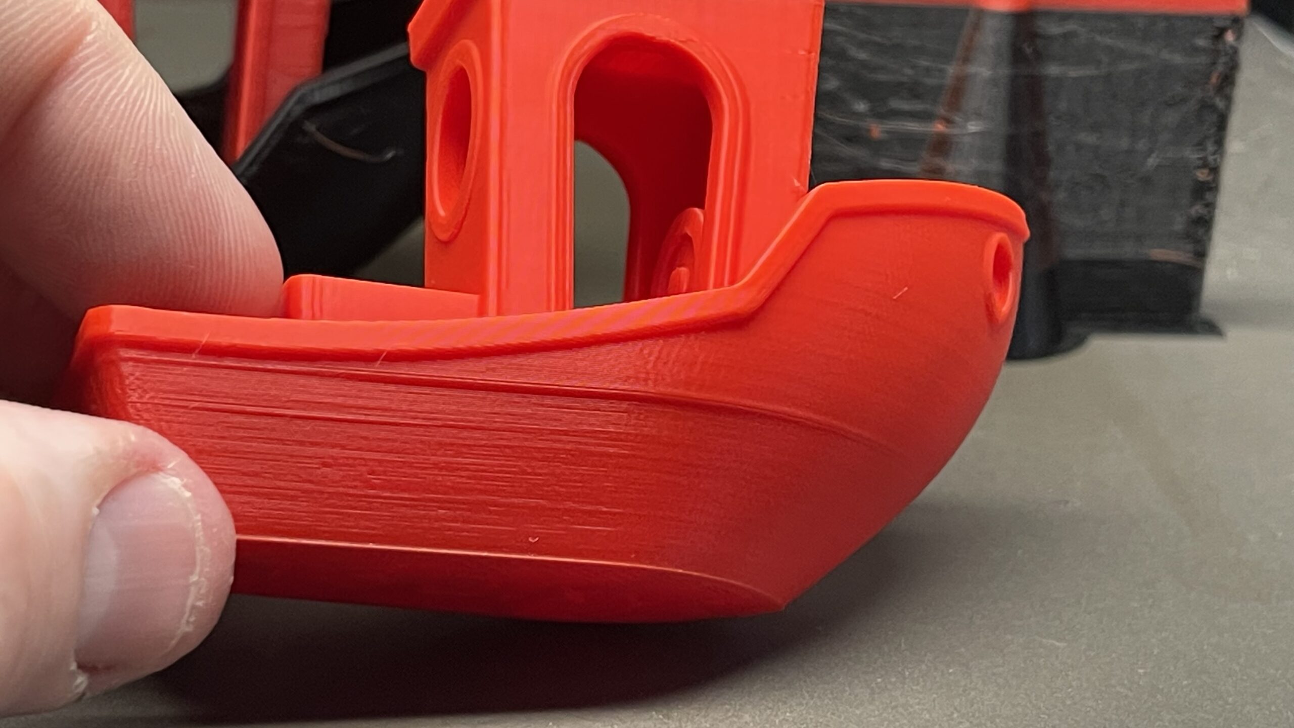

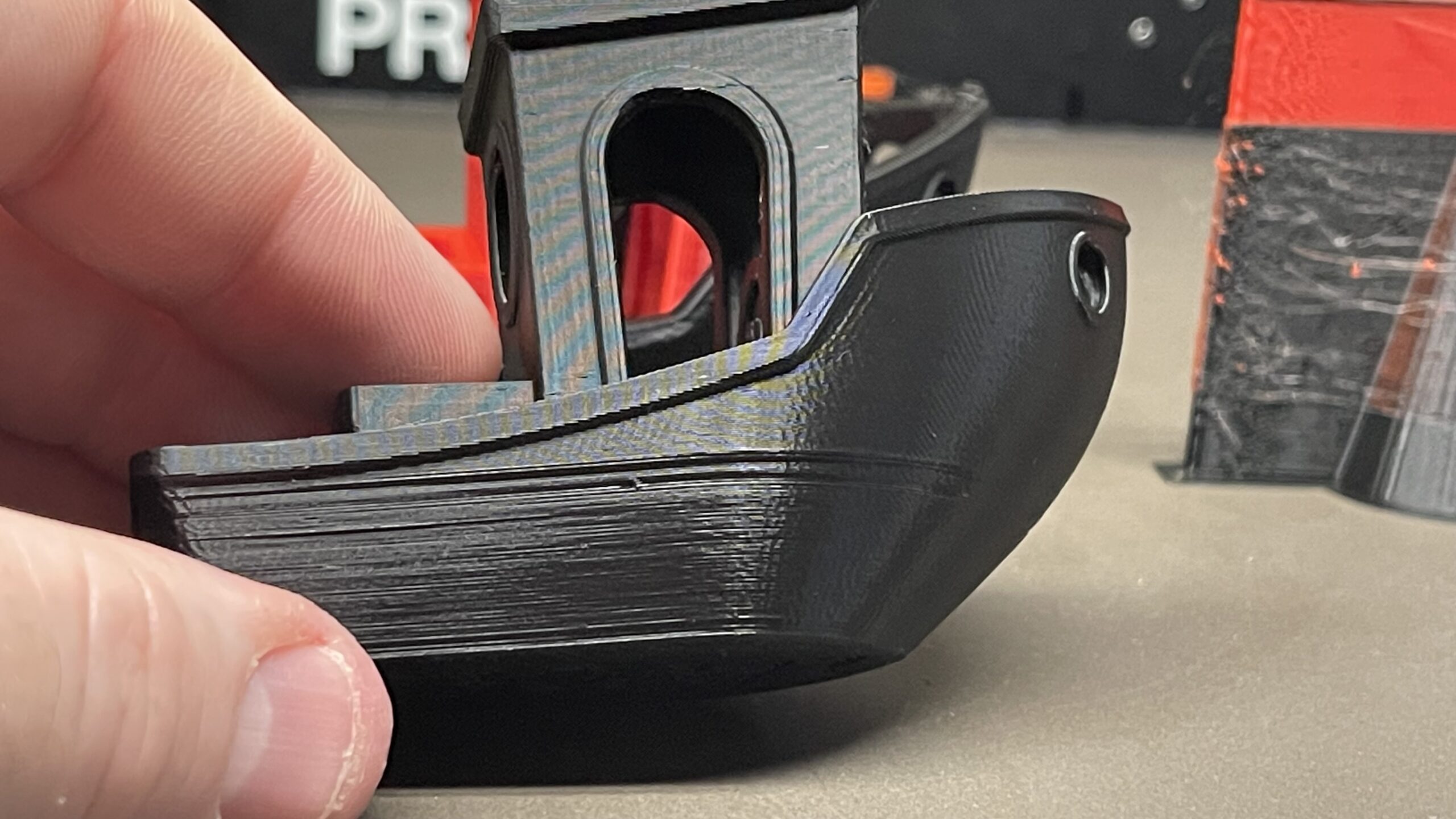

Well I tested that theory out as well . I did a typical benchy . extruder A then B then both as a color option . Both had huge layer pronounced ( benchy normally rough on this line but was super rough and pronounced )
on this ) and also layer extrusion blister gaps on all 3 . scattered along and on top .

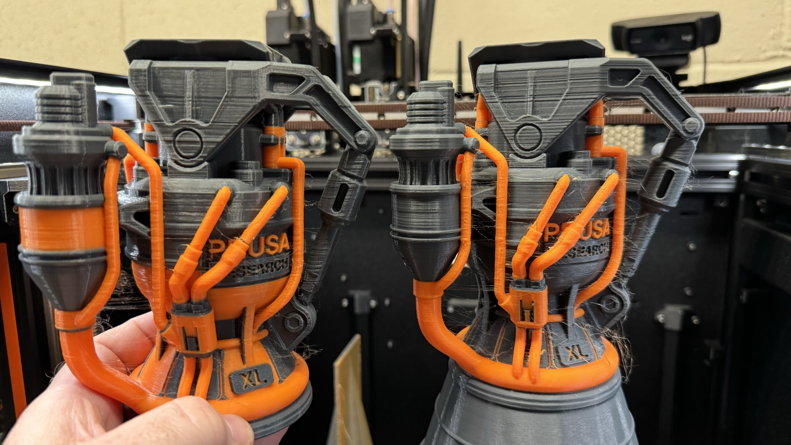

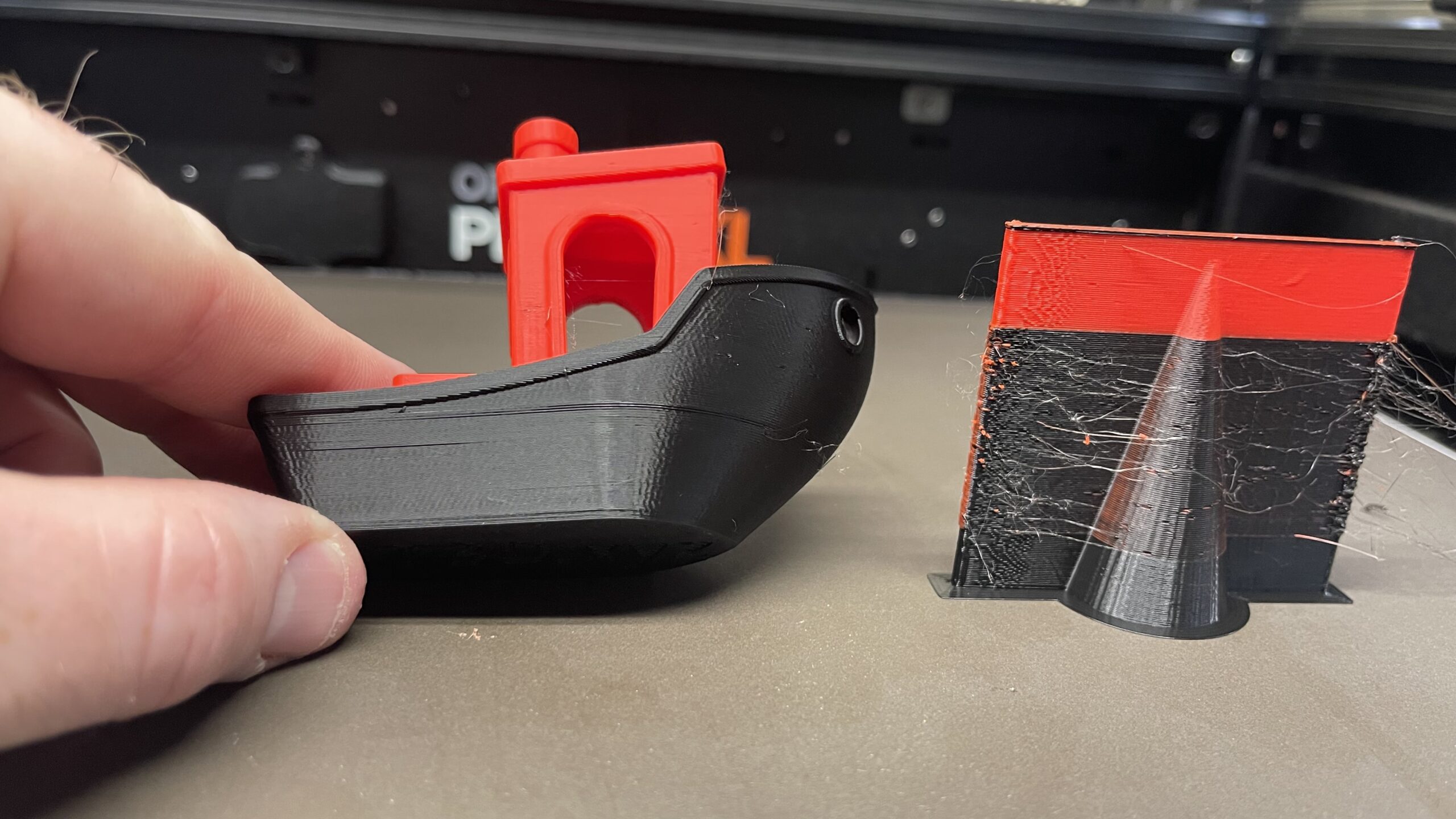

Well I used a method from a YouTube video that is out there to add a G code to the filament settings, which retracts the filament and moves the head to the back of the build plate for a second before docking.This pretty much alleviates the stringing ( also dropped my temperatures to 190 ) but did nothing in the way of fixing or helping the sheer garbage, poor layer, lines, and inconsistencies. The photo on the left is of the piece I did with the updated G code settings and the 190 temperature. The object on the right was the one done straight off the USB Gcode code provided by Prusa. This machine has hard evidence of extrusion issues, probably related to pressure, advance or linear advance with configurations of the new design extruder. if I do a single tool head print, print quality seems great with the G code and temperature settings soon as I try a multitool absolute garbage extrusion layers. The lower section that prints with just the one extruder and doesnt bounce between tool heads printed flawless .
Posted : 20/10/2023 12:02 am

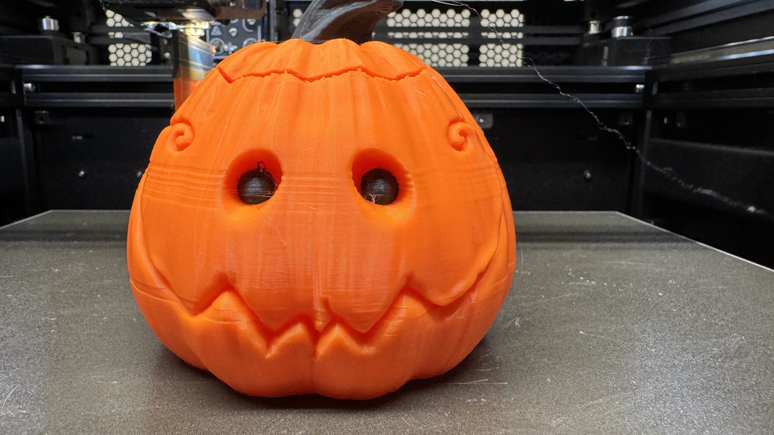

We’ll update installed the newest Alpha firmware and the majority of print quality issues are vastly improved . Still major issue with tool alignment while switching colors . Any idea on how to adjust that ? I can’t find anything in settings calibrations or dev notes on it all . it seems like the primary tool head shifts to the right during multi tool usage
Posted : 21/10/2023 1:15 pm

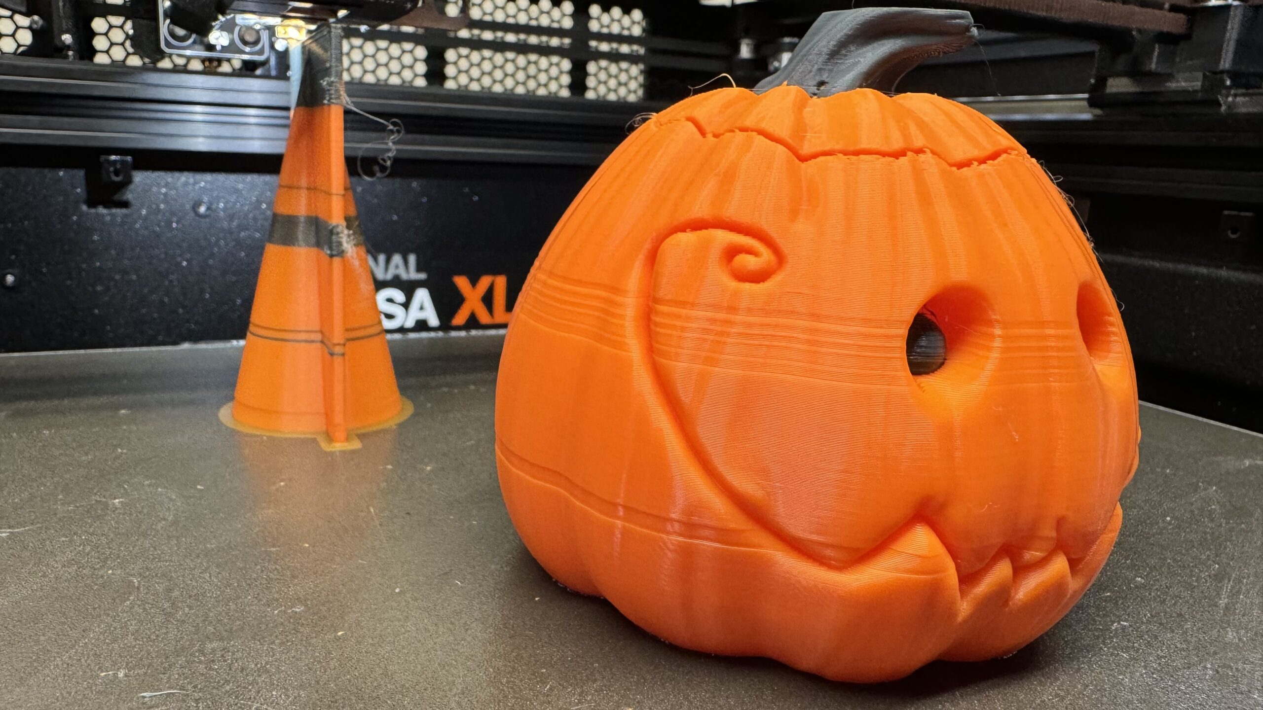

Sadly i am here to report , that manual calibration did nothing to help . The factory offset for X was set from the machine at 0.062759 i had followed the guide and started making adjustments in increments of 0.05 and had gone all the up to 0.342759 and it had not any significant correction to the misalignment of the 2 tool heads . It is constantly layer shifting on multi color lines .
I know there was alot of suggestions to me to check the belts . I had hesitation because the machines prints good with either tool 1 or 2 separately with single color so i cant see it being belts but i went down that rabbit hole anyway . So i followed  https://help.prusa3d.com/article/adjusting-belt-tension-xl_401793 and first the Prusa belt tuner couldnt even pick up teh strumming of the belts on not just the XL but i couldnt get it to pick up the sounds of any of the other Prusa machines in the farm , so that went out the window . I proceeded to follow the guide and move the rail forward there was no play at all it was all nice and tight. So i then tried their supplied GCODE to print a belt tension tower.................yea here s how that went
I tried the Firmware update to the new ALPHA release and although overall printed aesthetics seem more clean the layering shifts have not changed , even the ALPHA benchy showed the layering shifts with color swapping
Right now on hold waiting on chat for the last 40 minutes to update my case with them for some kind of resolution .
Posted : 23/10/2023 12:56 am

blauzahn
(@blauzahn)
RE: Poor Prints XL multi tool.
@DarkTeck. I can imagine your frustration.
As @GuyH noted, picking up may be one potential culprit. Another post mentioned a loose dock fixing bolt (see. dock-fixing-bolt-becoming-loose). Or loose grub screws at a pulley. The shifts in your pumpkins kind of toggle their positions, that is: they sort of recover back and forth. To me, this does not look like a crash induced by an extrusion problem. /speculation on/ I can imagine that the belt system/extruder gets an impulse during docking/undocking. /speculation off/ Are the locking sliders in the extruders bump into end stops? During single head printing this does not occur, right? Have you checked whether the mechanics all around the belts are properly fixed, starting with the grub screws? Can you describe the shift directions (x, y, diagonal, random)? Pinning this down at printers like the MK3S with linear independent axes, is a piece of cake unlike at a core-xy like the XL or a Voron (see forum.vorondesign.com). Typical trade-off: no bed pushing largish parts around anymore but harder to grasp system.
The extruder is obviously also involved in positioning the nozzle. Everything nice and tight there? Not shifting at slight kicks? Not only at room temperature but also at printing temperature?
At the end of the day, the filament has to land at the right spot on the pumpkin. If the uper half from chassis to nozzle is ruled out, the position of the pumpkin relative to the chassis/nozzle must not shift as well. Less likely but who knows?
Please, can you be a bit more specific and recall what you did check together with the prusa people? Did you ideally make notes, despite aproaching boiling temperature? I am just curious but also try to help if I can.
