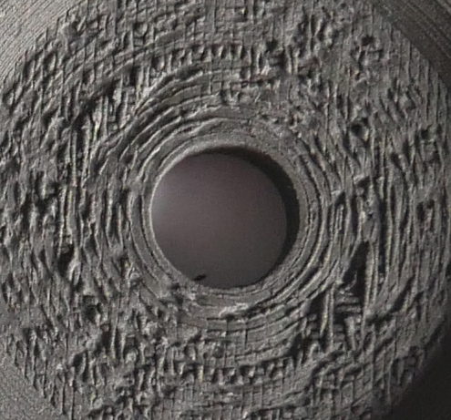

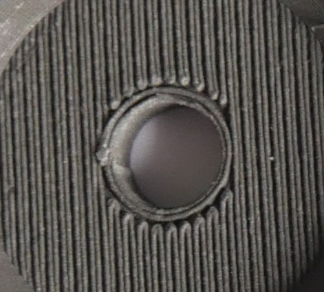

So I bought some BVOH and made some tests. I was able to print with it but I found the surface aspect after removal of the supports kind of odd.
supports1support2
Same model - left had supports printed with the same material (PLA), right had BVOH supports (most of which were removed manually). Is that the expected aspect with BVOH supports or am I doing something wrong?
Settings were those of "0.20mm SOLUBLE FULL" profile copied to "0.10mm FAST DETAIL" (z-distance=0mm, lowered speeds), filament profile "Fiberlogy BVOH" (the BVOH brand I have). The BVOH roll was dried at 45°C and printed from the dryer.
