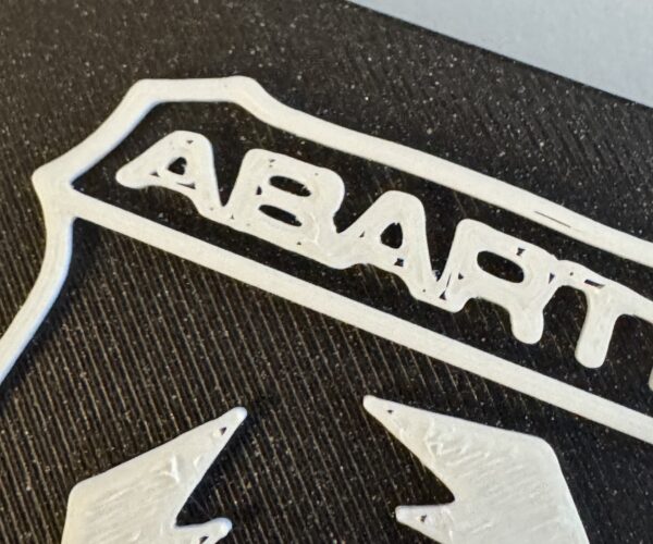

Hello everyone,
I’m running into an issue while trying to print a small, detailed emblem on a flat surface.As you can see in the attached image, there are gaps in the print — and I can’t figure out which setting is causing them. The perimeter generator seems to have an influence: Classic creates different gaps than Arachne.
On top of that, I’m also noticing a strange effect along the border of the object (see third image).
Does anyone know what might be causing this issues? Any advice would be greatly appreciated
I'm using the "0.20mm SPEED" profile, and already tried to alter the "minimum feature with" and "minimal perimeter with" setting

Unfortunately  you have not attached a copy of the Prusa Slicer, Project file for us to experiment with
Click the File drop down menu,
Choose 'Save Project As' option,
Save the project file as a recognisable name, this should result in a .3mf file of that name.
ZIP Compress the project file, and then attach the ZIP file, to your next post
In the mean time.
the text looks quite small which can give difficulties with infill,
Try setting the first layer to one perimeter to change the infill style
I Suspect that you are using Arachne perimeter generator, try Classic Perimeter generator
you could also try setting the first layer extrusion width to a smaller number to allow more traces within the infill area
similarly you could try reducing the  first layer External Perimeter extrusion width, again, to allow more space for the infill
Please note! some of these parameters need Prusa slicer to be in 'Expert Mode'
the rest can be changes in 'Normal Mode'
For simplicity sake, just enable 'Expert Mode'   then all parameters will be visible

RE: Gaps in small emblem
Extrusion Multiplier in the filaments settings is another solution. Increase from the default 1.0 to 1.1 or higher to lay down more plastic over all. It can solve many single layer infill issues, especially inlays.
The edges of a print will always have some artifacts related to the extruder speeding up and slowing down. I think that is what you are seeing in that third photo.
As Joan recommended, Ironing the top surfaces can help the finish of the flat surfaces, and may hide the edge issue you see.  Whether ironing will help the very top surface of the white detail, or mess it up more : stringing and smearing of the small details may depend on filaments in use... try it. Post an image of the result, I'm curious how it will work.

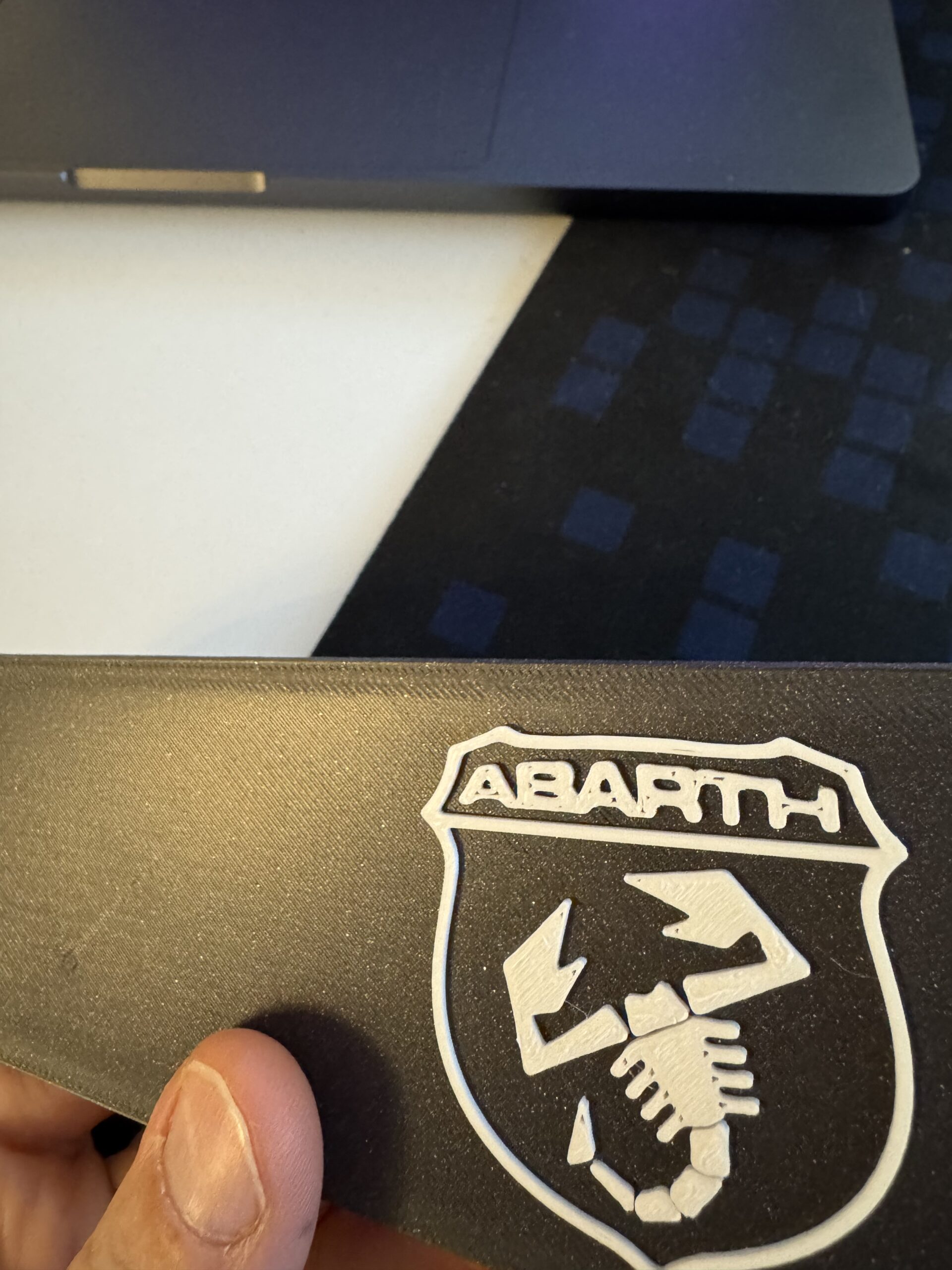

Michael Plumbohm
(@michael-plumbohm)
First of all, I'd like to thank you all for your responses. I've tried a lot of settings regarding ironing and external perimeter extrusion width and top solid infill extrusion width.
Ironing, indeed makes the black surface look very good - but messes up the white. Photo is attached.
Now - it would be nice if I could set ironing only on the black surface. But can't find how to set it up 🙁
You can set a modifier slab so that only the black surface is ironed ...
