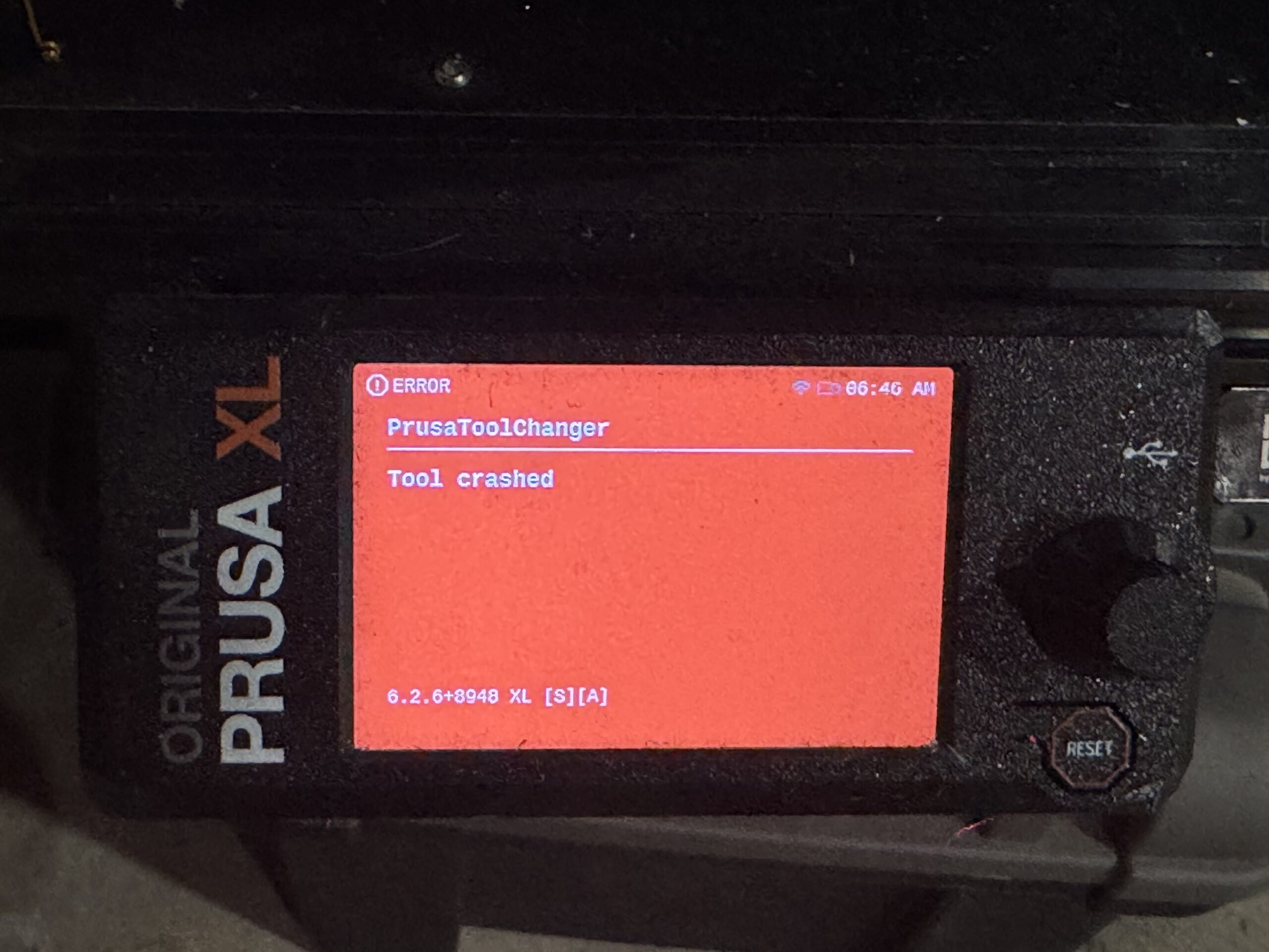

For the last few months i have been unable to use tool heads 2 & 3. Every time i even try to pick those tools i get a red screen that says “tool crashed” and i have no idea how to fix it. I have the most recent firmware update and the problem persists. Any ideas?

Did you re-run the dock calibration from the Calibration & Tests menu?
Here's how to do it: https://help.prusa3d.com/guide/4-first-run_482742#482884

Thank you so much! I was running out of hair to pull out.
I’m not the original owner of the printer and didn’t know how to find or do the dock calibrations. Thanks a million!
