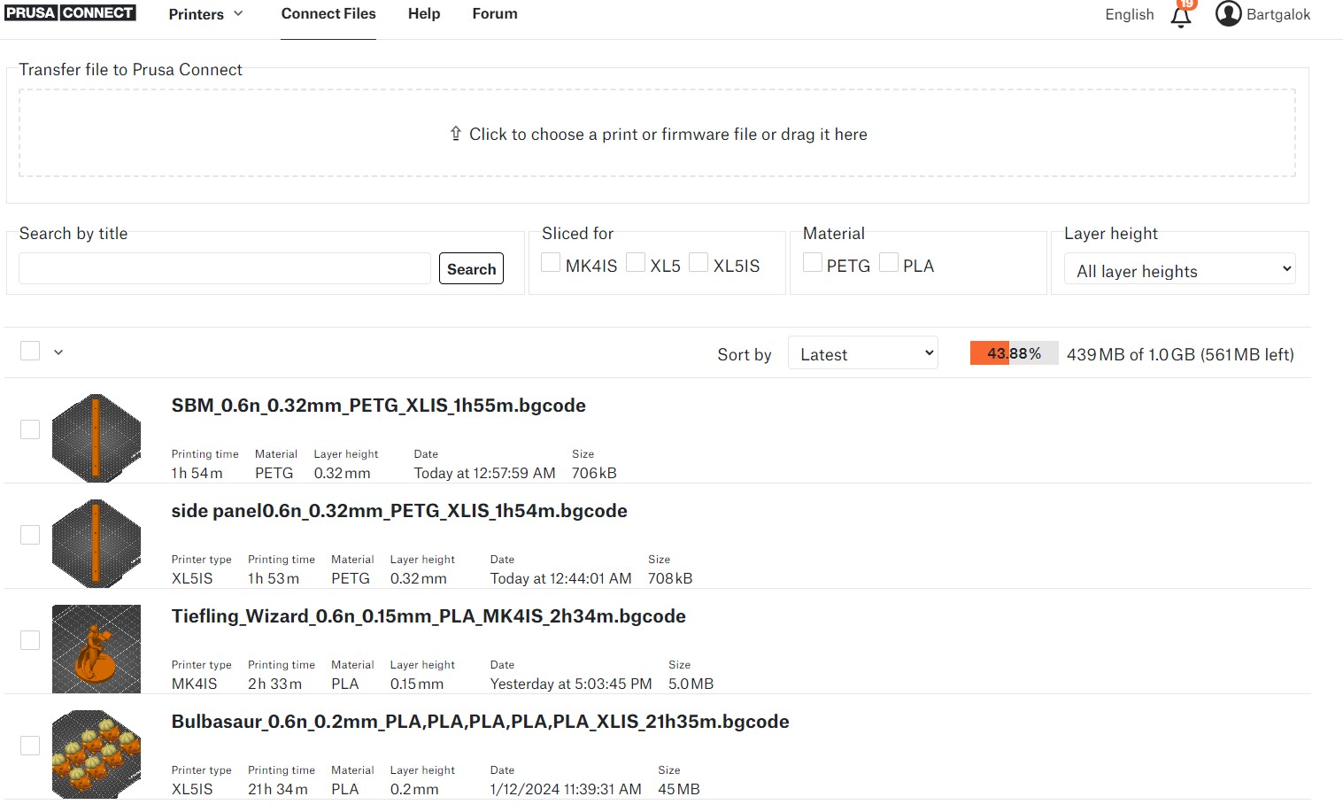

If I try to upload directory from PrusaSlicer or upload a .bgcode file to Prusa Connect I get the error "Storage capacity exceeded".  I've tried cycling the power on the printer, different USB drives, formatting the USB drives but nothing changes this.   I can see the printer fine on both the PrusaLink and Prusa Connect pages on the browser and both show the expected data.  Uploading to PrusaLink works but I prefer the Prusa Connect from PrusaSlicer way as the print starts a bit quicker I feel.
Any thoughts about what I need to do to get this working again?
Thanks
Best Answer by FoxRun3D:
Well... did you actually *exceed" the storage capacity on PrusaConnect? It's limited. You can open the PrusaConnect webpage and check it.

I deleted all the files that I could see there, nothing in Connect, nothing on the USB, just fails every time now
Posted : 08/02/2024 5:47 pm
Bartgalok
(@bartgalok)

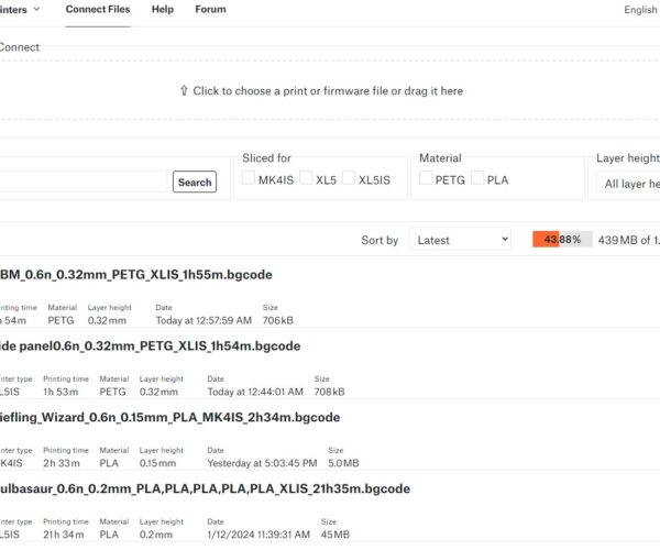

I had this issue too. I went to the " Connect Files" tab at the top of the Prusa Connect page. You should see a list of files and the storage capacity at the top right. You can select some files on the left hand side, or all, if you wish and deleted them from the server. That should allow you to upload your files.

Ah, well, tinkering today I went to the top of the screen and found "Connect Files" and they are different from "Printer Files" it seems. Deleting all the "Connect Files" seems to have resolved the issue so it appears that you were correct and I just wasn't astute enough to grasp the answer 😉

That took me awhile.  This data is shown under the "Connect Files" tab on the https://connect.prusa3d.com webpage .  From there you can select all the files ( square box at the top left of the listing ) and a trashcan icon will appear which allows you to delete all of the stored files.  That is nice if you know about it ( I'm sure it is documented somewhere ).
My suggestion is that some folks ( like me ) clicked on my icon in the upper right corner and the "Storage quota" is clearly shown right there.  And when you mouse over that quota section is appears "clickable" but clicking on it does nothing.  When you click on the "Storage quota" it should take you to the "Connect Files" page ( and hovering over the clickable quota section should show that action ).

Along the VERY TOP of the connect.prusa3d.com webpage starting on the left it says:
    PRUSA CONNECT       Printers        CONNECT FILES       Help     Forum
Click on "CONNECT FILES" that's where the files are that are filling up the space on your Prusa Connect account.

Thanks! This did the trick. Not intuitive in the least given that you'd think you could delete the aforementioned files from each respective machines Print Queue. Thank you again and for the screenshot too.

It's weird, or at least not very intuitive.  If you click on "Connect Files" and immediately click on "checkbox" in the upper left ( you know, the one that has no description by it 🙁 ) it will check all the files currently displayed and it will now display a "Remove selected" description/box next to the upper left "checkbox".  Here is the "weird" bit, at this point if you simply click on the "Remove selected" box it will delete those files that were displayed.  It initially only displays 20 files.  However, if you scroll down to the bottom of the displayed list it continues to display files until you finally have them all displayed.  If you now go back to the top you can click on the "checkbox" and it will mark all the files displayed and now click on "Remove selected" and it remove them all.
