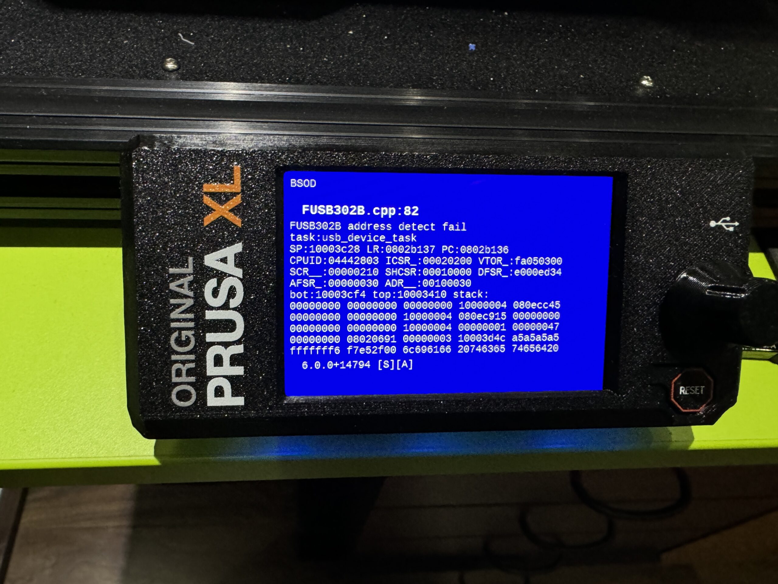

New FW 6.0.0 - printer freeze
after first attempt to load latest firmware the priter freezes to blue screen according pics.
after downgrade, I tried to upgrade second time and after the printer reboots it is looking for bbf file on the key and freezes in the loop 😂😂😂

RE: New FW 6.0.0 - printer freeze
I just encountered the same exact issue while trying to update the firmware and I have no idea how to fix it or how to downgrade the firmware.
I figured it out. Downgrading the firmware is the same process as upgrading. Both the downgrade and second attempt at upgrading to 6.0.0 worked when I used a different USB drive.
Yes the solution is to use another USB stick not the Prusa one and it works 🙂
