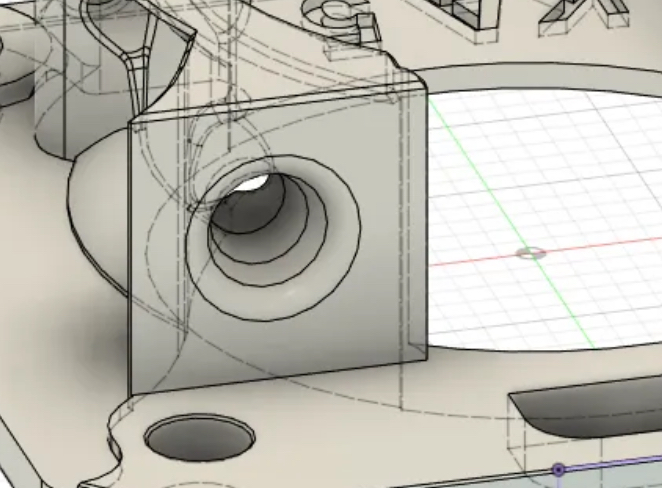

I’ve remixed a plate upgrade, and added a bigger “funnel” to the filament entrance, and so far haven’t had any issues inserting filament, while it was a pain before.
https://www.printables.com/model/977122-xl-nextruder-main-plate-better-filament-guide
