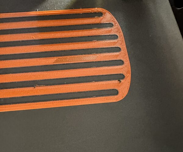

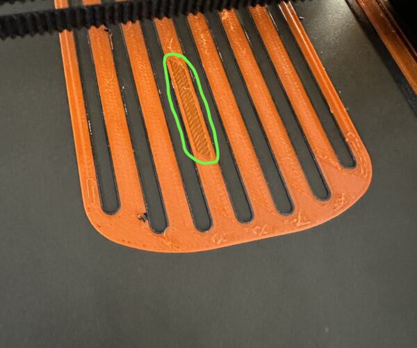

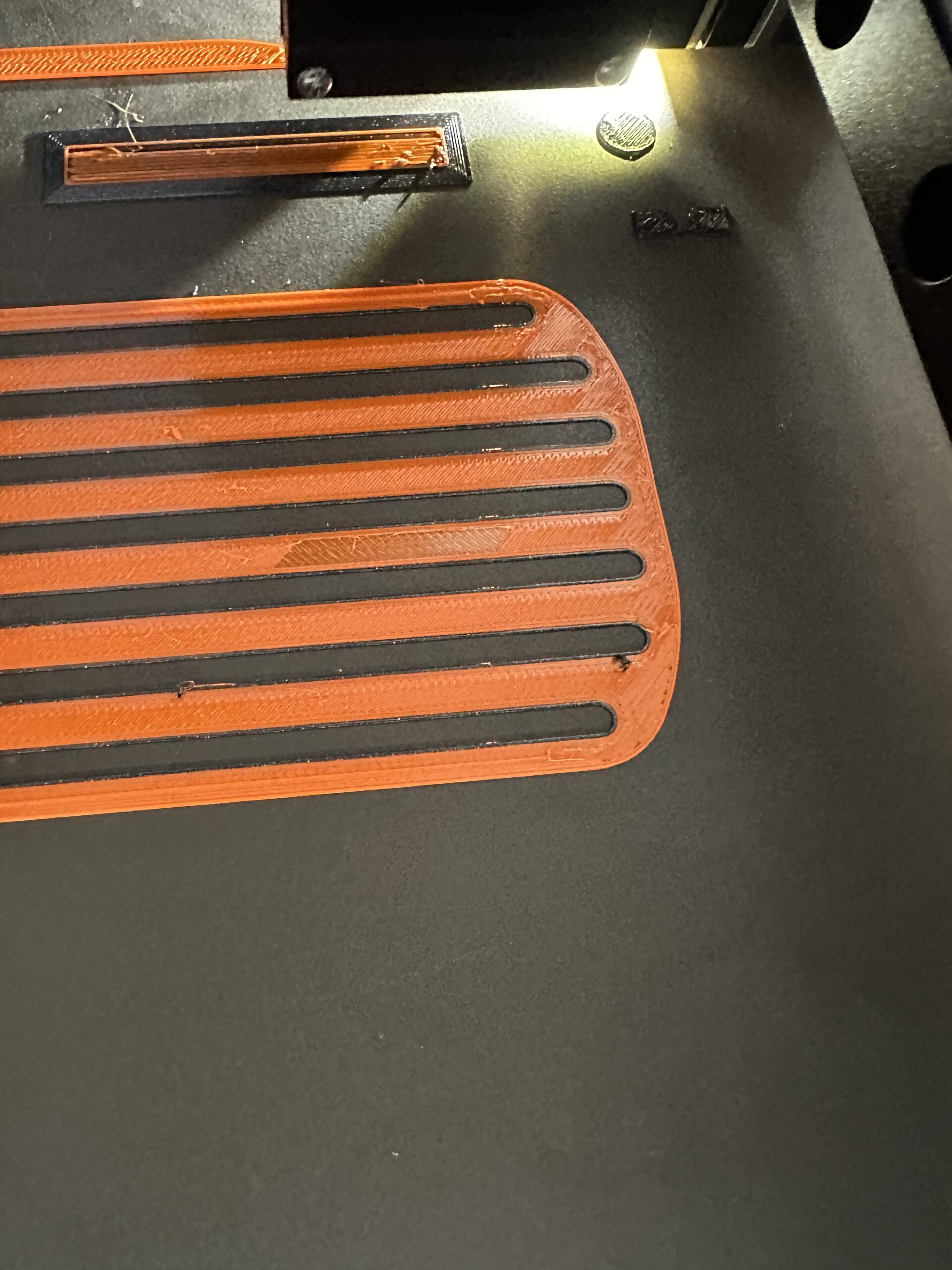

Wondering if anyone can give some input on this one. I noticed the second layer of a print just skipped a part of the infill. Attached are some photos (one has the area circled in green since it is hard to notice):

Looks like a there was a small issue in the filament. Somehow no filament came out of the nozzle for a short time.
Looking at the pattern before and after (and the preview) I assume the machine just did the gcode as it should.
- Small irregularity in the filament? Causing less grip from gears on the filament
- Not dry enough?

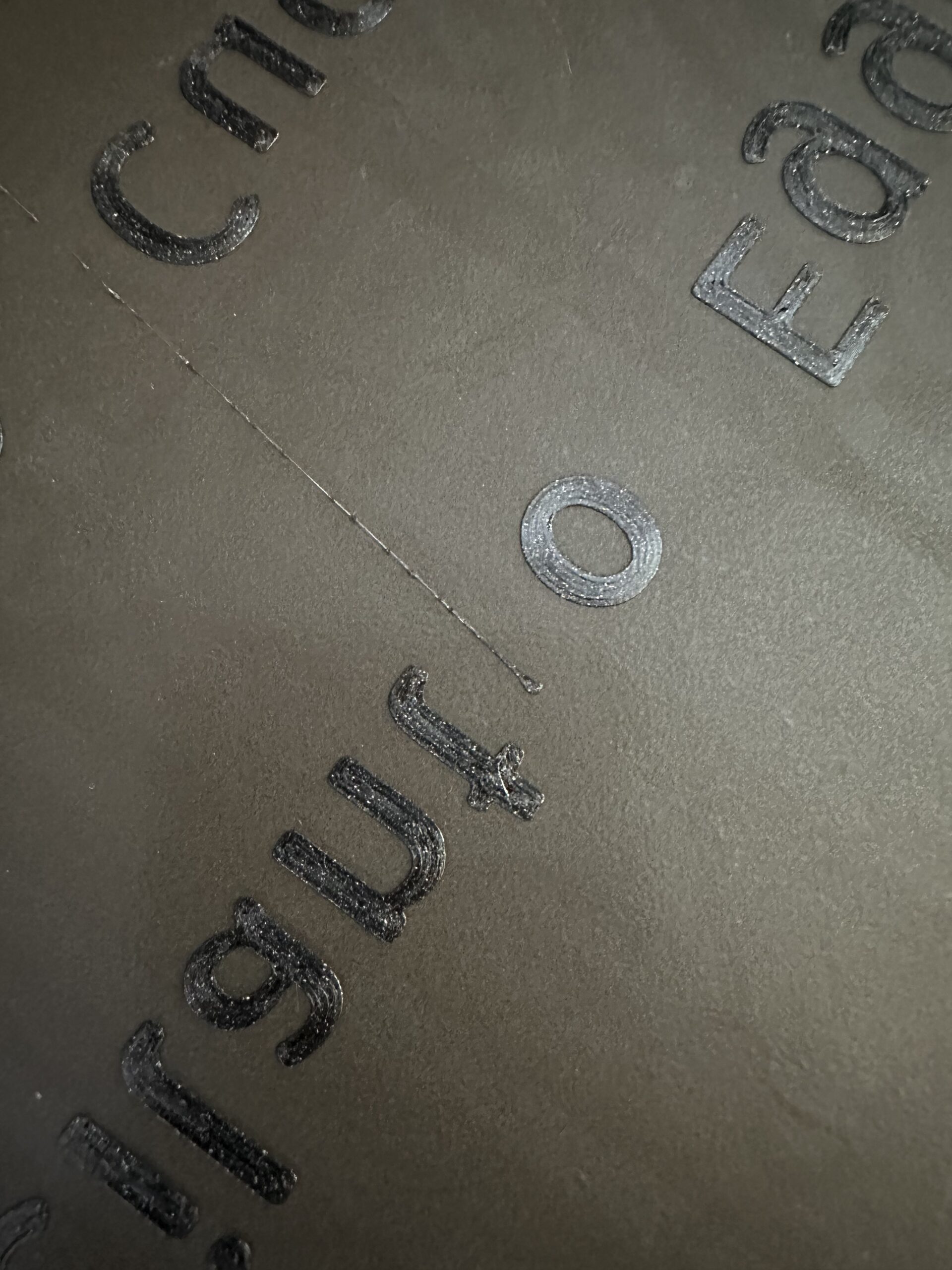

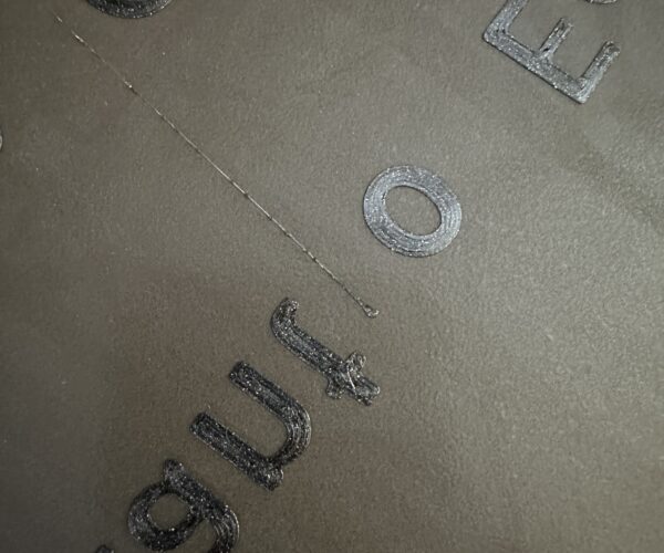

I observed this again today. I didn't get a video but I was watching the first layer. When it happened it started at the "r" in "Cilantro" and stopped extruding and started slowly moving directly towards the purge block. It wasn't doing any travel moves to extrude the "r". Almost like it just skipped a whole bunch of stuff.
