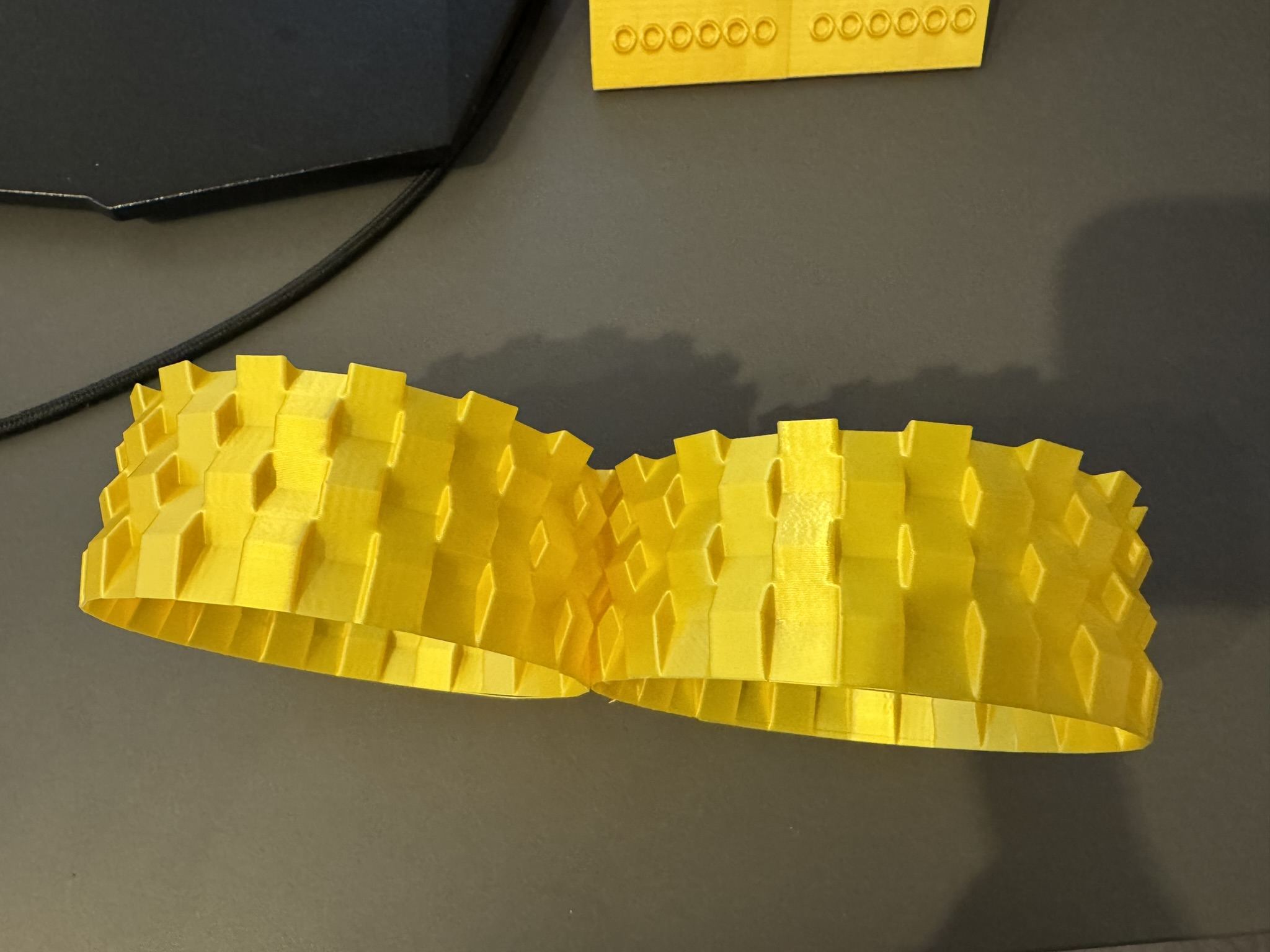

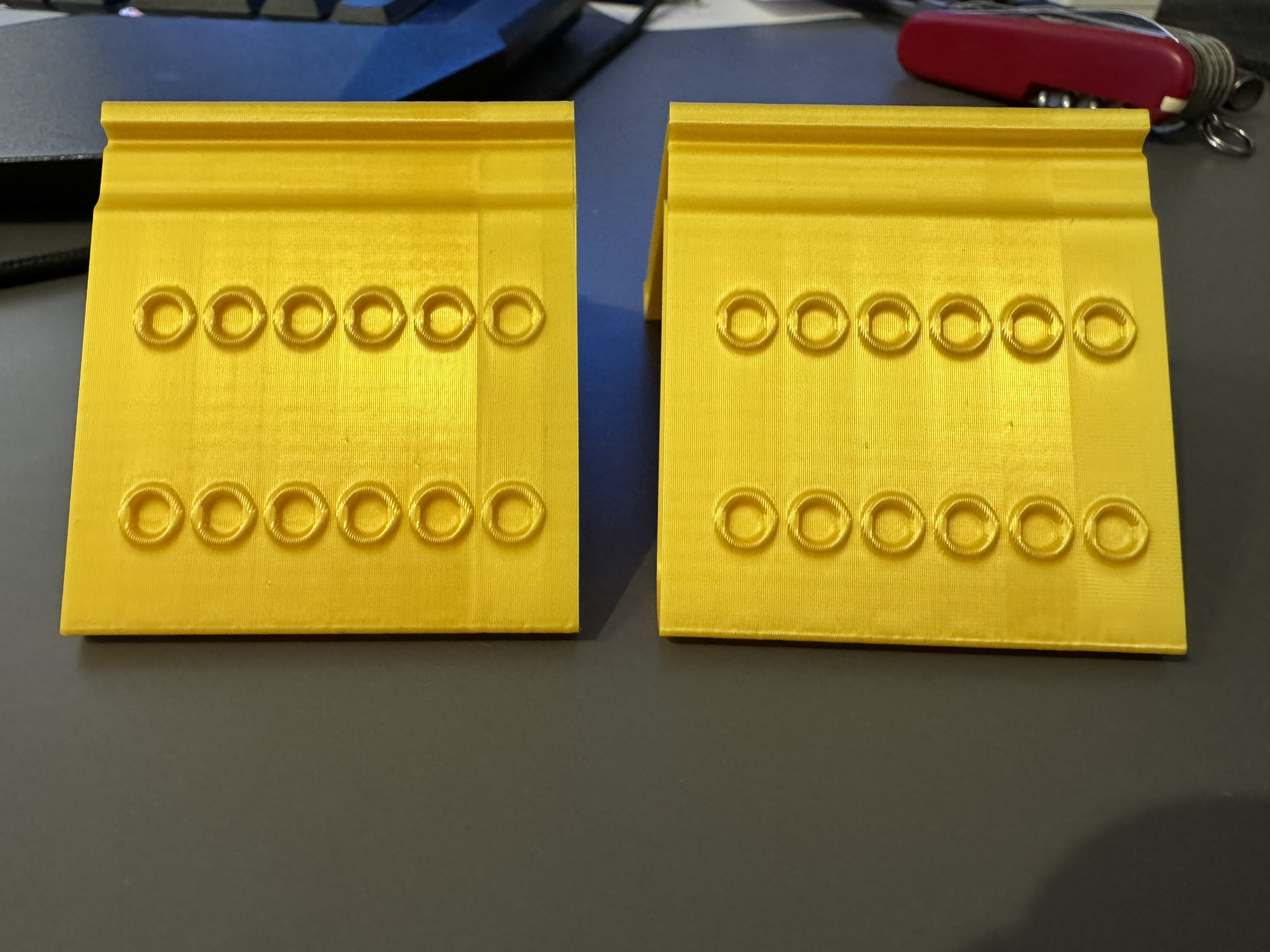

I have now done a few tests and compared the print quality and ringing with and without input shaping while my XL is standing on these feet: Since Prusa specifies a value in the firmware, I assumed that the printer would determine completely different values for input shaping with these feet for noise reduction.
You can't really see it in the photos, as there is generally no heavy ringing, but my test shows that there is more ringing with input shaping than without.I printed this vase, same wall speed. Without IS 30 minutes, with IS 26 minutes and this ringing test with different speeds.
Left IS, right without.
I hope that Prusa will soon give us the possibility to calibrate IS ourselves.
Posted : 20/01/2024 7:43 am

Please report this to the Github Prusa 32 bit projects.  Otherwise, It may NEVER get done.
