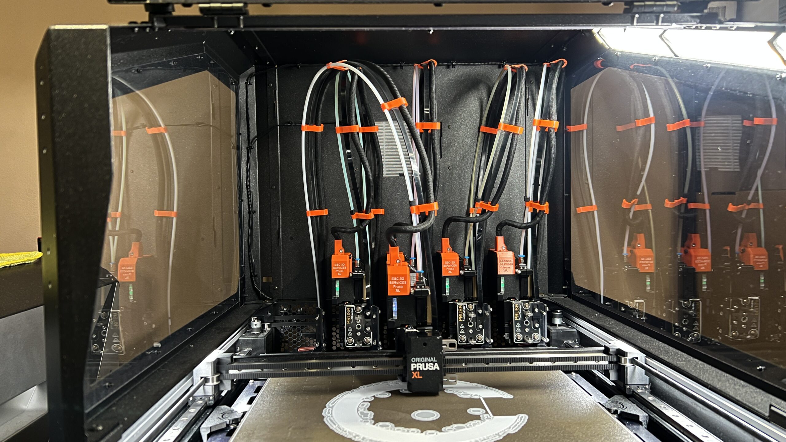

After replacing two buddy boards, I was still seeing the issue happening. I was watching "Monkey Brains Designs" video with all of his issues and saw the one that he fixed his XL by reprinting the cable connector. I then found that mod and installed them.
It's an ongoing process.
Opublikowany : 02/01/2025 11:51 pm
Jim Nangano
(@jim-nangano)
RE: Extruder stops mid-print
Download the file and give it a test, your faulty extruders might just start working again.

Printed out the modified connectors.  THANK YOU JIM!!  This fixed the problem and all prints since modification have been flawless.  I printed out the parts in Prusament PETG (Orange...I was out of black).  I used the M3x16 Torx head cap screws that I had left over from the XL build instead of set screws as designed.  I'm quite pleased.  Thank you again, I will post the pictures to the printables site to get the designer due credit.

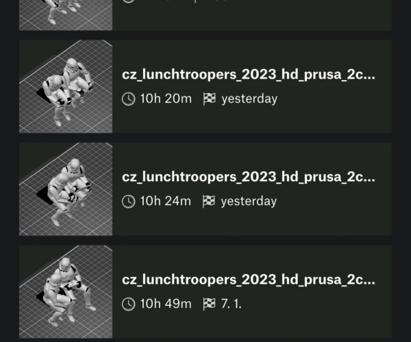

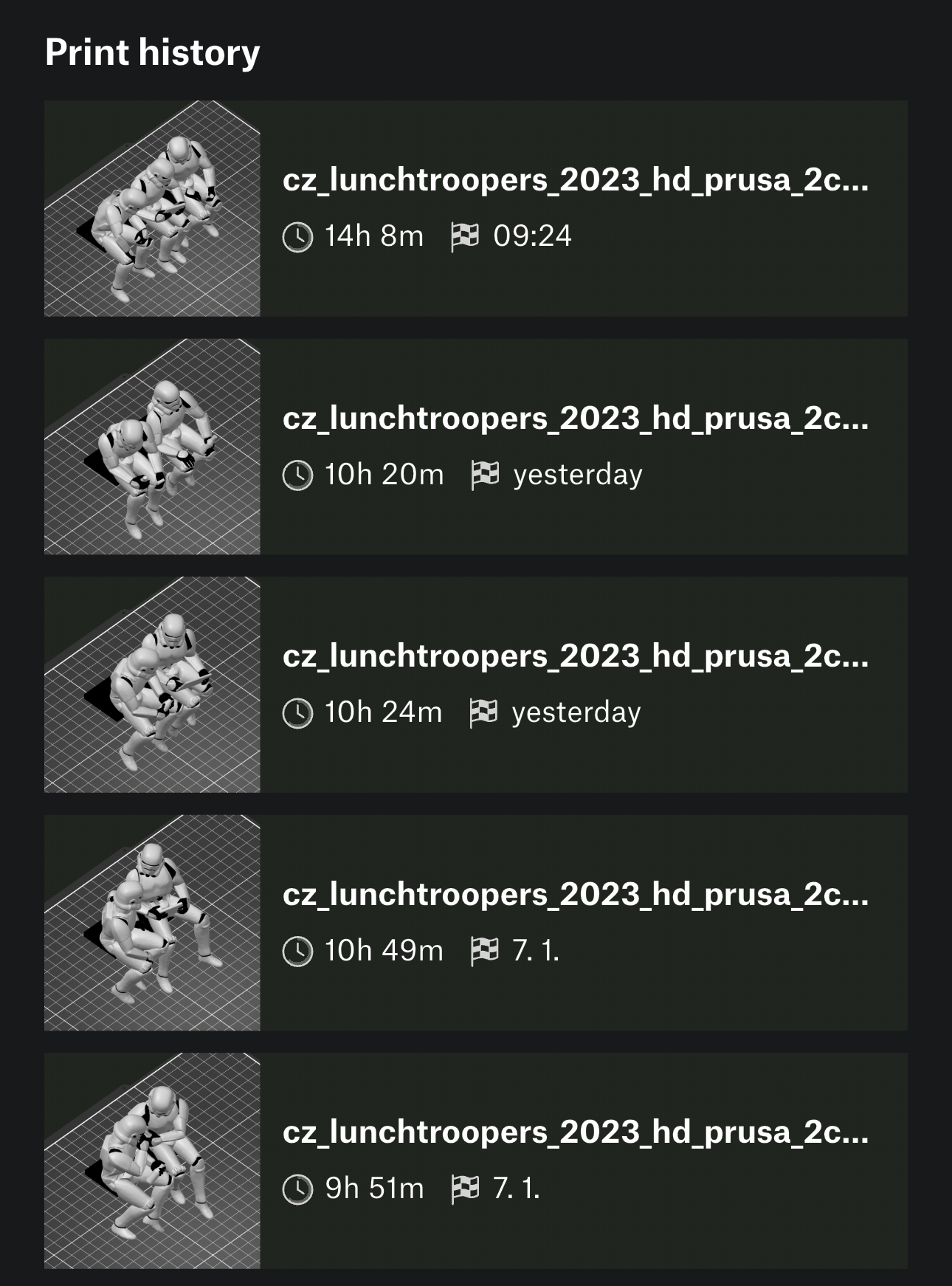

Jim Nangano
(@jim-nangano)
Final update, the two nextruders that previously had the issue were loaded with black and white filament and printed these five models perfectly. total print time of ~60 hours. I can say this issue is resolved!
