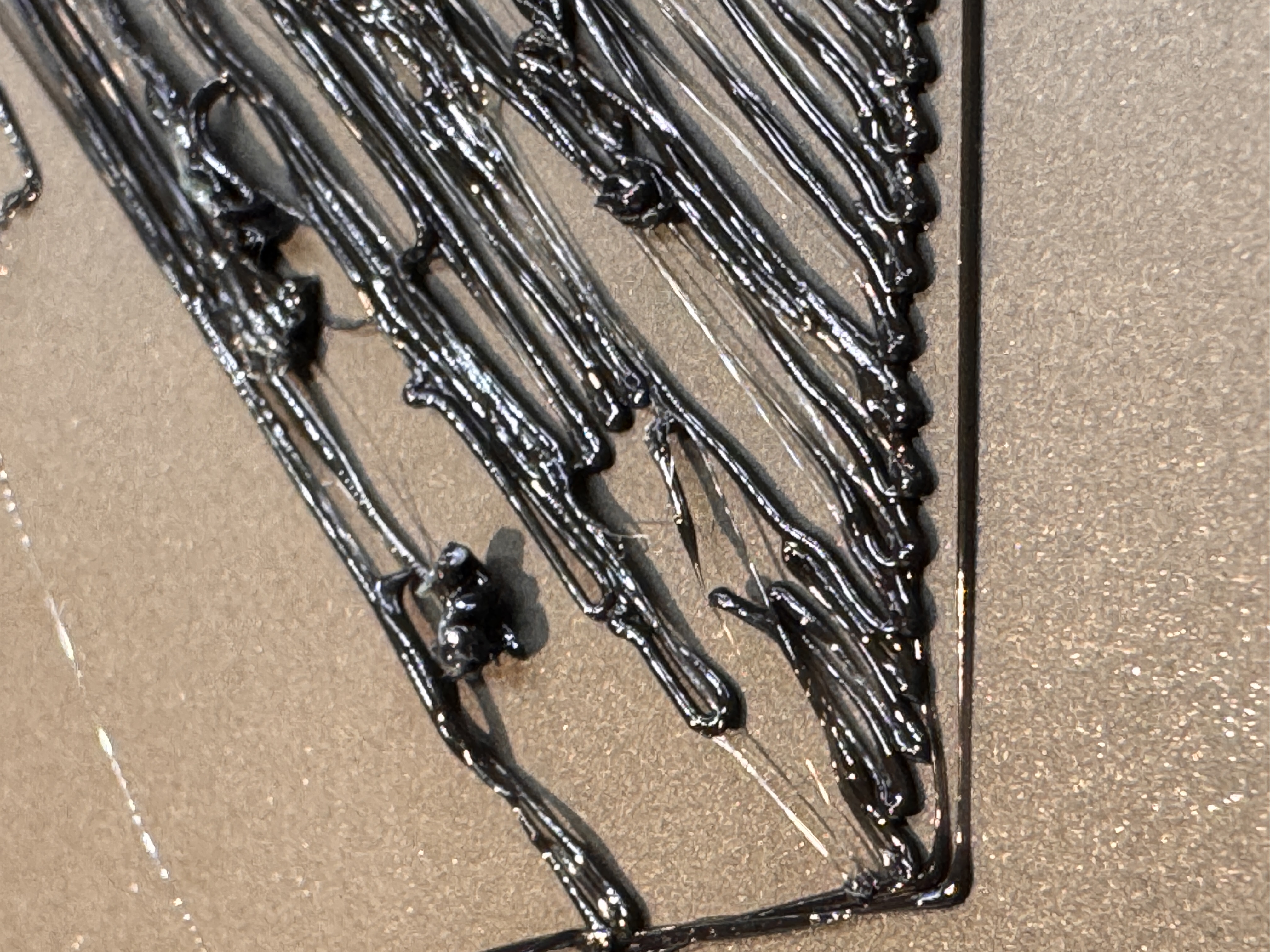

RE: After Stopping print Extruder tries to park
Good morning,
here you could see the reason why I stopped the print. This happened yesterday. Then I restarted the print and it works.
But this time no crash.
