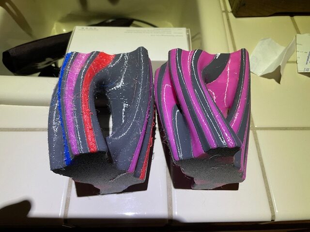

I turned on the prime tower and this time all the blobs went there. See the pic. This is actually not a good solution nor is hiding blobs within infill. Any blobs anywhere can cause a nozzle crash and or knock a print off the bed. Print on the left shows the blobs and gaps, note this object is thin walled. On the right the print had the prime tower.

For me,  blobs in petg other that prusament are nearly always because the extrusion multiplier needs to be decreased.  I basically start with .98 for any non prusament petg and usually end up at .97 before all blobs are eliminated.

That’s a different kind of blob. I see blobs with PETG from two sources. The first is from material that did not get drawn up out of the melt zone when the tool is disabled. When the tool is picked up and the material detracts it can spit out this tiny amount as a small blob. The prime tower always gets this blob.
The second blob I see is from a build up of the typical fine whisps of material that PETG always does no matter the temp no matter what the printer is. That’s PETG. It is what it is.
If the flow settings are off (as with ext multi) there’s a lot more defects then just blobs of material!
