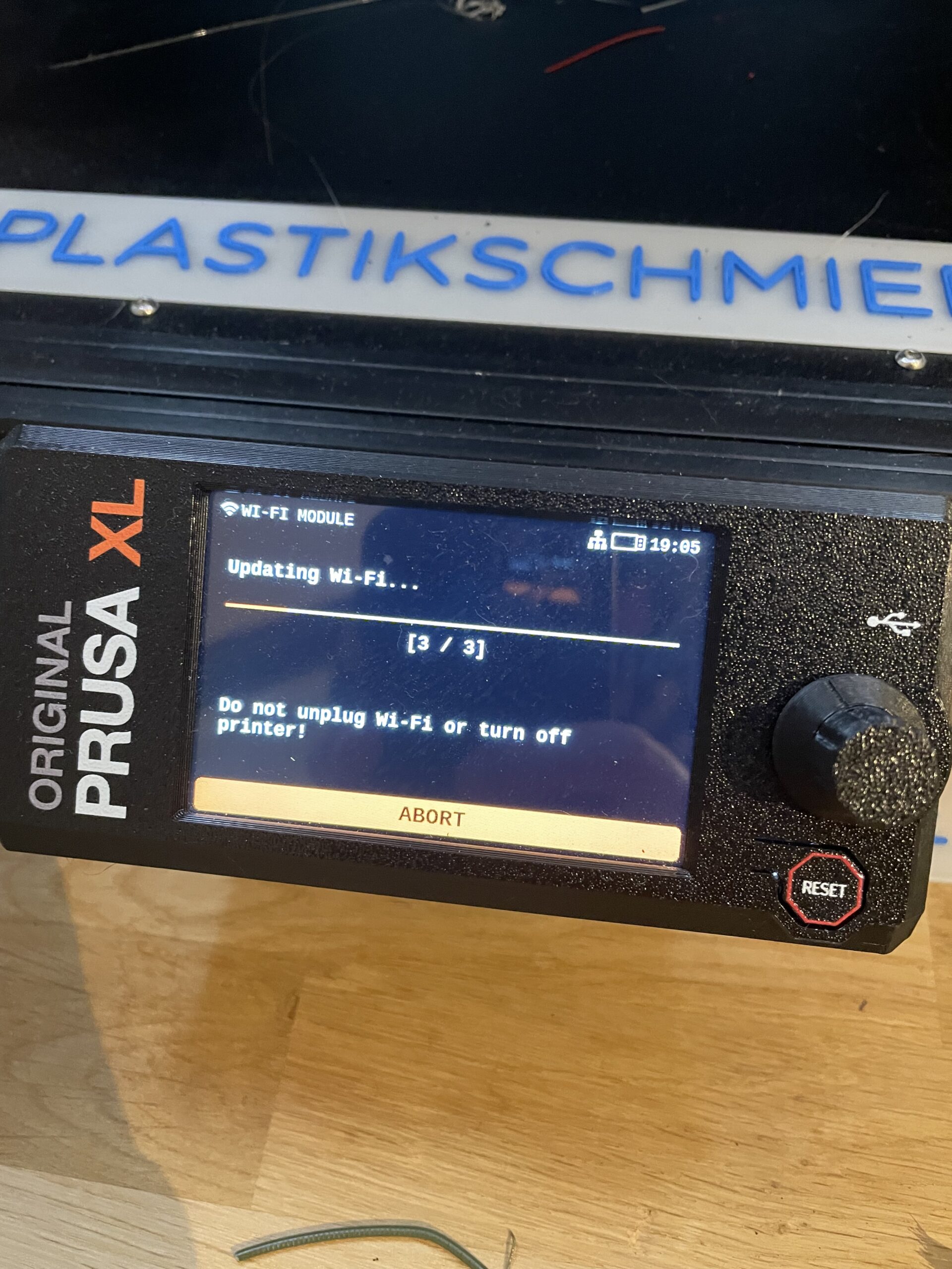

Plastikschmiede
(@plastikschmiede)
RE: 6.0.0-alpha Firmware for Original Prusa XL
PETG was loaded in tool 1 and I wanted to replace it with PLA. Saw that PLA was already loaded. I canceled the unload filament process. Then there was a message like the one in the picture below.
The printer then ran error-free again.

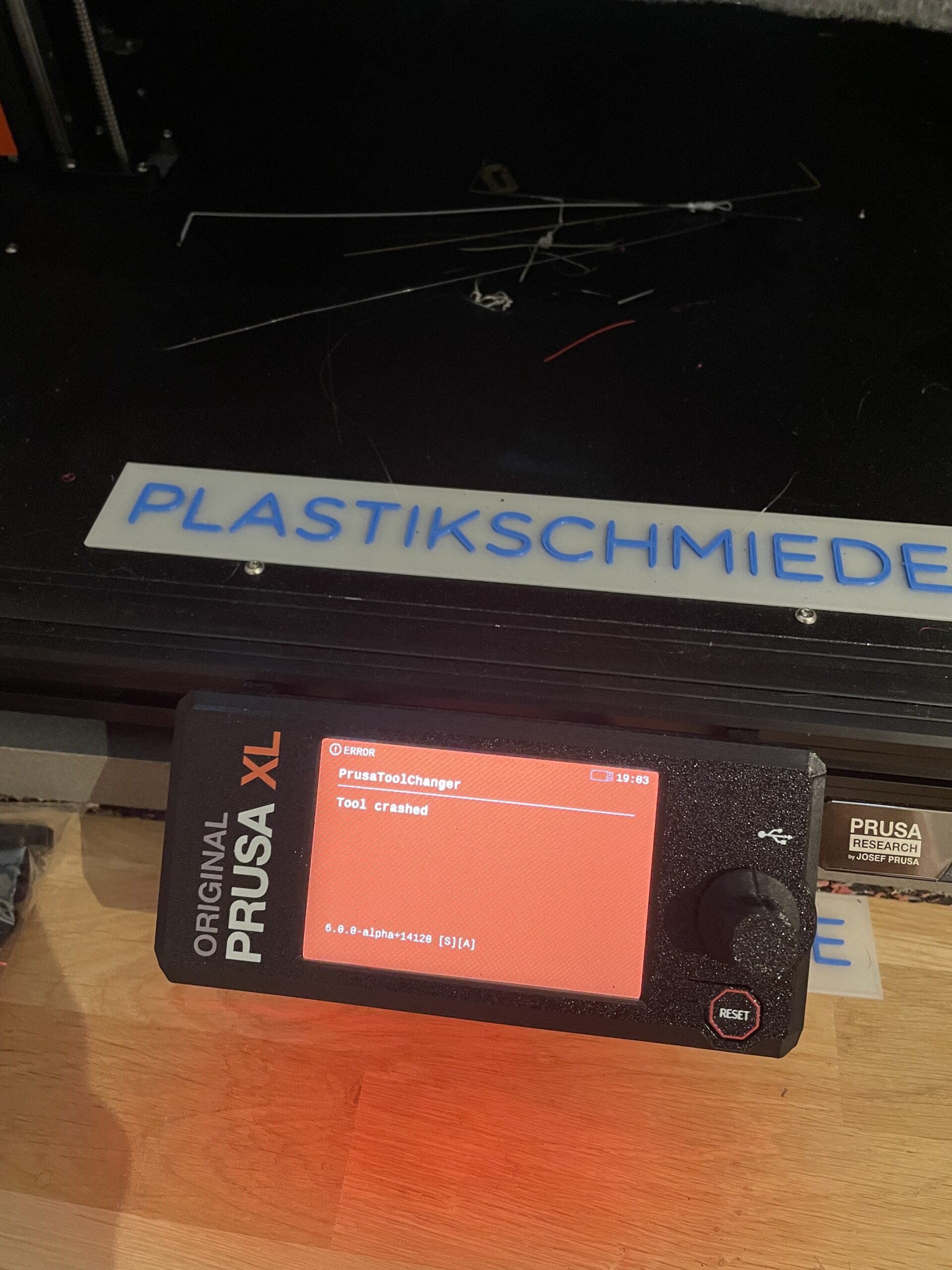

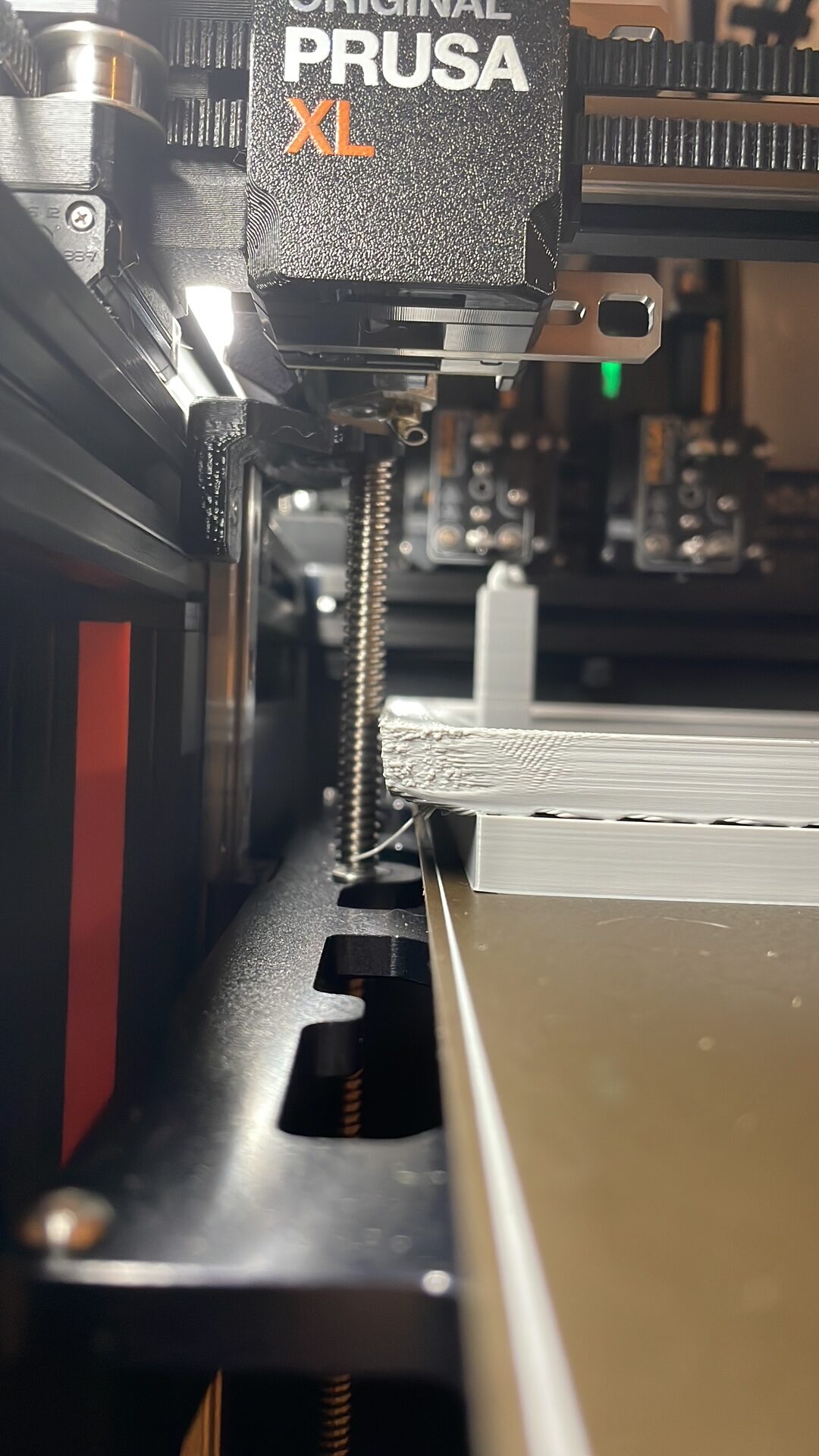

I didn't know that after the update you gain 1 cm on the X axis! I am now able to print 37 x 36 x 36 cm!
I had a crash followed by a layer shift, which I didn't babysit. When I found the finished print, there was another crash message at 99%. that is the result.
I don't know if it's something firmware specific, maybe the first crash was to blame, but I don't really know why. I guess the first purge got caught on the hotend over time.

Brian
(@brian-12)
Posted by: @plastikschmiede

BaconFase
(@baconfase)
Do you have Phase Stepping turned off?
I've logged my experience with the new firmware and Phase Stepping off on Github. Basically I've been getting belt-tension-like symptoms (skewed prints, layer shifts) with the new firmware when Phase Stepping is turned off; simply turning Phase Stepping back on 'fixes' those issues.
