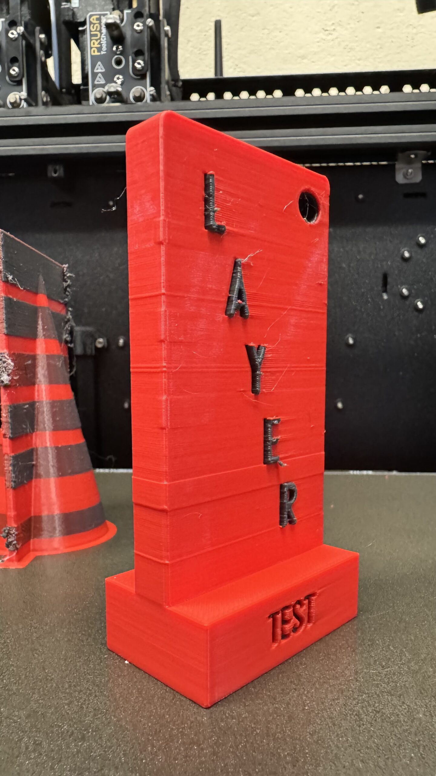

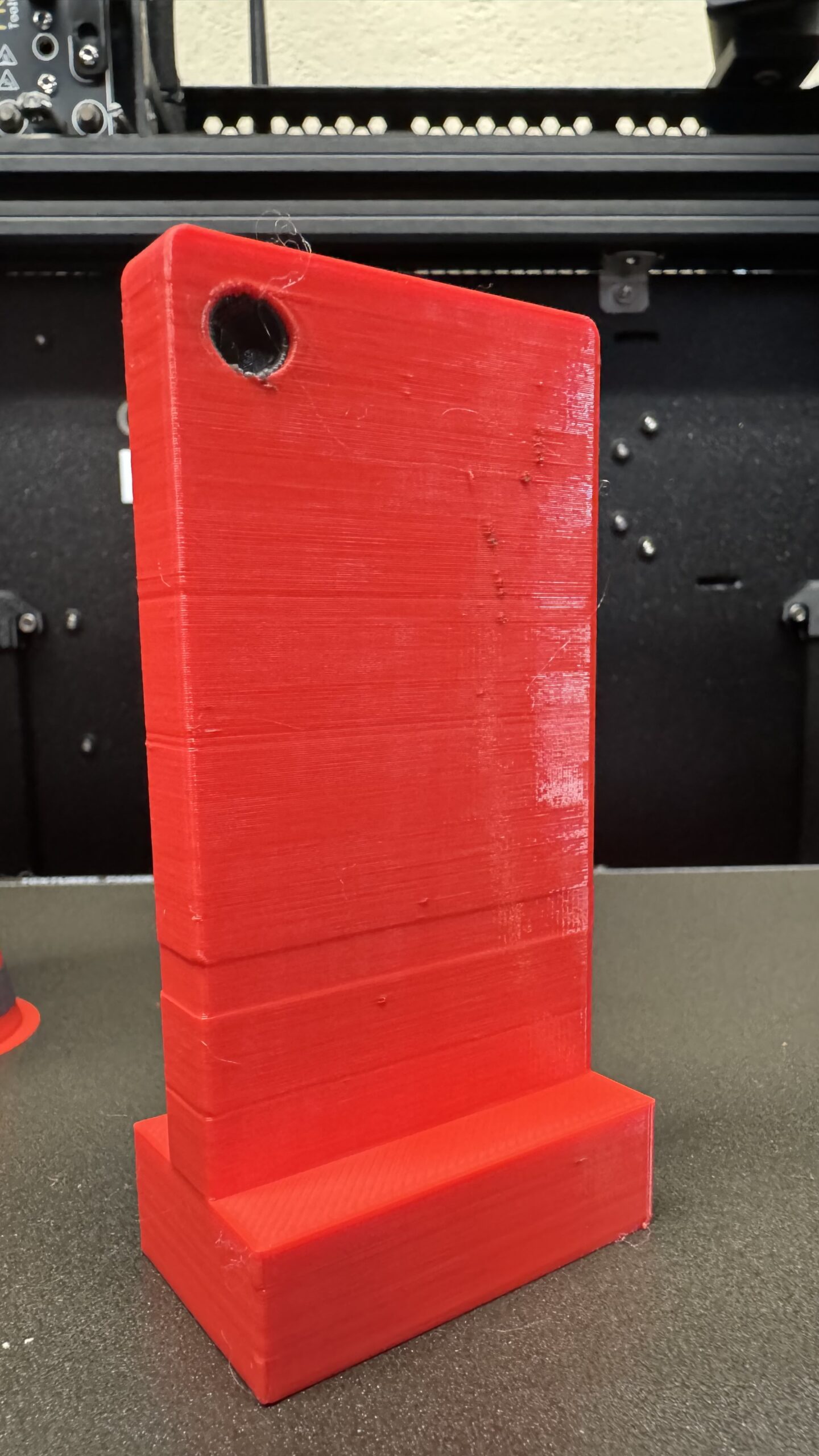

sadly I have to report I’m on my replacement XL 2 Tool unit . First machine was a build disaster with lots of build quality issues so the Print quality off of it was truly horrible. I’ll leave that summarized as is , now the second machine, I have here now . I’ve had for a few weeks all be it is working a lot better than the previous machine . I am stuck running in circles with odd layering issues and while using two tools, I get super bad banding & layer shifts . I been working with Support for the last week straight tried recalibrating and rehoming several times check in hardware screws, belt tensions, manual tool calibrations and I still get left with this . This was a quick test print to really show the issue . You can even see if in the wipe tower ……. this is the best it gets too. when i got the MK4 that was literally from the box to the rack and it hasnt stoped printing since day one , dont understand this one

So sorry for your struggles.  Do you have the GCODE?  I want to try an print it this weekend.  I just have not had the issues you have had.

Motors cross wired? Those are some serious artifacts - I wonder if there is a problem with belt tension? I have seen some Vorons that have had slightly similar defect and it seems like they are attributed to belt tensions, wrong motor wiring or incorrect amperage set in the firmware (like too little amps and the motor skips steps, too many amps and they run really hot).
