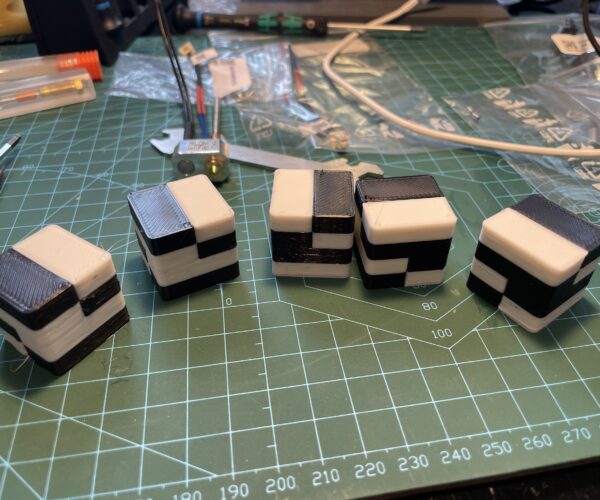

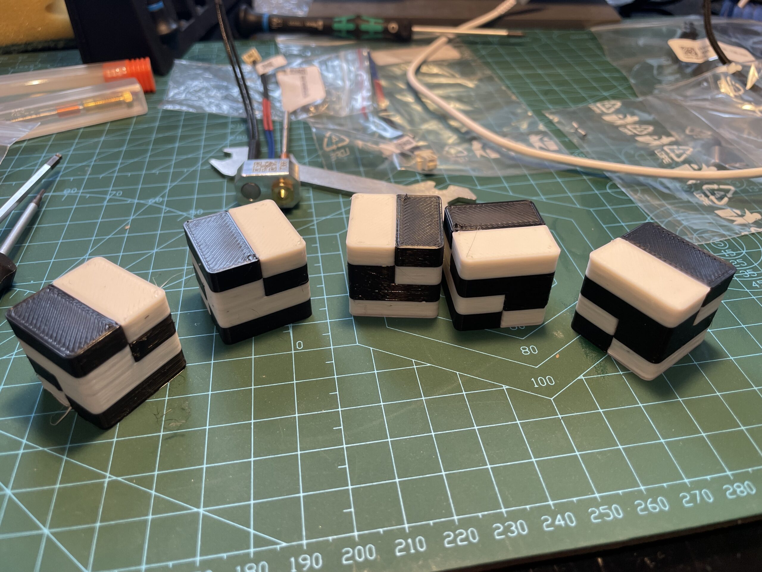

Some of the test prints. I’m pretty happy with the one on the right (shown close up). This is a worst case scenario with black and white. I didn’t even use the prime tower for it. Happy to share the 3mf if others want to try it or improve on settings

I was almost inclined to say that the extrusion consistency of the white parts don't look particularily great. But then, this is white. White is the nastiest colour one can try and often has a tendency to be quite patchy. Does the black have much better extrusion consistency, ie less wobbly side walls? Hard to see on that image and on black in general.

It's a 25mm cube so probably not ideal for a 0.6 nozzle plus as you say the white doesn't help. The cube looks decent in reality. I think the stock settings push too much filament for the infill etc. 0.68 width. So some tuning to be done there.

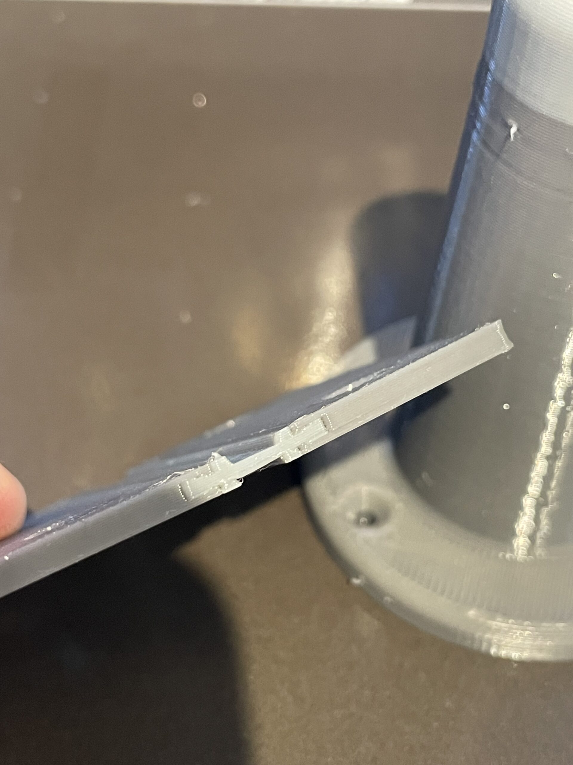

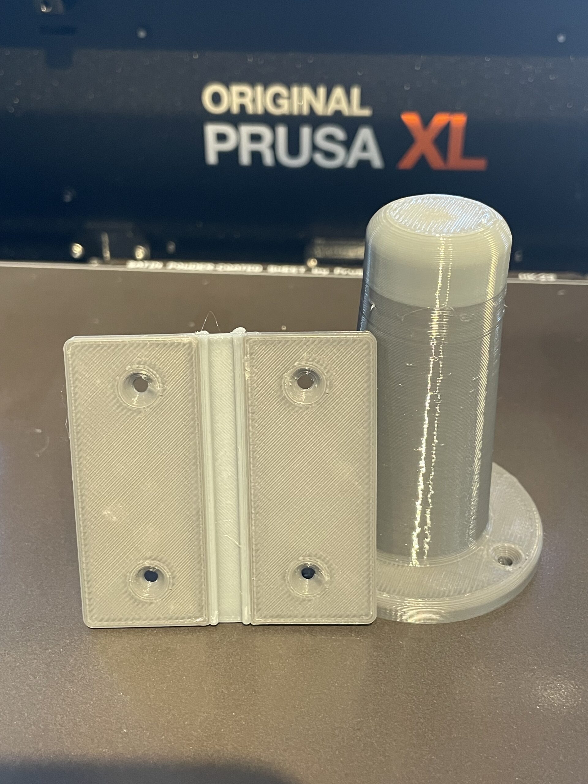

a couple of multi-material ‘test’ prints. A PETG and TPU door stop, the other a flexible hinge. This is a new option for me made possible by the XL
