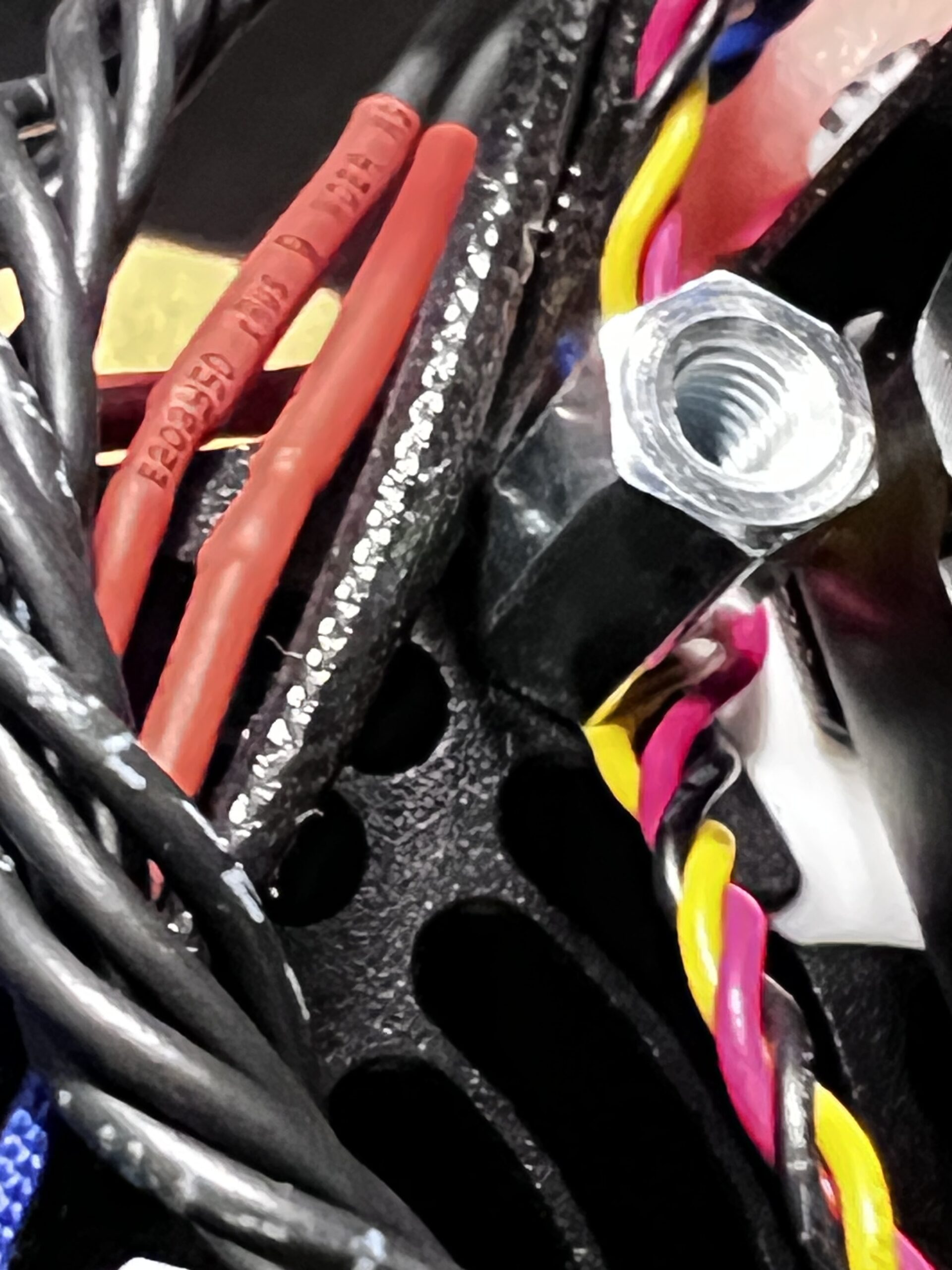

Jim Spence
(@jim-spence)
RE: XL dual tool - print fan self test fails on both extruders
XL dual tool- print fan self test fails on both extruders.
Has PRUSA arrived at a definite solution for this persistent problem?
I have had identical problems with printer fans test failure on both tools .  I have removed the shrouds of both printer fans.  This transiently worked on tool 2 but not tool 1.  Tool 2 would only pass intermittently with multiple tries.  Tool 1 never passed testing.
All fans are spinning and blowing air, run quiet and have unobstructed air flow.
I've tried compressed air to blow out  printer fans and checked for burrs.  Nothing seems to help.  Firmware version is 6.0.0.
Any and all suggestions would be appreciated.
PRUSA Chat frustrating.  They want videos of all tools including  the fans and tool hot ends, videos of the complete self test.
I have difficulty attaching videos to Email but have enclosed photos. of tools and test result.  Not sure of any additional info in video.
Posted : 27/09/2024 9:45 pm
