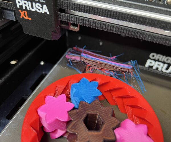

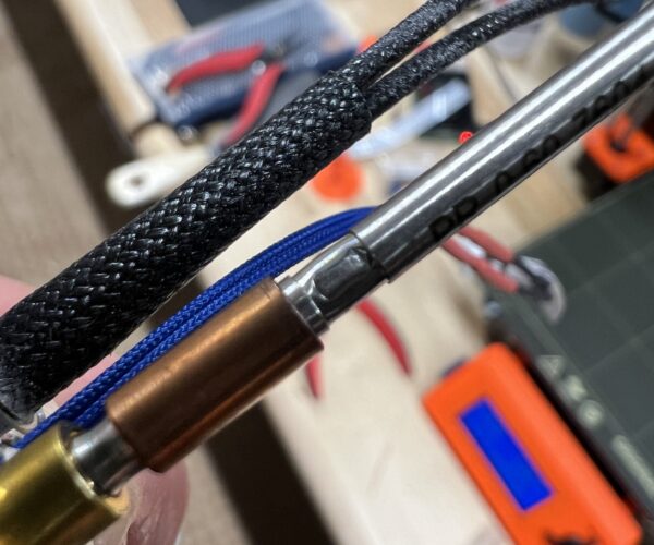

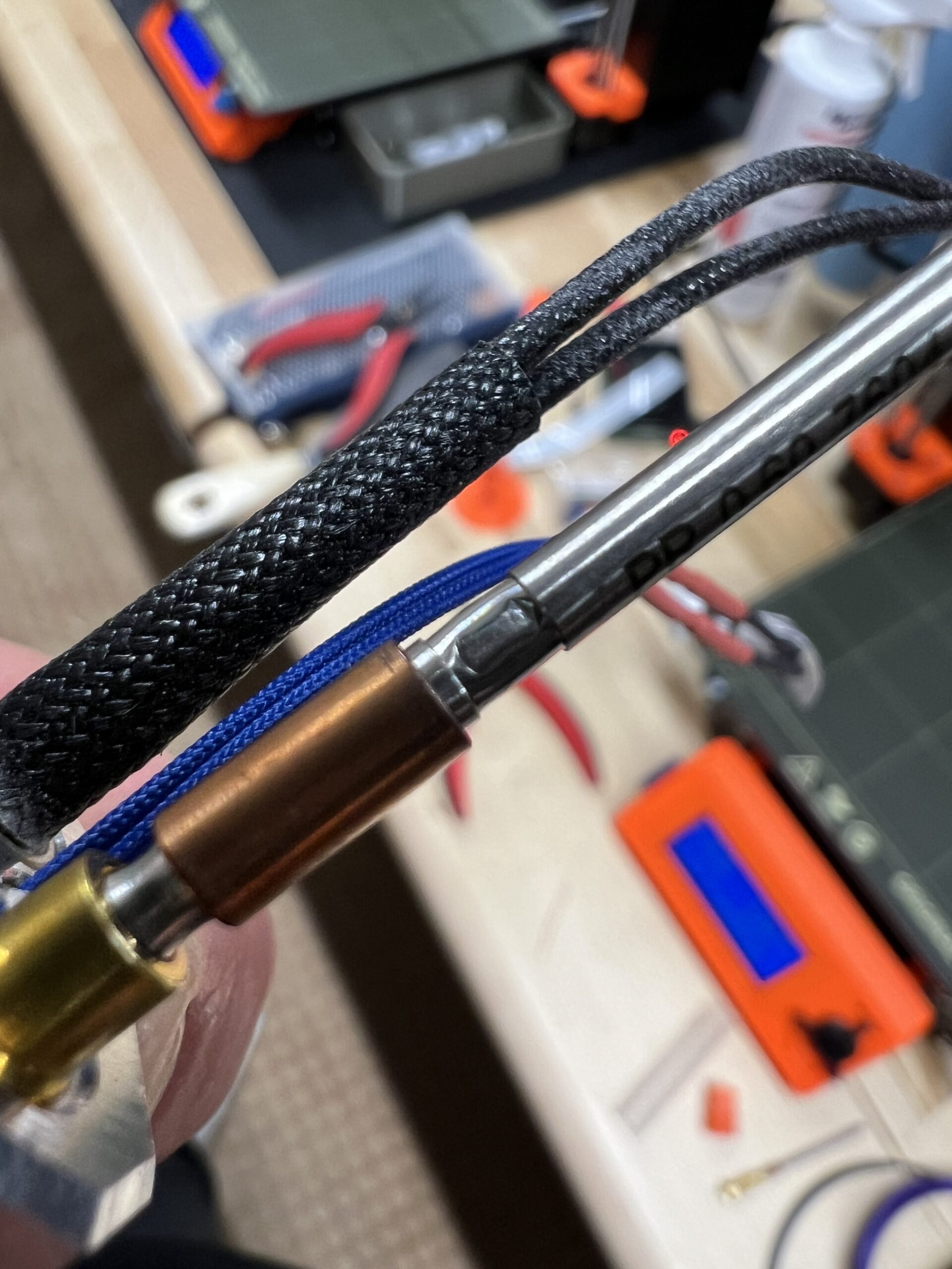

Not sure if this is normal where the set screw tightens or if somehow they applied too much force or otherwise made this flat.
I had ordered spares last week, and new one doesn’t have a flat section and this is the first place it stops (can force through) and then it goes a bit further (heat break area) and would stop again (again, more force) until it gets to the nozzle tip where it should stop. There was also a lot of marking on the bottom 20mm of the filament I was hand testing with after removing the nozzle assembly.

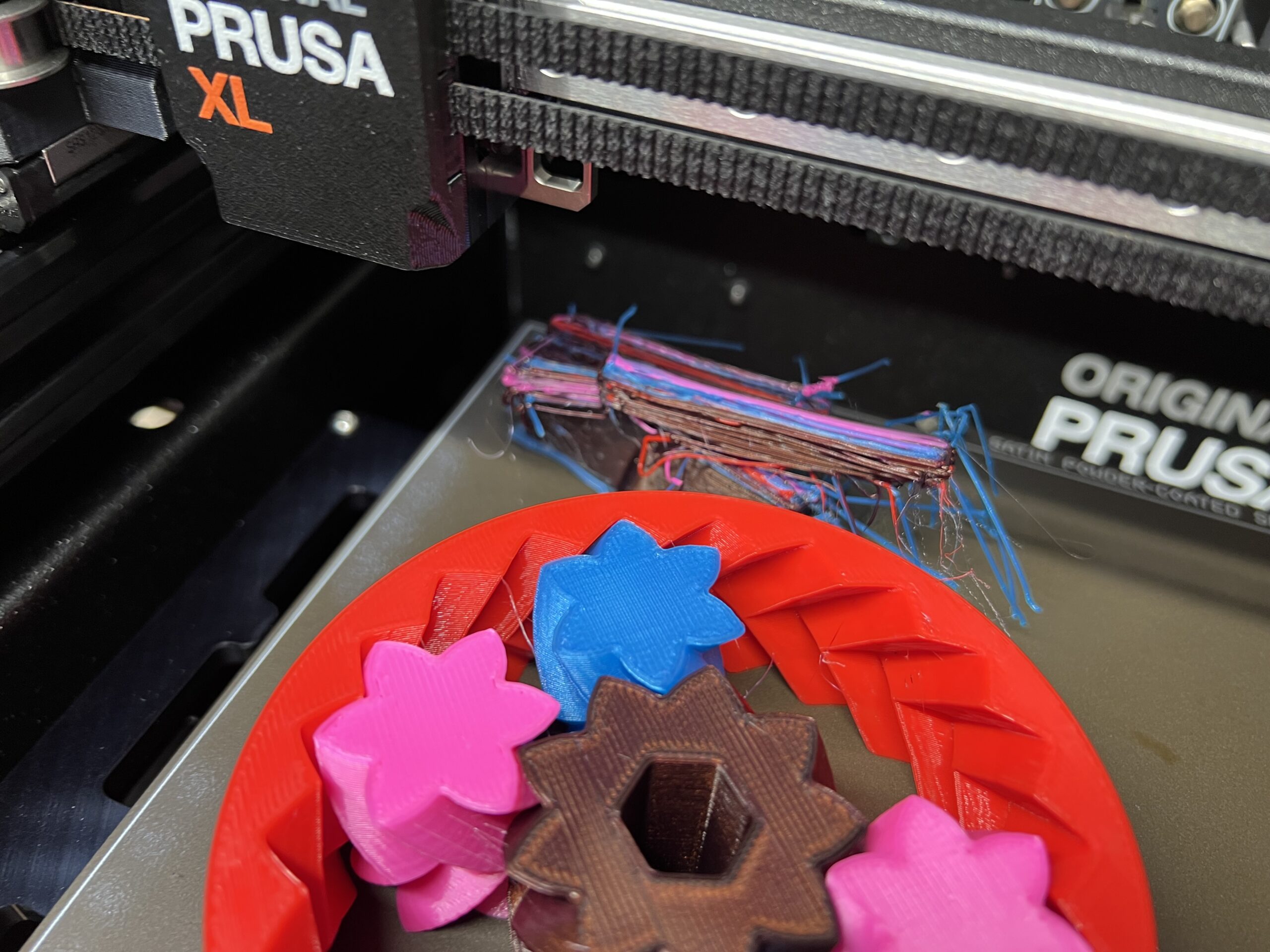

Printing 5-color first layer, of course it evidently doesn’t use Tool3 for the first couple of layers evidently. Mistake if you ask me, should be a couple of octagons and lines in each of the 5 colors to ensure all 5 tool heads have a good first layer.
The loading was perfect though, so think that fixed that part and I am not expecting further issues.
Printed a the 5-color gear, while missing all the T3 two gears. Came out great. A little stringing and this stuck colors on the outer wall on the way to wipe tower, but looked awesome compared to other YouTube videos I have seen.
