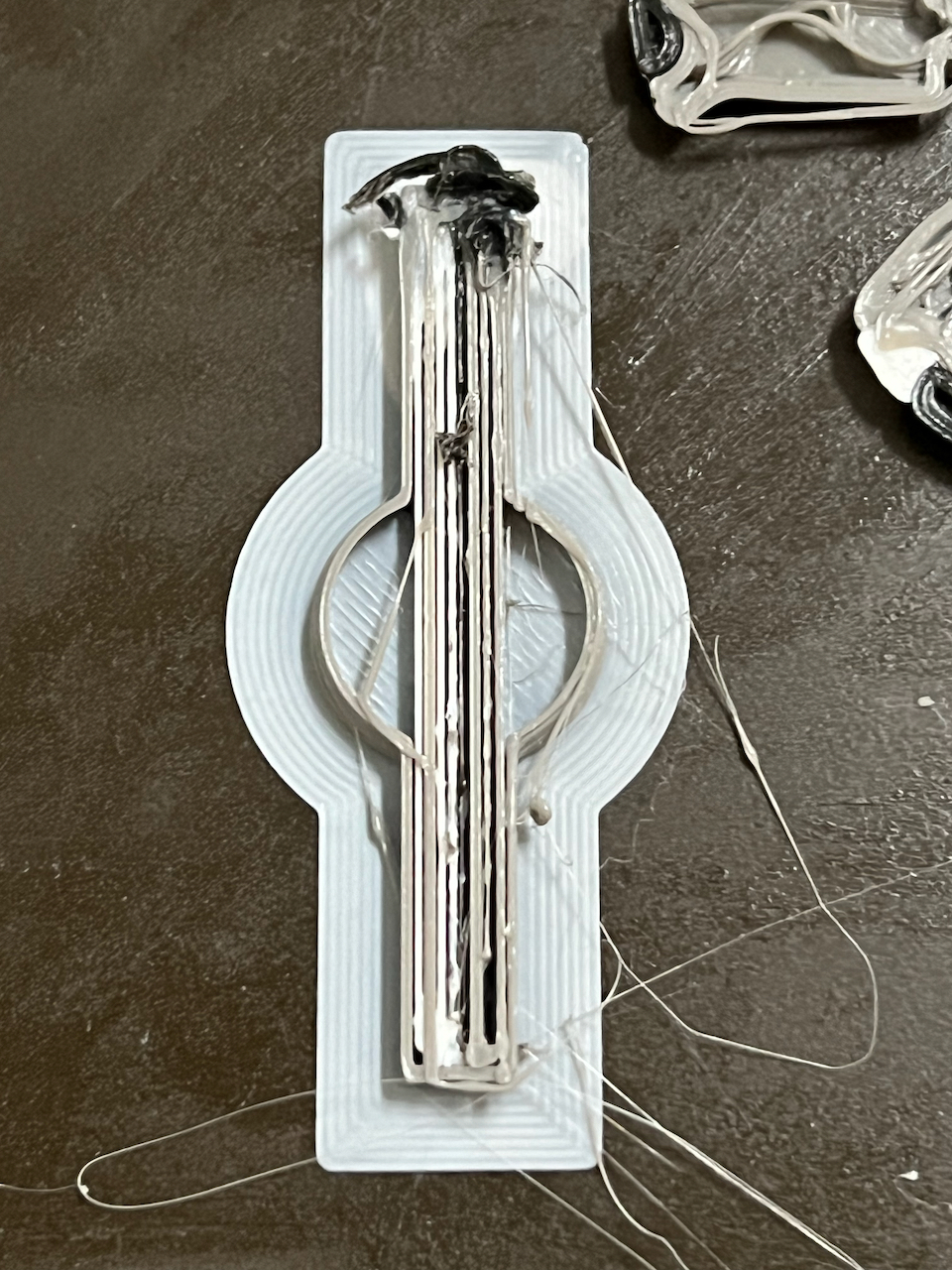

We fixed our multicolour stringing/blobbing issues by modifying the gcode to move the extruder away from the print before every tool change.

1. Set your temps correctly. I.e, pla should be 200c not 220 per the preset. PETG should be 235 not 240. The bed can be way lower for PETG and it can be the same as pla otherwise the xl fw won’t be happy, because the Prusa “Engineers” are not good at understanding requirements and constraints.
2. Set “Retraction when tool disabled “ for each extruder to around 11mm to retract out of the melt zone when parked.
3. Turn off the prime tower. You won’t need it.

So it seems for some reason the wipe tower caused a big blob, which caused layer shifts, stringing etc and a huge bunch of problems.
I've set the "Wipe tower purge lines spacing" to 100% instead of the default 150% in the "0.20mm DETAIL @ XL 0.6" profile and it seems to have brought everything under control. YMMV.

Well I used a method from the YouTube video that was posted to add a G code to the filament settings, which retracts the filament and moves the head to the back of the build plate for a second before docking. This pretty much alleviates the stringing ( also dropped my temperatures to 190 ) but did nothing in the way of fixing or helping the sheer garbage, poor layer lines, and inconsistencies in extrusion during multi tool usage. The photo on the left is of the piece I did with the updated G code settings and the 190 temperature. The object on the right was the one done straight off the USB Gcode code provided by Prusa. This machine has hard evidence of extrusion issues, probably related to pressure advance ( Prusa calls )  linear advance with configurations of the new design extruder. If I do a single tool head print, print quality seems good and acceptable with the G code and temperature settings. Soon as I try a multitool usage its absolute garbage extrusion layers. The lower section that prints with just the one extruder and doesnt bounce back adn forth between tool heads printed flawless

190 is on the low side. I’d up it to 200(assuming pla). Also I’d look at testing small cylinders similar to those orange tubes to see if you can replicate the effects we’re seeing in your pics.

if you see the second photo on the post that was at 190 as well printed perfectly , anything higher even at 195° it starts to ooze blob  and string badly . The layering on the photo on the Right is the Prusa default settings on that one and was printed at 215°

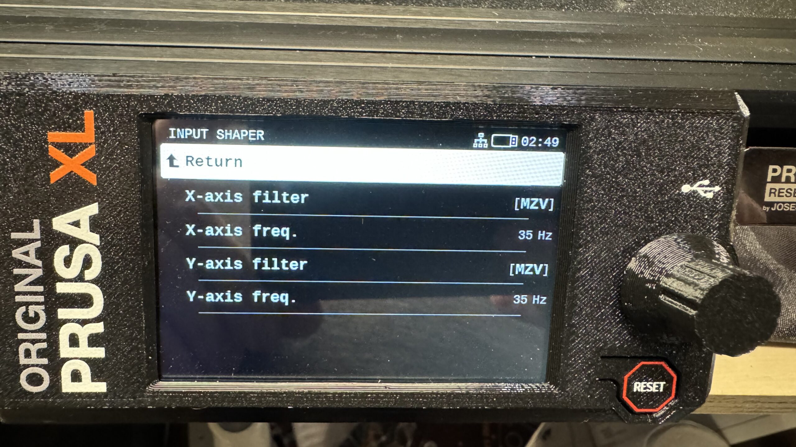

well here we go ! Installed the new Alpha release firmware , few new menus with the update . Started their pre-Slice half hour benchy 🤞 the dev details in the firmware notes has this firmware with full input shaping and pressure advance . Really hoping this machine will moving at its full potential now !

It’s still just an alpha, I would moderate my expectations. Maybe closer to full potential.

they are currently not using the full potential. The XL has an internal accelerometer, but in this firmware they don't use it from what I've heard.  I hope this will be changed later.

Use of an accelerometer is for on the fly tuning as well as manual tuning. However, you don’t really need to tune input shaping to get some advantage from it. RRFW can use it without any tuning. Although to really see the most benefit the best use of it is on the fly tuning ala Klipper. Rumors via the production community is that Prusa has not stepped up to fully investing yet in the XL fw nor PS sw.

There is a lot of misinformation about input shaping that needs correcting.
Input shaping is open-loop (feedforward) control, it does not perform any "on the fly" tuning. Resonances are measured on X and Y axis, and in the case of Klipper and Prusa firmware, the input shaper (ZV, MZV, EI etc) is applied to each axis. One does not repeatedly calibrate input shaping as it puts the printer through mechanical stress, and the Klipper docs specifically caution against it.
In Prusa printers that have input shaping, Prusa has determined the input shaper based on what they know about the printer's design, weight, belt tension, accelerations etc. This default value in an input shaper such as ZV or MZV should already counteract resonances/ringing with a visibly better outcome than without input shaping. Should we expect Prusa to allow manual calibration, by displaying the measured frequencies so that the user can make a better determinant on the shaper to use? That would certainly be useful. A nice side effect is that belt tension can be measured as well.
