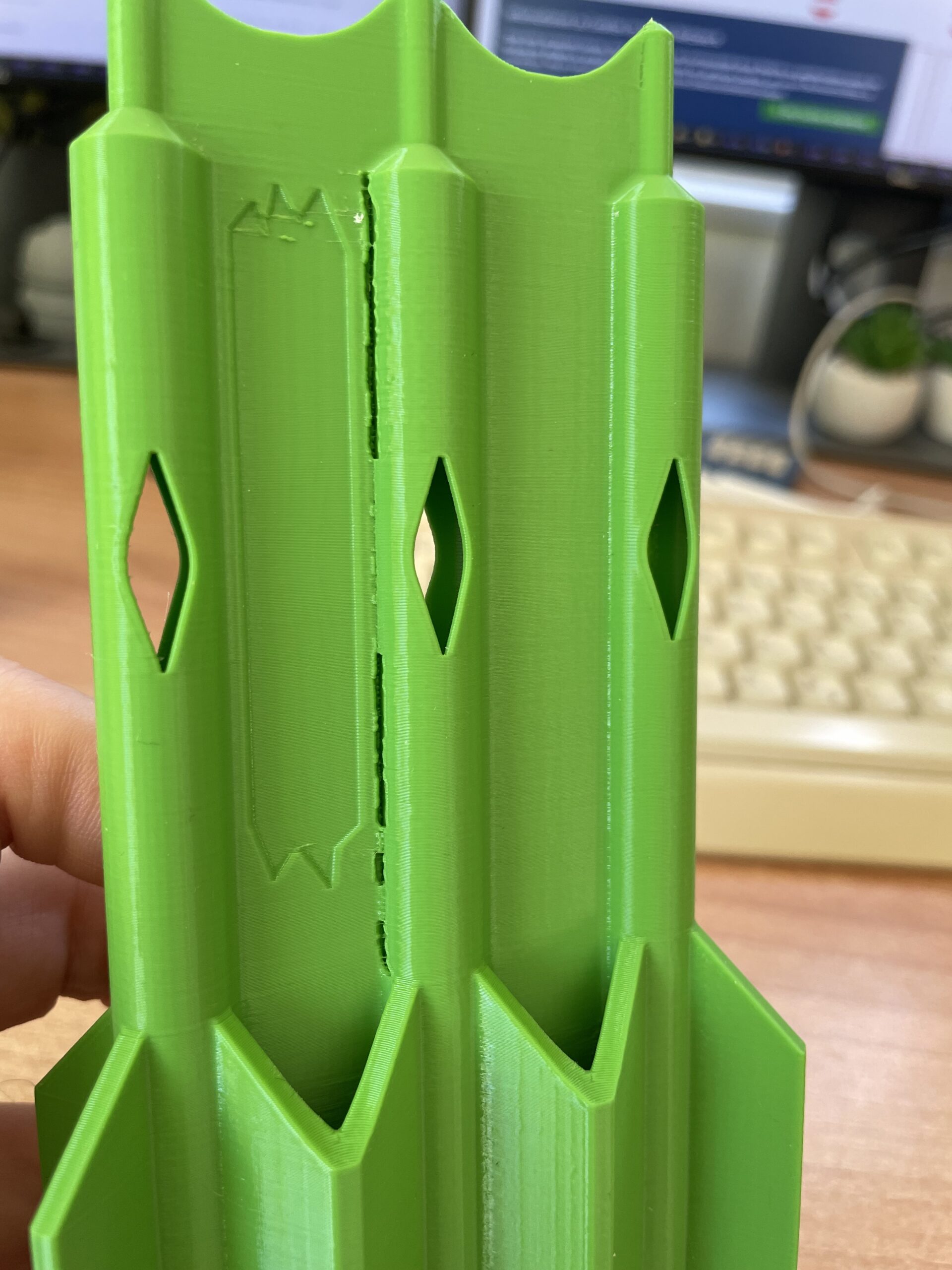

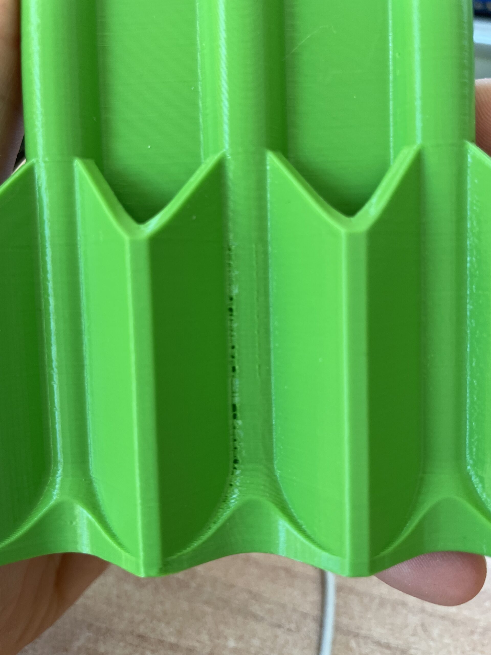

I am getting next issues with strange under extrusion.
i am printing a model from PLA and habe some strange under extrusion issue in one line in many layers. I looks like the moddel is shrinking and generate cracks.
i am using prusament PLA fresh from a bag and dryed 3 hours.
Prusa slicer is also set to standard profile for Prusamen PLA.
I did the print again and get this „cracks“ or underextrusion on another position.
Does anyone know what can cause this issue?

Hey mate,
I had this problem when I used a lot of retraction without using extra length after retraction. As the under extrusion happens right at the seam I think that can be the issue here.

RE: New underextrusion Issue
You first need to check your filament overrides. On this it depends if you need to change it in the filament override or in the printer settings. There you can lower retraction and/or dial up deretraction extra length up. Also you can try to turn off retraction on layer change. That helped me.
I guess it's the "use ramping lift" options. I disabled the option and changed a small amount of other parameters. Now i have a little bit more stringing (PLA) but no gabs on layer shift. My settings:
The strage sting is: I printed the same model on my mini+ with Generic PLA Profile and had no issue.
In a couple of days i am going to change the nozzle size from 0.6 to 0.4. Maybe this will also do some changes on print quality.
I am also not in rush…so print quality goes first. Maybe, no using the input shaper profile would be the better choice.
