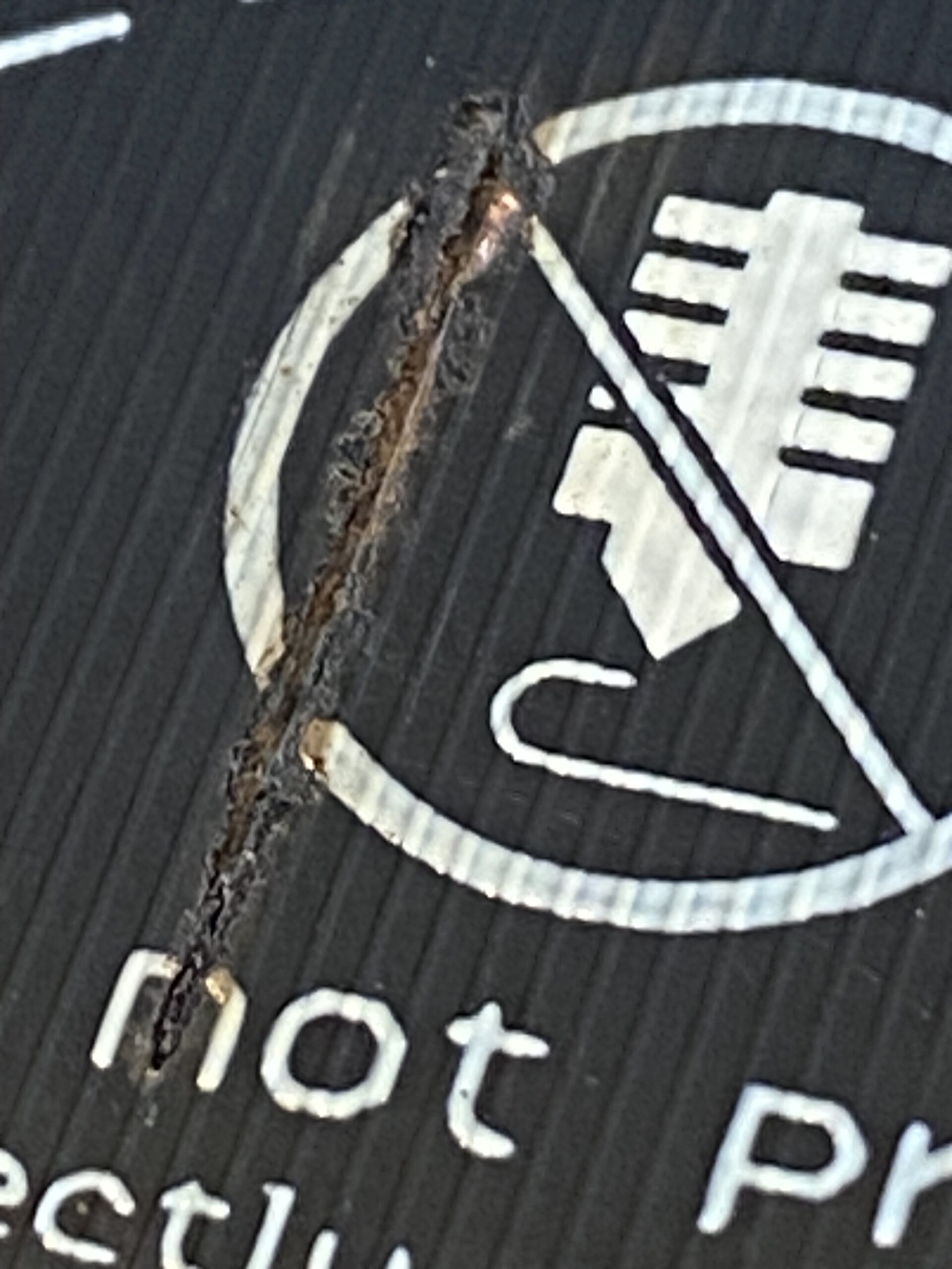

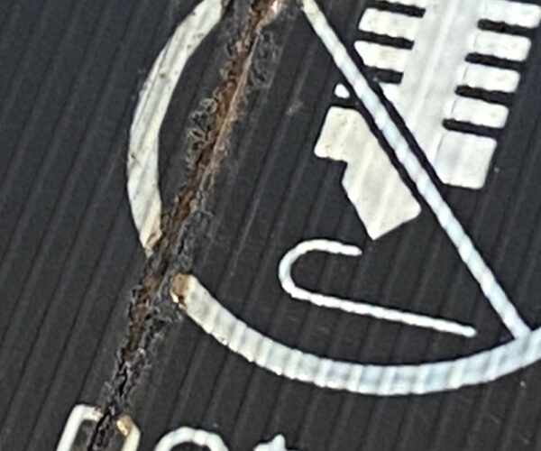

I recently had a burn mark on one of the tiles. It looks like the tile heater failed and short circuited leaving a burn mark (2cm line) on the tile and the satin sheet above. On the other side of the tile the heat element (I suppose the blank metal part is the heat element) also had black spots.
I am not sure what caused this, Prusa believes that I have made a scratch on the tile which caused the element to fail. I rarely remove the sheet so I doubt that this is the cause.
Anyone else had this issue?
Are the tiles that sensitive that a small scratch can cause this? My heat tiles are scratch free and I will even pay more attention but still I believe it is a heater issue.

This is a picture of the burn mark on the tile. It looks like the heater is a wire under the surface?
See the previous post for more text.
Tile burn mark
