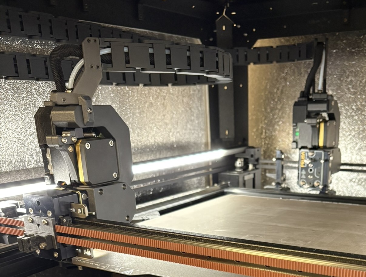

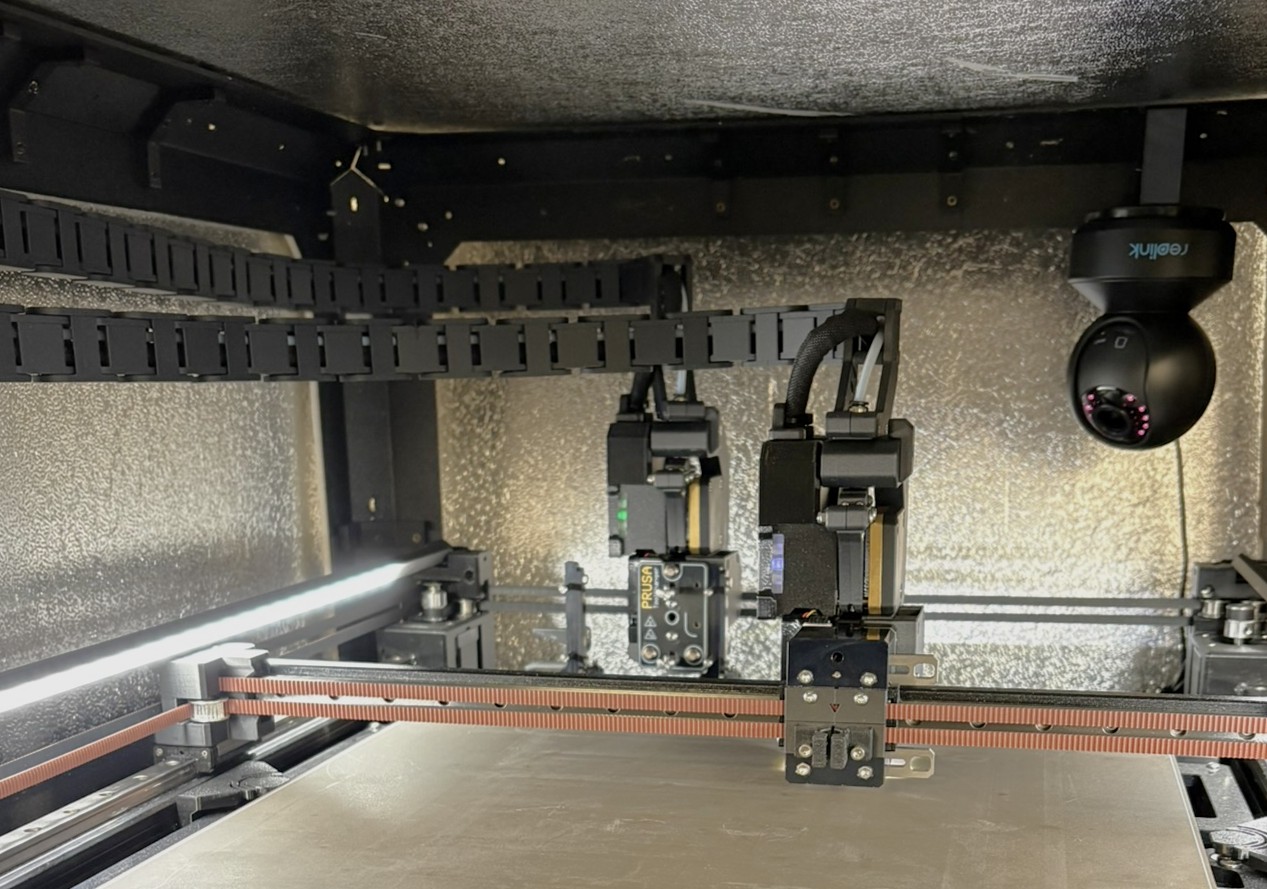

Ultimately, these reasons were what prompted me to modify my XL as well.
When I was looking to buy an XL with an enclosed enclosure, the enclosure itself was what put me off the most. My second concern was the brackets that run from the printer to the toolhead.
After a year of work, this is what I came up with:
A horizontal drag chain mounted in stages. For now, it only works with two or three toolheads, but I’m currently designing a version for all five. Why did I do this? Because I wanted a more compact and aesthetically pleasing enclosure. A lower and deeper ceiling height reduces the volume that needs to be preheated. I liked the Prusa MK4 enclosure best because I was able to extend the profiles very easily.
The original goal was to convert the Prusa XL to HT and then use that knowledge to build the Core One on top of it. Now it’s turned out exactly the other way around, and I’m glad about it.
PPA-CF can be printed with the Prusa XL—I've tested this successfully, and I'm sure others have as well.
