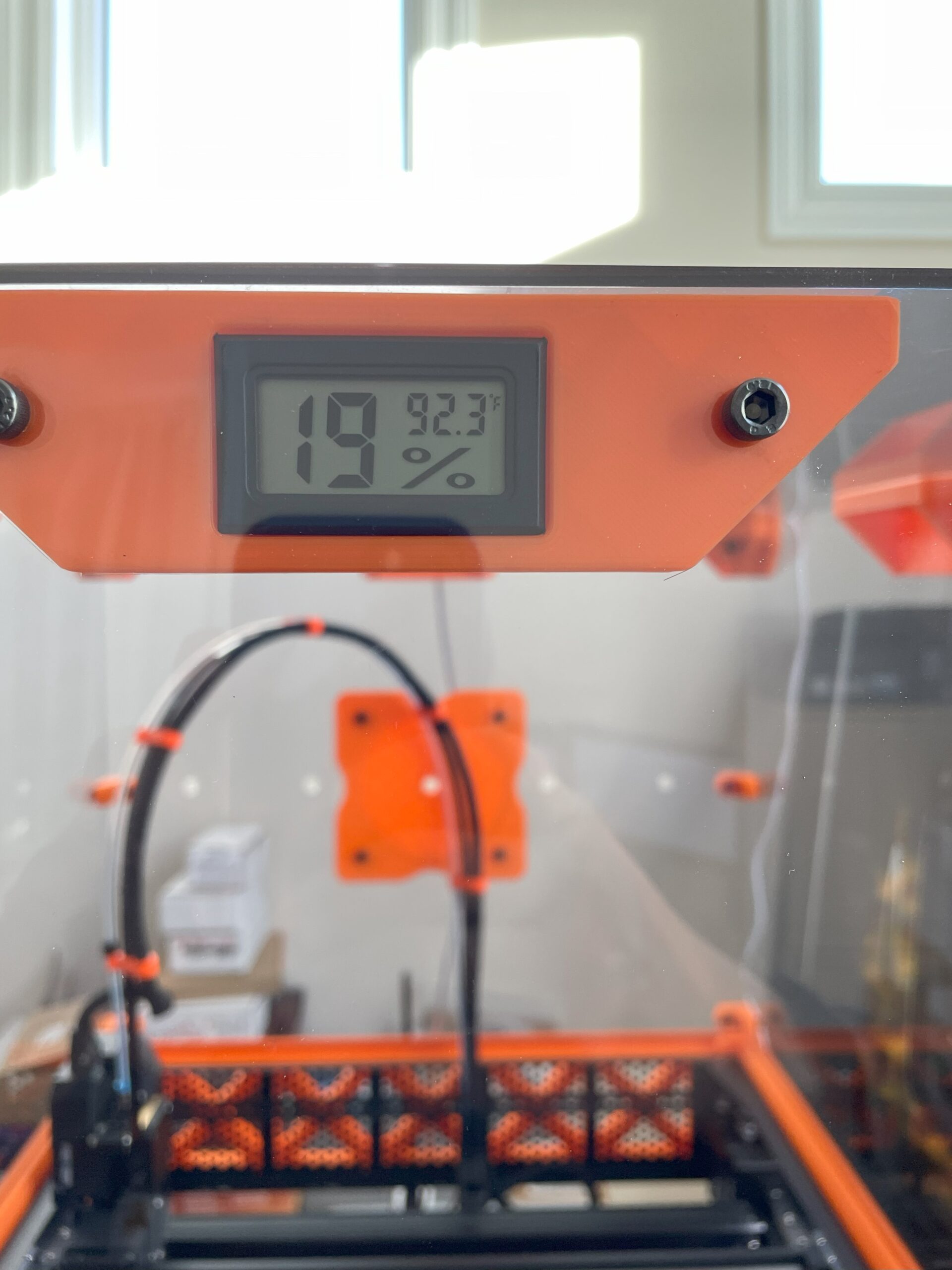

I jus finished my fully enclosed XL and I am seeing the same issue. My enclosure temp is stable at 40c  and about 2 hr into the print is noticed that it had stop extruding and the printer continues to print.  After inspection I notice the same gear marks in the filament, my first thought was Heat Creep,  I am using ASA with fan off, bed temp at 105c and nozzle at 250c.

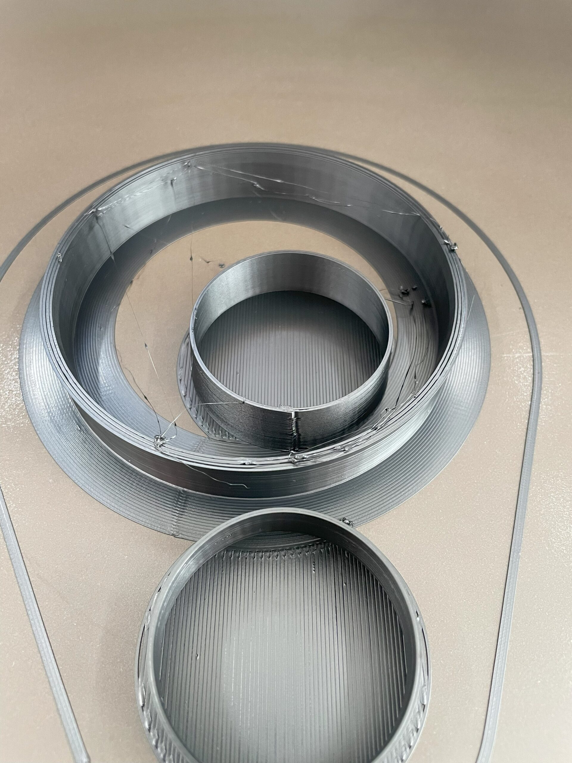

Looking for a little help printing ASA I have no problem printing it in ABS,  This is a picture of the fail parts, also how can I add my PrusaSlicer file to this post
 At this temperature 92 F in the enclosure the filament stops wanting to feed, I dont undstand this since I have no issues printing ABS and the enclosure temperature is between 103 f to 106 f  while printing the ABS.

Jump over to my enclosure thread. Maybe some of the information given will help. I print a lot of ASA

Update:
After further  review I decided to raise my nozzle temperature to 260°c thinking that 250°c was not hot enough, causing high enough effort to slip the drive wheels.  This has solved my problem I have now been printing for over 2 hr with no issues.
