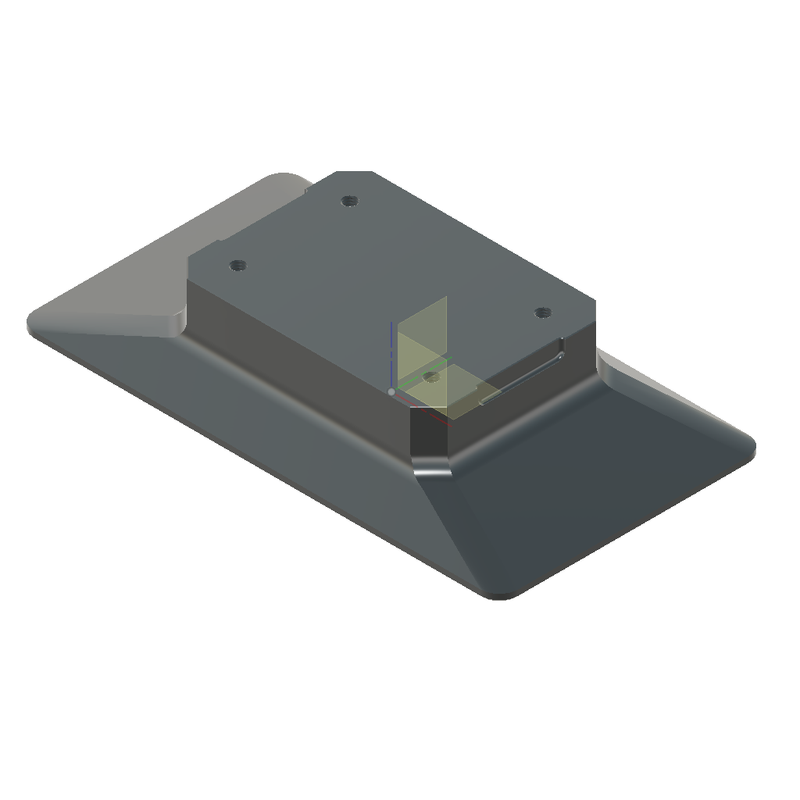

I opened this because I don't find an SL1 repo jet.
Please feel free to add your own suggestions or share your opinion.
My fourth print is now running on the machine and meanwhile, I've noticed a few weak spots.
  • Resin accumulates on the flat top side of the print platform. With slanted surfaces, as with the Elegoo Mars or the Anycubic Photon, the resin could runoff.
  • After printing, the print platform is wetted with resin up to a few centimeters. This makes it difficult to grip. A removable grip tool would be very practical here. This could possibly be achieved with a few matching grooves in the print platform.
  • UV light emits under the door of the CW1. If you would insert a step there, the door would be better positioned and leak-proof.

Hi guys and girls,
I have drawn up a new print bed in Fusion 360 because I am running into the same problem that resin stay's on the the top of the print bed. I have sent it to a CNC milling company to be milled out of aluminum.
When Its done I will sent it to a surface grinder to grind flat and then anodize it.
When it works I will let you know and I will c if I can produce more.
Regards Ron
PS the forum took the picture out of proportion it looks lower then it actually is, I took measurements form the original and added the slope to it.
This post was modified 7 years ago 2 times by Ron
Posted : 10/11/2019 11:56 pm

@ron-k4
Interesting idea.  I have a small CNC mill and may try making a similar part if I go with a Prusa SL-1.
