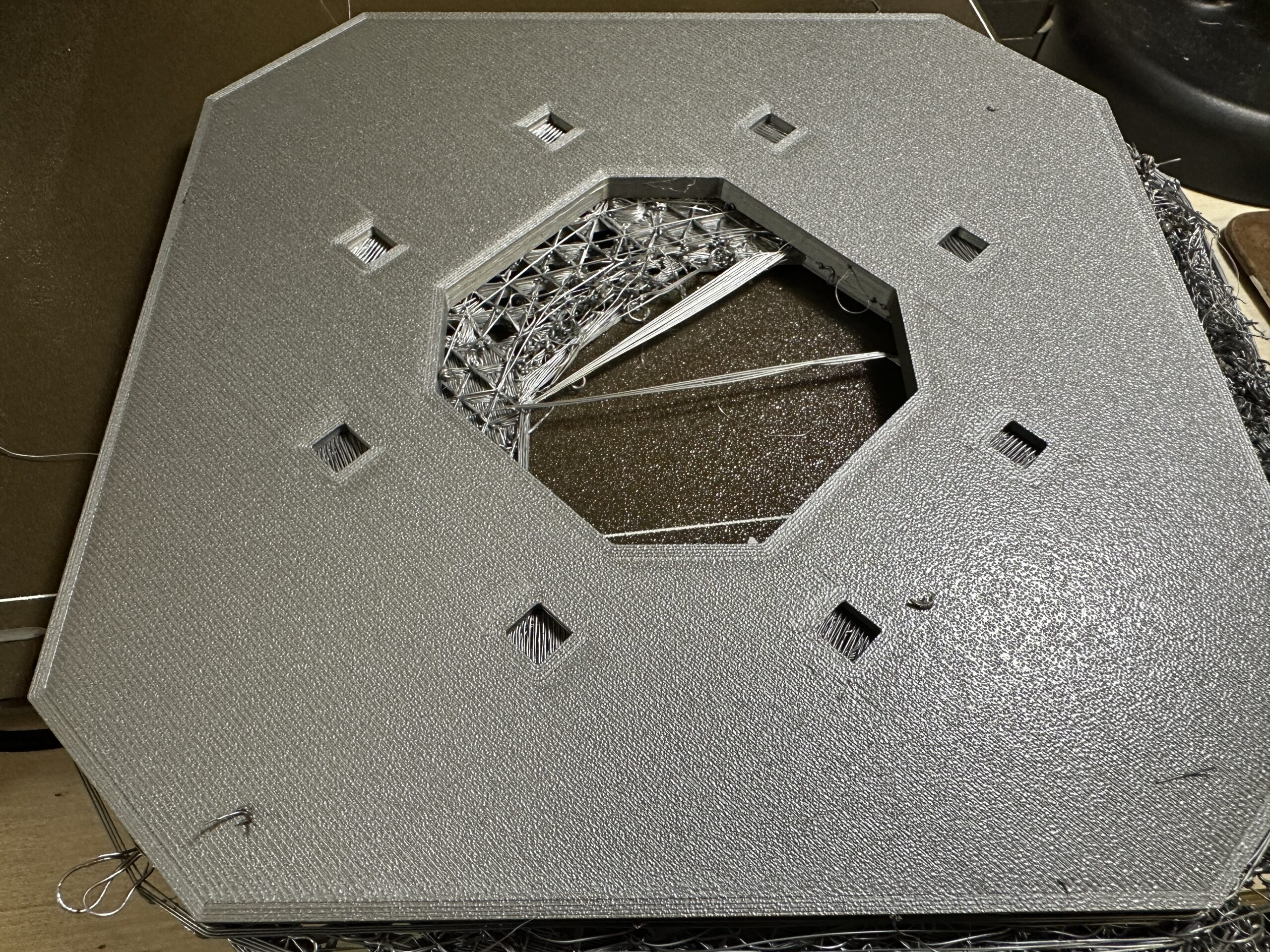

This one is printed in PETG with 50% gyroid infill 50%
Also PETG 50% gyriod infill. Note that these two had minimal shifting. Shifted just at one layer, both of them at about the same level, between 30-35 layers in.

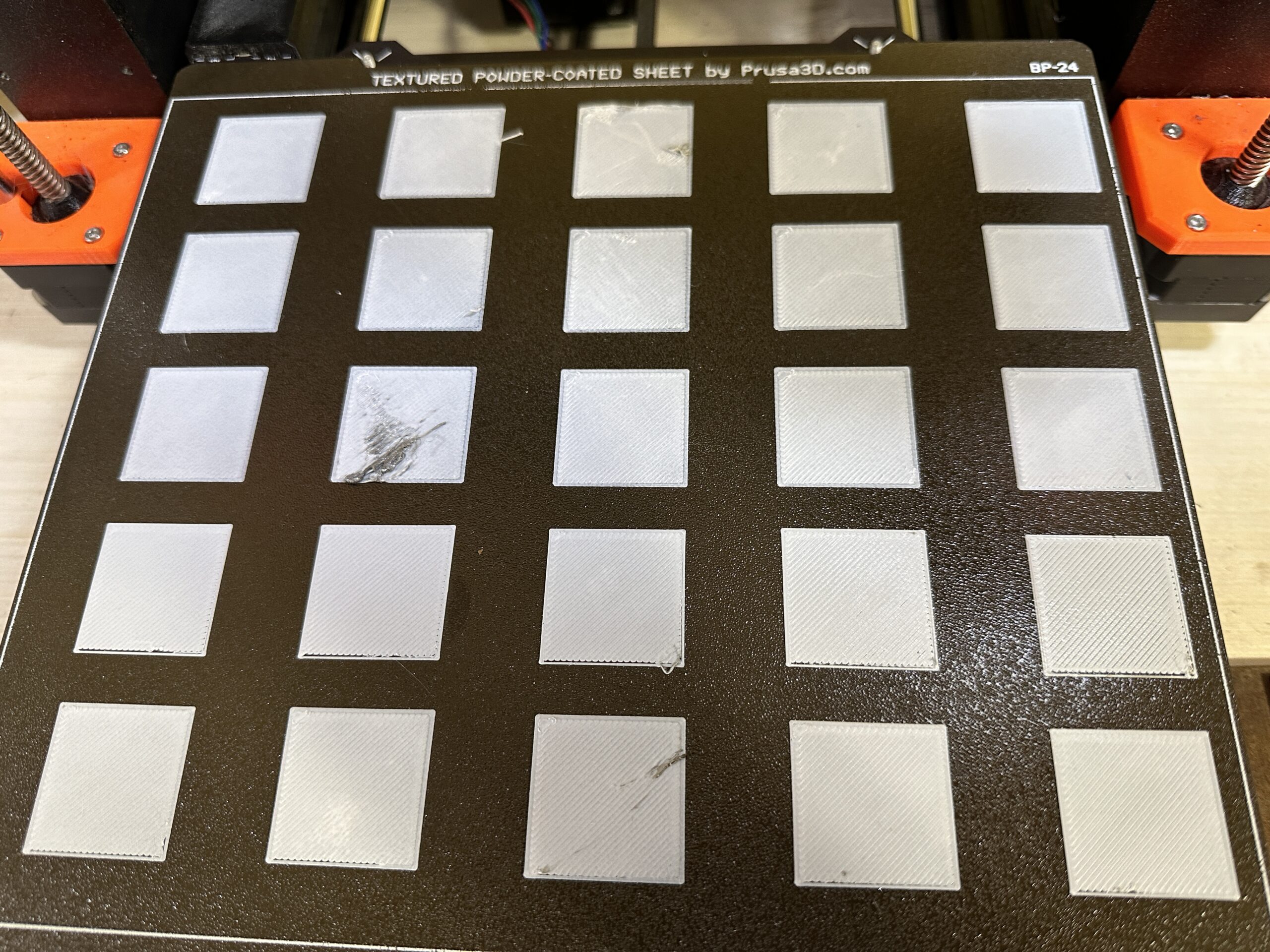

PLA with 40% grid infill. I was beginning to have extrusion issues here, which you can see by the uneveness of the coloration on the bottom. This shifted at least 2 times.
I'm thinking the warping sounds like a good candidate for the cause for this. With the gyroid infill, the warping is always at the same height, within a laye or two, and the shift could be just enough so warping isn't an issue after that. With the grid infill, there always seem to be at least 2 shifts - and then I usually am able to stop it. (Since it can take 1-3 hours before the shift, I can't always be here to watch the test prints and one time I was here, and listening to the printer while working on another design and didn't hear anything like a printhead or printbed hitting an obstruction, so it wasn't an obvious sound of the "Hey, it's not supposed to sound like that" type.
Since, from what I'm reading here, grid infill is more prone to warping, it looks like, with grid infill, that it's putting down a few layers (not that many), it warps, so the layer gets offset, then it does a few more layers, and, with them not being right on top of the previous layers, aren't bonded to what's below them (at least not too well), so after 1 or more layers, there's more warping and that causes another shift. (Now that you're talking about warping, when I look at the third photo I posted (in the 1st post), I can see how the layers warp where they're not attached to the layer below them.
I've used a glue stick in the past, on the satin steel printbed, and it's helped with some issues, including warping. Until this thread, I never thought this was from warping, so I didn't think to try that. I know the textured sheets have some issues the satin ones don't. Can I use the same glue (same type as the one Prusa included with my original printer) on a textured steel sheet for PETG? If so, this seems like such a strong candidate for the problem that I'm willing to go on and test it with glue as soon as I can.

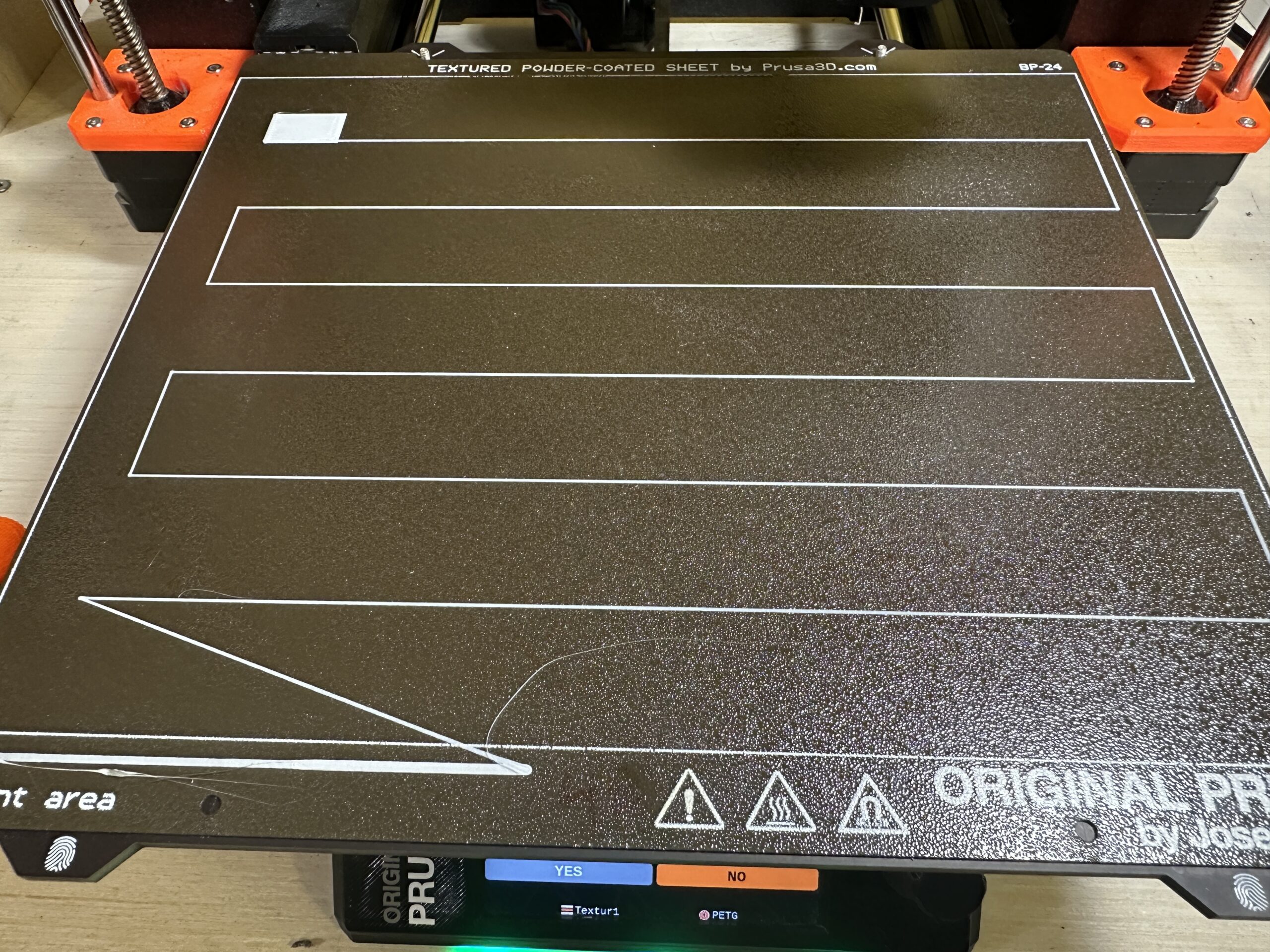

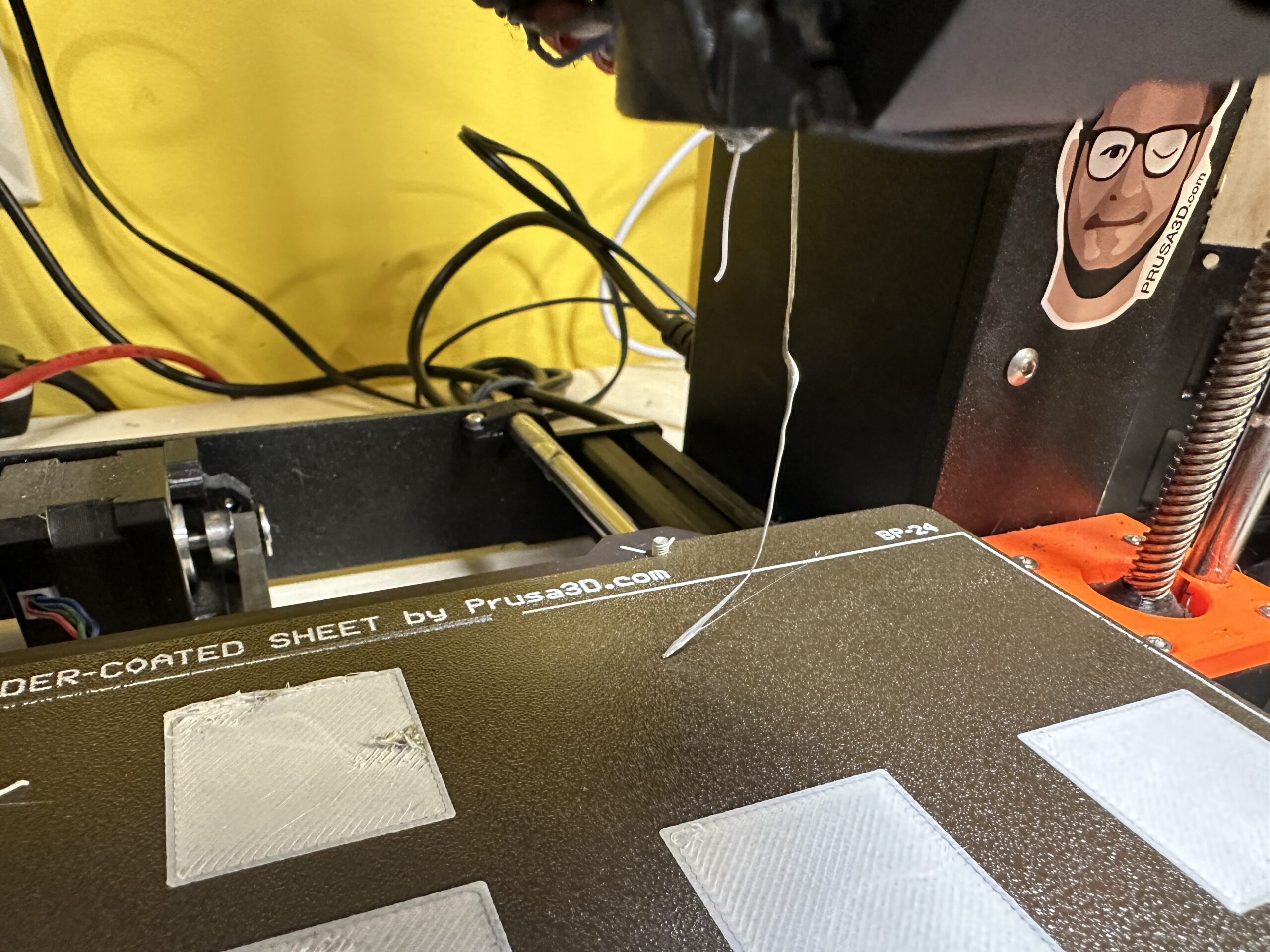

And we have failure again. Ugh!
I used a glue I've used before and had success with and started a new print with PETG and 50% gyroid infill. My wife and I then went out for the evening. We came home and I checked with OctoPod and it looked good. Then I went down to the barn to babysit it, since failures for the gyroid infil tended to be between layers 30-36. I checked regularly (kind of boring actually sitting there watching it directly for an hour or more!) and listened for odd noises. Heard something at one point, but checked and everything was working. Later, around layer 21, I got up and checked and there was a glob of filament sitting on top of the current level. I use snips to cut it off, so it wouldn't block the printhead from moving or make it hard for the printbed to move. While doing this and after, I watched to be sure it was okay and that my actions didn't knock the printer movement off at all. Things were okay. It was still moving within the layer, where it should be. After I sat back down, it went to the next layer and I checked just a bit in and this is what I saw (photo taken after I stopped the print):
So it was okay until the layer after the blob. I don't think it was the blob that caused the offset, since I snipped it off during printing of a layer and that layer finished printing normally, even after I snipped off the glob. Here's a closer shot of the blob:
Looking at it closer, it would seem the blob is in the right place to cause the shift, but I doubt that because of the direction. However, look at the perimeter in the center: It looks like the front of the center permiter was put down in place, but the back of it is shifted back. Also, the front perimeter seems to have shifted back more than the back perimeter has shifted. (And I've done nothing to change perimeter printing, so it'll print the perimeter of the center, each hole in there, and the outside as one unit each - it doesn't print part of one than do another, then come back to an earlier perimeter.)
I also note that only part of the new layer has been printed. You can see lines to the right of the center opening that are darker than the rest - that, by feel, is higher than the surrounding area and seems to be what's been printed on this layer, but there are loops hanging over the back end, as if they are from the previous layer. Again, when I snipped that filament blog, I was checking to make sure it didn't shift the print. I had matched the print bed motion and went back and forth with it a few times before finally cutting the blob off while matching the print bed motion.
Here is the bottom of the print. Ignore the messy part in the squares. I have it print across those holes, so there's some bridging issues, but, by doing that, I get a better result for that area. The square holes are where the nuts go and the round holes for the screws lead into them.
Before removing the item, I checked to see if there was any indication of warping. I tried to slip paper under it, especially in the front, and there was no gap between the print and the printbed, so I don't think it warped at all. (Unless it warped, then flattened out again and stuck to the bed again.)
It's quite possible what I saw and assumed has messed with my observations and I could have wanted or expected to see something and interpreted it wrong. I still have the print and can take photos of any parts that migth be of concern.
If it's the blob, that would explain this failure, but then I'd have to be getting the same kind of blob in about the same place on the previous prints I did with gyroid infill. I doubt that.
So any ideas? Any thoughts on the blob that appeared and how to prevent that in the future?
While I want to solve this, it's taking a lot of time, so I think I'm going to try PETG at 25% gyroid infill and see what I get. If it works, I'll use the result because I just need to get that part in place. But I think this is a significant issue and really want to debug it!

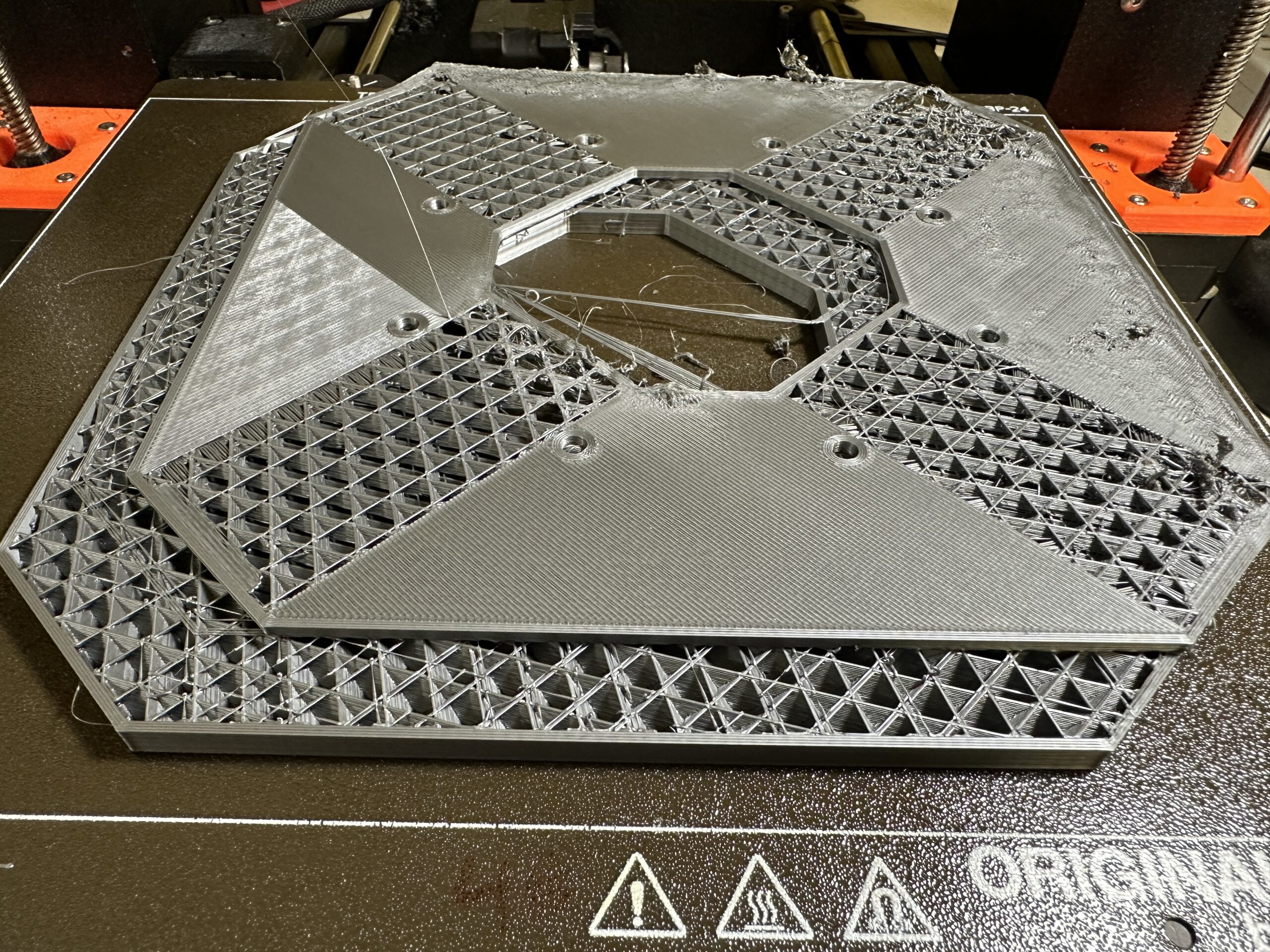

*sigh*
Is it time to have my printer exorcised? </scarcasm>
This was PETG, 20% infill, 4 perimeters, cubic infill, no glue and a clean textured bed:
Note that it shifted in 2 directions. Also look at the front left closely. It started to do a shifte layer there, then shifted again (apparently partway through the layer) and did the rest of it (before I stopped it) with more of a shift to the right. I didn't see it on the machine, and see, in the photo, a shado that indicates it warped in the middle and that part of the right rear around the center hole is above the printbed. I'm not sure that's the case - looks more like just a shadow. After studying the photos, I put it back on the bed and got the same shadow and didn't feel a gap there.
The debris on the bottom wasn't there at first. There were extra bits of filament all over after this failure.
I'm wondering if this is an extrusion issue. I was having some problems with filament coming out unevenly or too thin, so I ordered a replacement hot end and installed it and was getting much higher quality work when I did that, so I would think an extrusion issue would be a slim chance.
I have one print I did in PLA, no glue, satin print bed, 20% gyroid infill. I'd rather have it in PETG, especially, now, with the knowledge that more perimeters will help. There are times during good weather that I leave the shop doors open. While it's not a lot of light, I know PLA is sensitive to UV light and, from what I've read, is more brittle than PETG (and not as strong), so I'd like to still get this printed in PETG.
Also to note: The PETG is Polymaker, which has always done well for me in the past. Could that be an issue?
Even if everyone were to tell me, "The UV issue is overrated and PLA at 20% gyroid will do what you need," I still have this as an outstanding issue - for some reason my printer can't handle this. So either I'm slicing wrong, slicing using settings that aren't good for this situation, or my printer is having issues. I'd like to know just what will fix this. I can buy that printing a big piece that's too dense is a asking for trouble, and that some infill patterns have issues on bigger pieces, but if that's not the reason it's screwing up at 20% infill, I'd like to figure out what's wrong.
I'm thinking, since the PLA did okay with gyriod infill, to do that, but I'm using a LOT of filament and don't want to just be taking shots in the dark about what might work.
Along this line, if someone can suggest tests that will narrow it down - such as large squares using the different infills, I might be interested in something that helps me pin down the issue.
I'm thinking I should try PETG, 4 perimeters, 20% gyroid infill, and no glue, since that concerns some people here.
I can post a 3mf from the slicer, in case I have some settings on there that might be an issue, but I'm starting from a new project, and that uses default settings (I haven't changed them), then import my STL and go from there, so if I'm not listing a setting I'm using, it should be at the default value.

3-5 days ago I printed a PLA version of this, with the same settings (20% gyroid infill) except only 2 perimeters and it printed fine. Also, when I've used gyroid in the past, I didn't have nearly the shifting I'm getting in this print. That makes me think something is deteriorating and I've heard PETG can respond to humidity pretty quickly. I've put the filament I'm using in a drier and I'll run it through several drying cycles before trying again.
I've circled several filament globs in the photo and Im wondering if the globbing could be due to humidity. (I've printed other decent sized items in PETG in the summer, during higher humidity and haven't had as severe an issue with indications of filament issues, but I don't remember which brand filament I printed those items with.)
It's hard to tell the order of the blobs, but the ones I circled are big enough (I know it's harder to see in a photo than in real life) that they might have interferred with the printhead or printbed motion. I see the initial layers are okay, but it doesn't look like it printed the normal 4 layers on the bottom before it went to gyroid fill. (I checked, that setting is for 4 layers on the bottom.) It looks like the very first infill layer shifted a bit to the left. The next shifted back and the 3rd layer with infill shifted more to the right. it looks like there are full inner and outer perimeters for the shifted layers. On each layer, the inside perimeter goes down first, followed by the eight square holes that are for nuts that are at the bottom of screw holes. Some of the perimeters for the square holes are messed up. I've seen this before, early on in a layer, when there was an extrusion issue and it took a while for things to smooth out.
Right now I'm thinking it's got to do with extrusion. The new hot end looks identical to the original one and non-dense prints have been okay and it's the same sized nozzle, but I'm wondering if there might be an issue with the new extruder. Possibly uneven heating? The problem started before I put this hot end in, but if it's a bad part, it might be making things worse.
After checking the belts and screws, I'm not sure where else to look other than extrusion issues, especially afer seeing a few blobs on soem layers.

I went through and didn't just test the belts, but recalibrated them and went over everything yet again, then tried another print and, for the first time, had a shift on the first layer and it's the first shift I can verify took place in the middle of a layer:
Note the blog on the back area, near one of the holes in it. Here's a closeup of that:
I'm not sure if that caused a shift or not, but it was soon after that the layer shifted backwards.
This globbing is a problem, but I also don't know if that's what's causing the shifts. While I'm in the room, the 1st layer takes about 30 minutes to print and the next 3 layers take a long time, too. I am usually at my computer and keep checking the screen on OctoPrint, but it's really hard to just stay focused and staring at it for a long time! (I'm beginning to think I'll have to do that to track this issue down.) I realize the shifting may come from a blob blocking motion, or the two issues could be totally unrelated.
I'm pretty sure now the globbing is either extruder or filament related. After this problem, I checked the Z-offset for this steel sheet and it was okay:
Still, I did yet another belt recalibration and checked for anything loose otherwise. Then I used my own print job for calibrating the Z-offset. I have a 3mf file of a 5x5 grid of 30cm squares. It starts at the front left, prints a square, raises the printhead for 5 seconds, so I can inspect what was just printed, then lowers it and prints the next square. It goes from left to right, starting at the front and moving to the back. This is so I can easily track adjustments I make when calibrating. (I also have a page I made up in LibreOffice to make it easy to note down the offset on each square and mark if it was good or bad.)
Here's the 5x5 grid I printed after recalibration - and I think this shows an issue with extrusion:
Again, start at the front left, do each row left to right, then move back to the next row. The issues I saw are on squares 3 (row 1, column 3), 12 (row 3, column 2), and 23 (row 5, column 3). Note that this is printed with white PETG, and the globs on these squares include gray filament - the kind I was using on my item I need to print. So even when I clean the nozzle and change filament, and purge it, there is still some of the previous filament left in the printhead, somewhere in there, and it tends to come out in a blob that can cause issues. This is something I saw when the printhead raised up after the 23rd square:
It maybe hard to see the color change there, but the filament is gray where it comes out of the nozzle and down to the bend in the filament. And this is *after* it's been printing most of the test pattern in white. I've used a needle tool to penetrate through the nozzle and into the filament path, then did the same from the top of the print head, hoping to clear out any mess in there.
Since the globs are all gray in this print, that makes it clear that somehow, when I change filament, some of the old filament is left in the print path and eventually comes out in a blob while printing.
