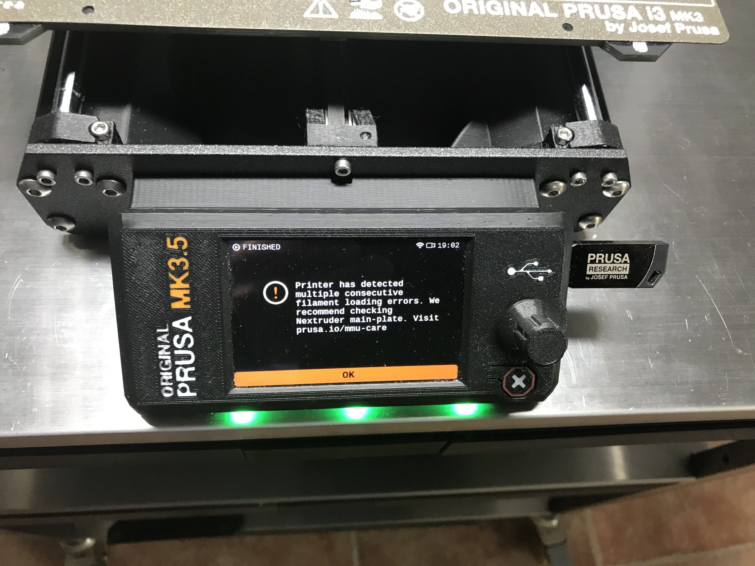

Hello all.  I have been using my mk3.5 with mmu3 for a while now and for some reason the printer has started to display the message in the picture above at the end of every print . The strange about this is that this happens even if I have mmu disabled and am using a pre loaded filament is single colour mode. I have changed the footer to show the status of the filament sensor and sensor on mmu3.  I am not having any problems or errors with printing or filament swaps at all everything is working perfectly it’s just that I get this message at the end of every print.  I have checked and re checked the sensors and they are working perfectly as far as I can tell and I don’t get any error messages coming up at all.  I would love to know how printer determines there has been an error does anyone have experience with the firmware they can look at the code and maybe give me some insight .  David

I get this too. There also doesn't seem to be a way of clearing it (via the settings).
Just going to do an upgrade to 6.0.1 to see if that has any effect

I get this too.  I thought it might have been due to an accumulation of loading errors when I first installed the MMU and didn't have it dialled-in properly, and that I therefore needed to reset that counter now that everything is running reliably.  Prusa Support told me that there's no such continuous counter - it only counts since the last power up - and therefore he suggested that I must have a genuine loading problem.  But as per the OP, this happens even if I'm not doing colour changes.  I power up, load a single filament without error, then print, and I still get the error.
I did do as suggested in the error message, and checked the main plate, and it all seems to be fine as far as I can tell.

I think if your mmu or extruder fillament sensor s3nses no fillament even for a second during printing you get this. On 6.0.0 i have never seen this and have mk3.5 mmu3.

I have been so fed up with getting this message and PRUSA have not helped so today I decided to bite the bullet and try a factory reset of all settings.  I previously did not want to go through setup again but the logic of this message being stored in non volatile memory makes sense .
any way I tried three prints with mmu disabled and filament pre loaded and NO ERROR MESSAGE was  displayed !
so I enabled MMU and tried a full five colour test print and the result was ….  NO ERROR MESSAGE was displayed !
so it seems that the errors are stored and no cleared after a power down as PRUSA a indicated to someone .
Hopefully this can be resolved in a firmware change sometime but for now I am happy with this as a work around

In case you haven't seen the other thread about this, @cupajoe24 has found an option in the firmware to clear this counter/bit.
There's a reset in "Settings > Hardware > Nextruder Maintenance"

The mk3.5 does not have this option

Ah, of course - Nextruder!

It's interesting that your MK3.5 generates an error message that's advising you to check the Nextruder main plate.  I guess the firmware developers could do with a nudge via github to change that message for printers that don't have a Nextruder, and to provide a UI method to clear the counter/bit that generates it.

Looks like it got raised and then closed as it was not raised in the correct repository
https://github.com/prusa3d/Prusa-Firmware/issues/4702
Trouble with being an edge case here, mk3.5 + MMU, not many people are noticing it
I will try and raise it in the correct repo when I get a moment. https://github.com/prusa3d/Prusa-Firmware-Buddy/issues

ok, looking further, it has now been raised in the correct repo and is 'scheduled' for fix
https://github.com/prusa3d/Prusa-Firmware-Buddy/issues/4113
