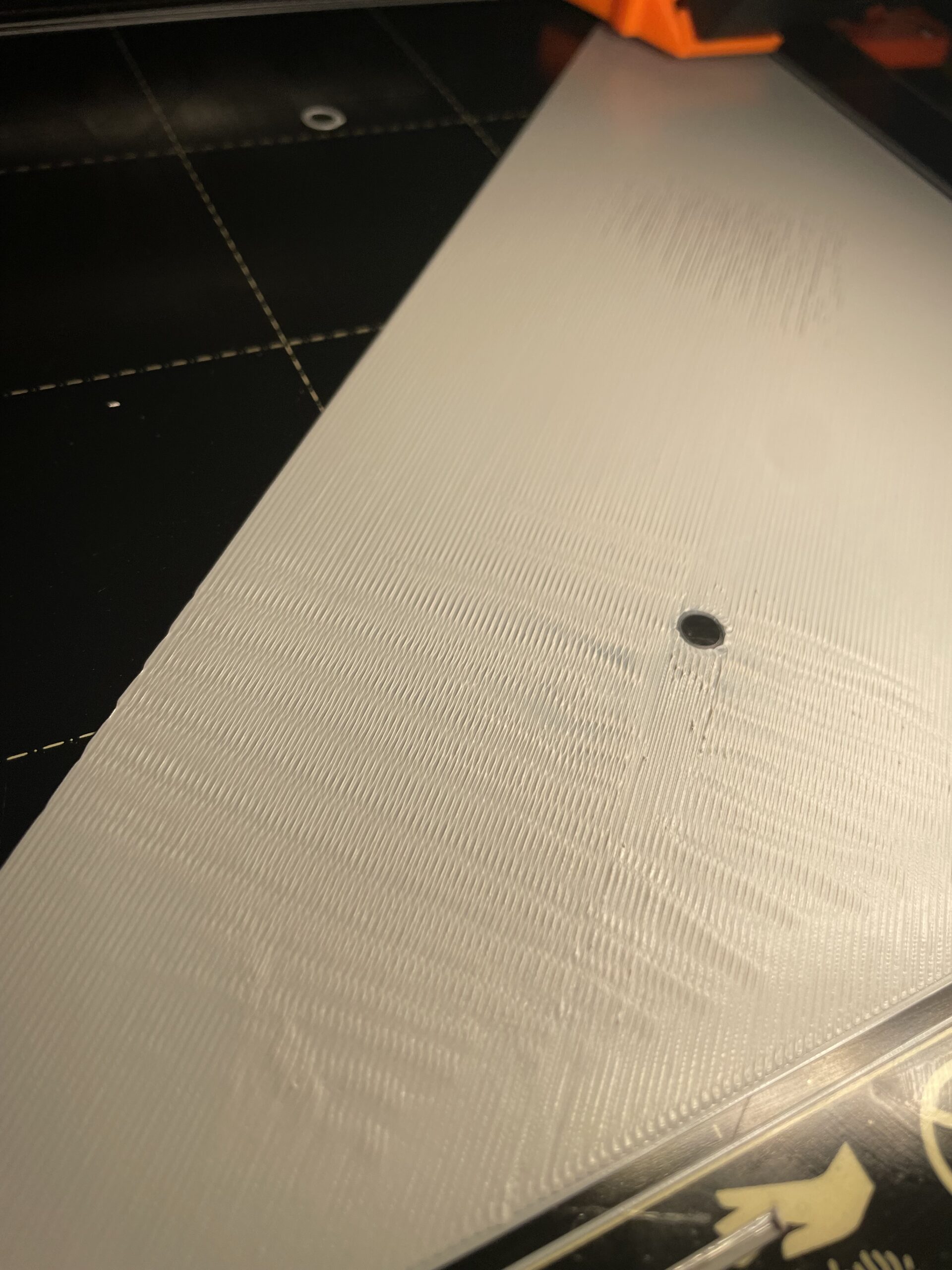

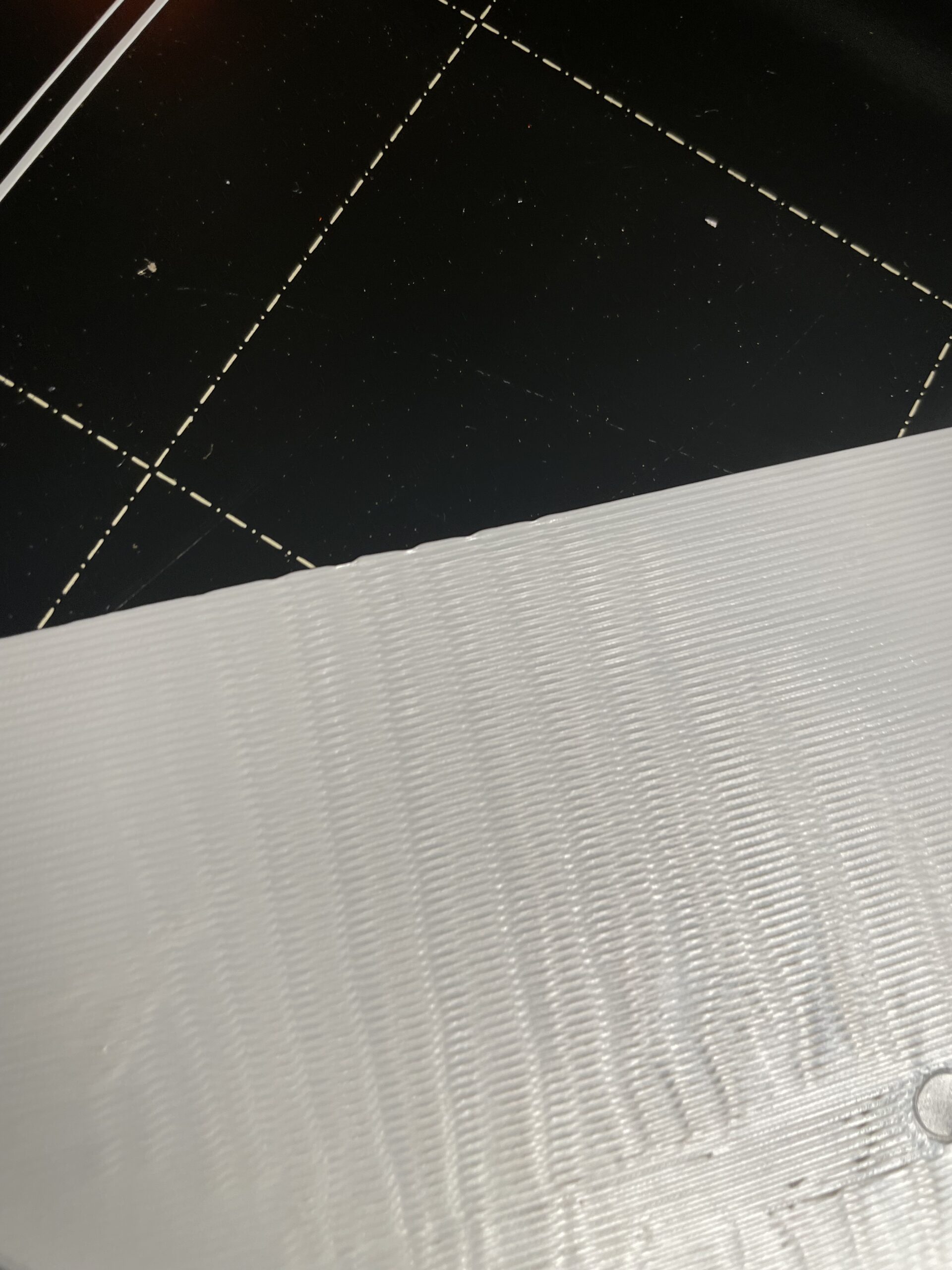

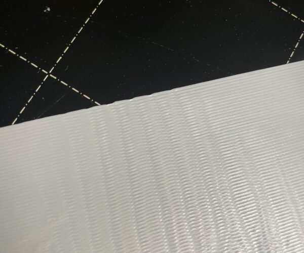

so I just put my MK4 and it’s running beautifully
but I wanted to get my MK3.5s back into shape  I changed the bearings in the X axis and Y axis and both belts  not sure if this is the filament or the bed  I did use magigoo on it  using hatchbox pla

That looks like Live Z is too low.
Re run your first layer configuration and that should go away

Yep raise your Live Z.  Mine initially looked like that too when I had it too low.

yes.. I found that I lower my Z until I see "waves" like you have.. then have to raise.
