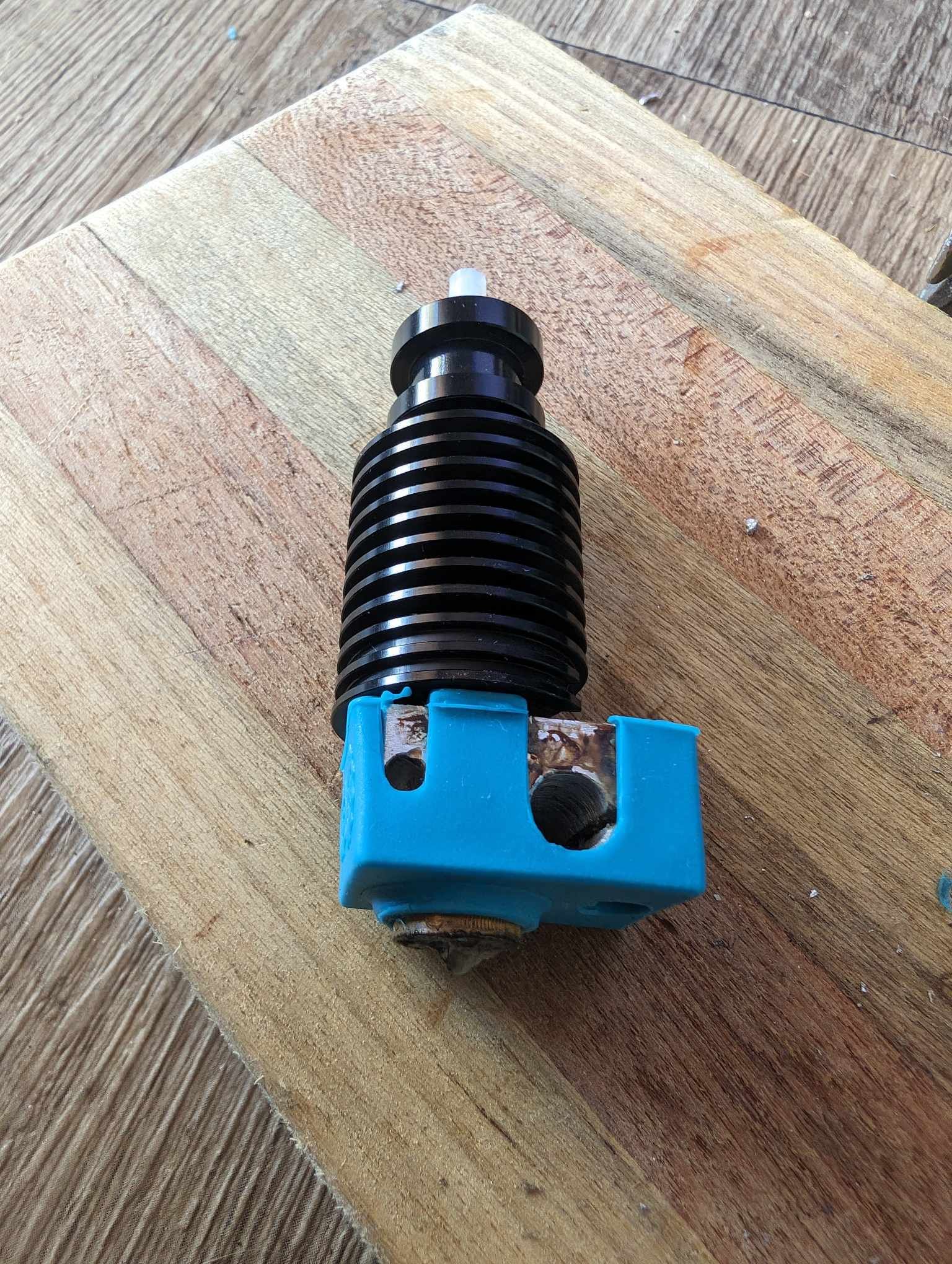

Nozzle heater check failed
Running self test and the nozzle heater check fails.  It gets to "Heater testing" and heats up.  Got to the upper 100's and then it just put an X on it and quickly jumps back to the test selection screen.  I'm able to run the first layer calibration just fine though.  The only thing non-stock on my hotend is that I have a E3D Copper Heater Block so I can only guess that has a slightly different temperature profile that it is unhappy about.

Looking at the code it has to hit 180 in 60 seconds.  I am at 178 when it fails and then after it fails and goes into cooldown it briefly reads over 180.  So I am only 1-2 short of passing the test.  This is very frustrating.  It appears I can not setup Prusa Connect either until I pass the self test.  Is that also why the firmware will not update on the WiFi module?  I tried wired ethernet as a workaround and the printer will not get the time and adding to Prusa Connect comes back refused.  Seems a lot might be tied to passing the self-test.  I can print though if I dismiss the warnings.

The the copper heat block it heats too slow, with the revo it heats too fast... Far out! Let us tune our non standard upgraded printers.

As my Revo died while my 3.5 kit was enroute, and e3d told me to eat a poop, I decided they're not getting anymore of my cash. I present my solution... Behold, the FrankenRevo!
Posted : 27/02/2024 2:23 pm
RE: Nozzle heater check failed
How did you create that?
how have you managed the heatbreak? is it revo, or did you shorten the revo nozzle to work with V6 heatbreak?

I just drilled a 6mm hole through an old heater block.
Posted : 28/02/2024 12:53 am

Just installed it and started running calibrations. Works a treat so far! Still failing the heater calibration though, I think the above thinking of it heating up too slow is flawed, as someone reported it working with the sock off. That to me suggests with REVO or a socked Al block with a sock, it's hitting the temp too quickly. Maybe instead of giving it a blast of heat, it needs to be cooled down during tuning? Perhaps take the socks off the REVO and give it another crack?
I'm about to take the sock of my FrankenRevo and see if that passes this bloody test, if not, will maybe hold a wet rag to it for a bit during preheat. I'm not sure if it's measuring simply time, or if it's measuring the ramp up curve to compare it to stock. Heat over time at specific intervals? Who knows!
