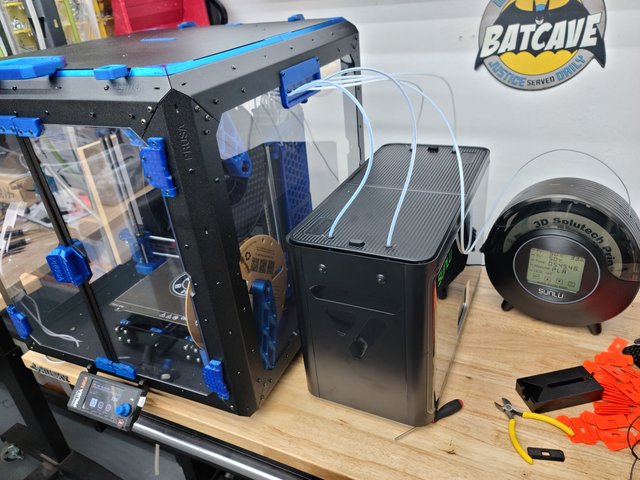

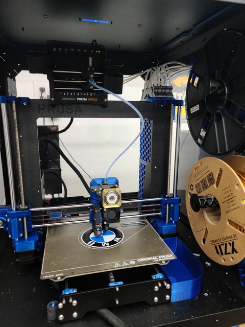

Still working on tweaking.. but here's my setup.
393221-extra-spool-holder-for-prusa-enclosure
676280-complete-modified-hinged-lid-for-original-prusa-en
https://www.printables.com/model/462269-magnetic-catch-prusa-enclosure-hinge
953671-loading-aid-for-the-mmu3-buffer-segment-r4
953614-mmu3-cassette-compatible-buffer-for-prusa-mk4-r4-c
903986-mmu3-filament-feed-through-for-original-enclosure
The modified buffer is very space-saving... and the loading aid works amazingly well to get the filament to the MMU3. I'm still having issues once it gets there and to do successful 'load to mmu' functions - I will likely print one of the modded mmu4 parts kits to fix my loading problem. Once everything was loaded into the mmu3, I did not have any issues printing.
I do use those SunLu dehydrators to positive results -- and recommend them.

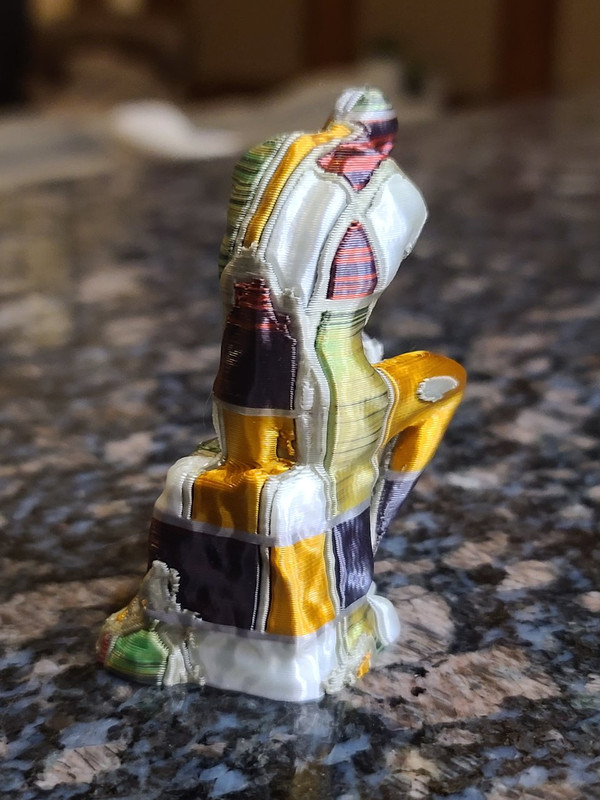

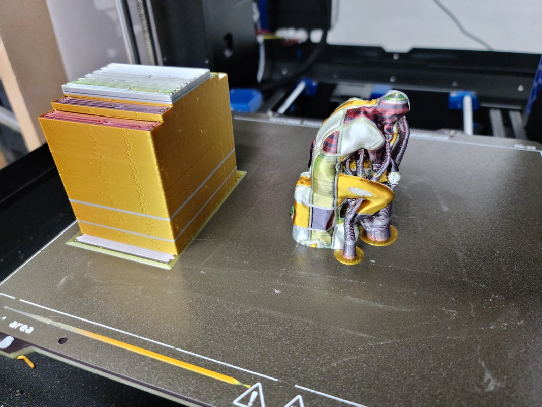

Loving this setup. 1000+ filament changes on Thinker_MC model at 50%... it's a filament hog, but with all of the filament in dehydration often less than 18% humidity, it prints well, doesn't string in the filament changes... very reliable... for an MMU
