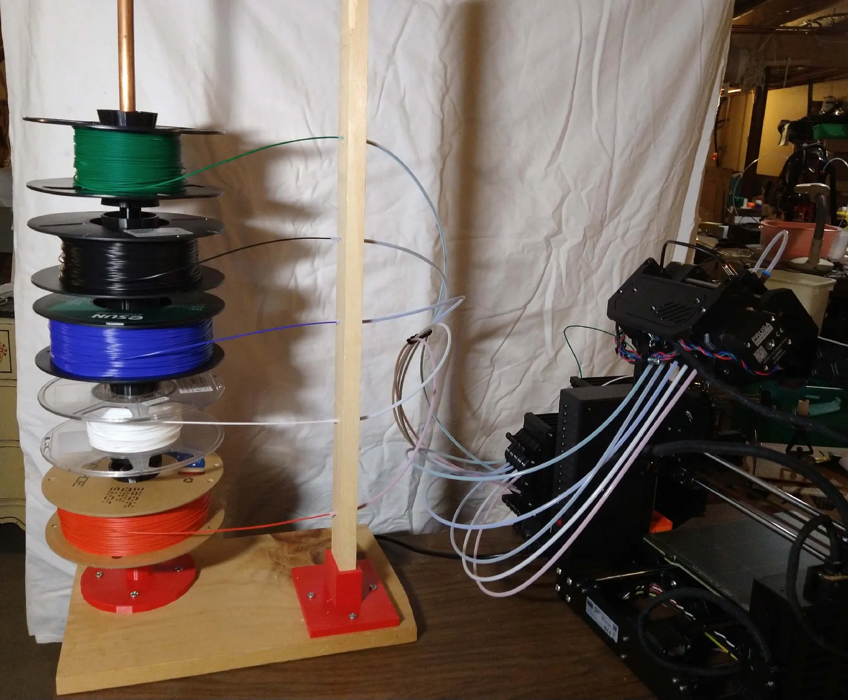

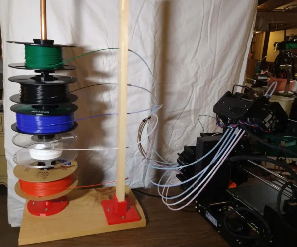

edringel
(@edringel)
RE: Footprint: is it worth it? An alternative
I wandered onto this topic by accident, but I had similar frustration with the amount of desk real estate needed to accommodate 5 spools of filament. I designed a vertical spool holder with some printed pieces, some scrap lumber, and a copper pipe. I've been using it for several months and it works wonderfully. The design is such that it could also be easily mounted horizontally on a wall or from a ceiling. The key design characteristics are twofold: First, the use of a tapered fitting that slides into the center of the filament holder. This accommodates various diameters and auto-centers the spool on the pipe. The second design decision that has worked out well is the use of bearings that are made for much heavier loads. This means that I can use inexpensive lawn and garden bearing rather than expensive thrust bearings. Files and BOM are at printables.com: https://www.printables.com/model/991249-vertical-fil ament-spool-management-system
