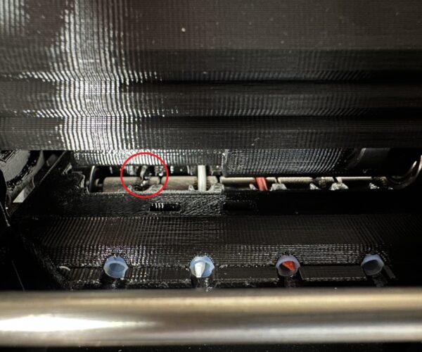

Hi, I just completed the install of my MMU3 upgrade on my MK3S+ and during initial tests, I am finding that when the MMU3 unloads the filament from the extruder, it pulls it past the Finda, completely out of the Front PTFE Holder and continues until the Bondtech gears cannot grip it anymore.  This happens during the Load Test also, it seems that whenever the filament is retracted from the extruder, it always overshoots.  However, when I choose Preload to MMU, the bondtech gears grip the filament, the Finda senses the filament and then the filament is properly retracted to the end of the PTFE tube, ready for printing.   I cannot find where you can either calibrate the length from Extruder to Finda or anything like that.  Any ideas??
The picture shows the black filament unloaded from the extruder during a load test while the red and white were loaded with 'Preload to MMU' menu command.
Thanks for your time.  Dave

Solved:  FINDA sensor a tiny bit too close to the ball, was not immediately turning off.  I should have used the LED in the sensor to set it instead of just the LCD display which has a delay.   Lesson learned

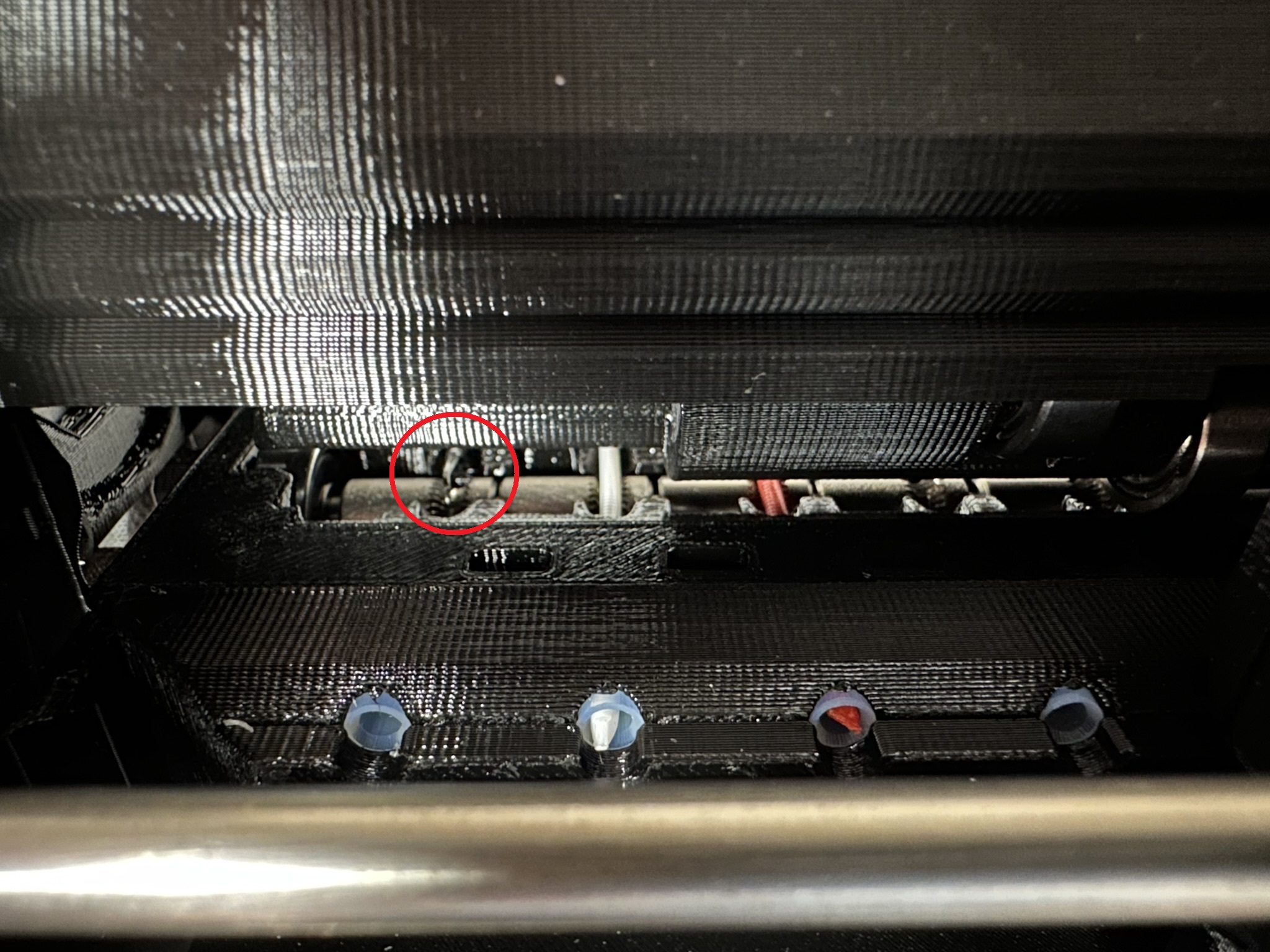

this old post also just ended a big headache for me as well. been fighting with loading problems during filament switches and discovered it was retracting like the pic above, about 1/2 to 3/4 of a turn out on the sensor and boom, works like a charm again..

I wonder how many problems with feeding and retraction are thought to be spools or buffer related, but are actually a FINDA that is 0.5mm too low? I'll give one extra tip, I think many people adjust the FINDA from the front side instead of the back side where the filament feeds from because it's easier to do. I couldn't get mine adjusted correctly until I switched it around.
