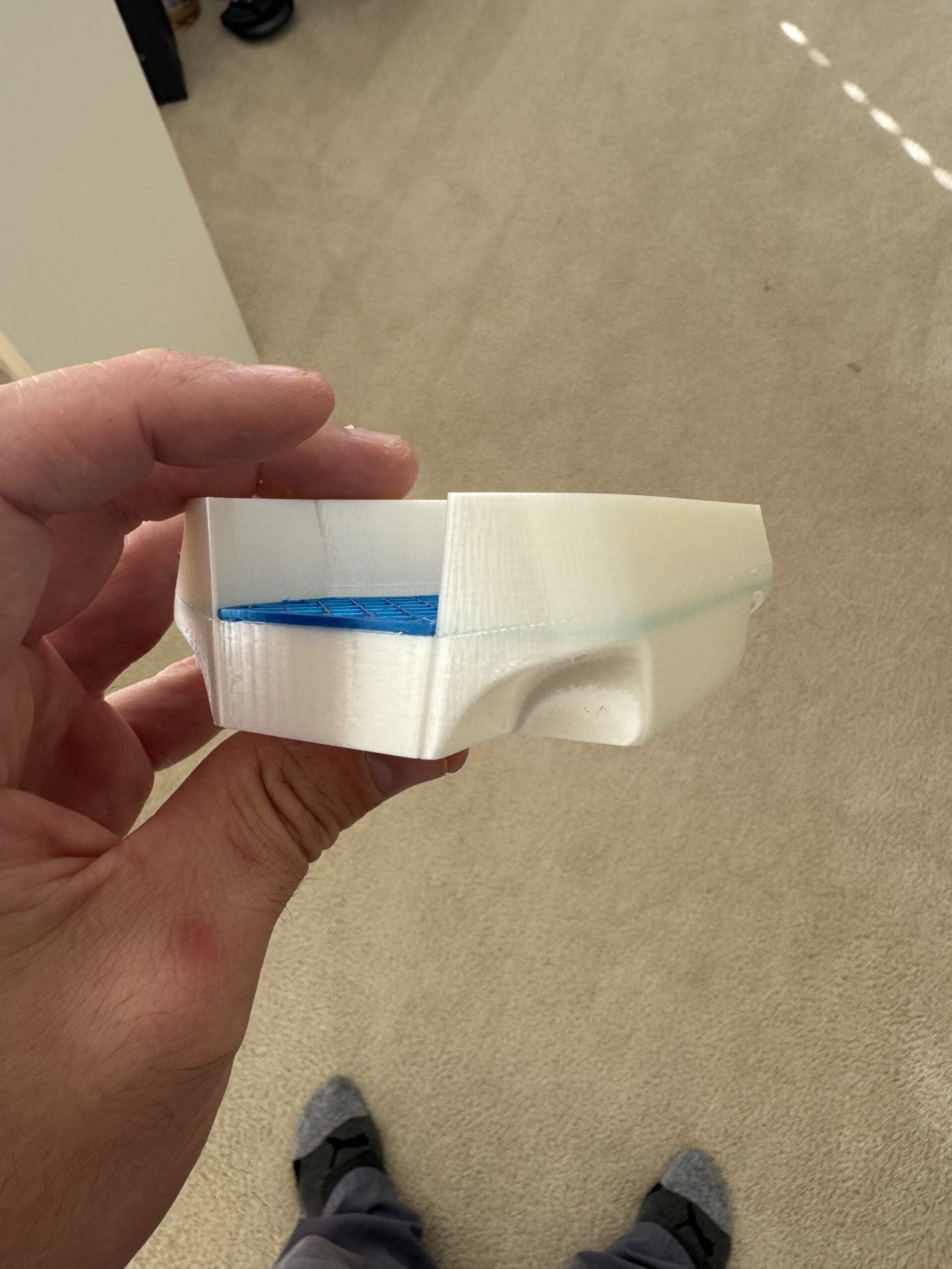

Looking for advice.
I have a wipe tower and my purge is set to 175mm yet im still getting color bleed. Any thoughts?

Up the purge volume to 300 and see what it looks like.    With some colors, it takes a lot of purging to get the dark color out the lighter one.
Another possiblity is that your walls might not be thick enough to prevent seeing the  darker inner  color from the outside.
