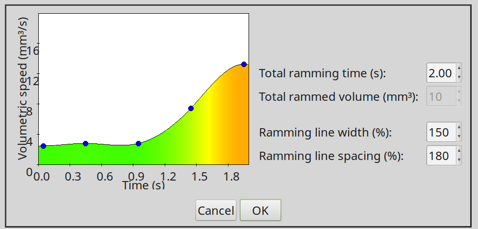

Anyone has ramming settings that work for Colorfabb XT?
PET one give me a big clump that isn't retracted properly in the MMU2 (so the selector fails).
Alternatively, how do I research good ramming settings? Is there a document somewhere?
Re: ramming settings for XT
Since no-one had an answer, I did the research myself. After a lot of iterations I now have this:
It generates a thin very good point every time for me right now. I think I should do the same rounds for PLA and ABS...
It seems like I can have very reduced purging too, I'm down to 40+40 and it seems fine.
Entire setup:

filament_ramming_parameters = "150 180 2.54839 2.70968 2.67742 2.77419 3.87097 6.35484 9.80645 12.4516| 0.05 2.47094 0.45 2.79996 0.95 2.83223 1.45 7.46132 1.95 13.2484 2.45 9.48391 2.95 7.53556 3.45 8.6323 3.95 7.6 4.45 7.6 4.95 7.6"

I did my test on cooling moves, set it to 2, didn't really help much. The filament's end is quite big and unable to go through the tube without friction. I have similar ram setting as yours with 1 cooling move, ended up having string leftover.
I'm on cheap chinese generic pla by the way. I also need to investigate ramming setting
Lower the temperature first. It helps a lot. Increasing the cooling moves causing for me usually more issues because the filament tip is cooled down and whatever was produced during the cooling move stays. With only one cooling move it leaves the extruder much easier.
Such a hard short ramming will most likely produce pretty thick filament tip.
