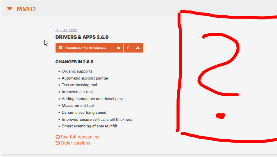

where to start? Got a new MK4. Thats why I updated to new Slicer Version 2.6.1.
STILL own an MK3 MMU 2. Have both available in the new Slicer Software.
After slicing for the MK3 MMU2, the MK3 printer says:
" New firmware Version available 3.13.0 - Please Upgrade"
Well - I DID . But than the says: Please update MMU Firmware ???
There is no new firmware for the MMU2 anymore.
I probably missed some news I guess? Is there a general firmware for all existing
MMUs ? Or no update at all for MK3+MMU 2 ?

As I understand some of the other posts, that is correct. There is a single firmware branch that has built in support for all MMU versions now.
...based on my own experience and a lot of the other threads in this sub forum, it doesn't seem like it works very well (or in some cases, at all) on the MMU2 or MMU2S, yet. But I imagine as more reports come in from people updating to the new firmware and slicer pairing, they'll get the kinks worked out.
