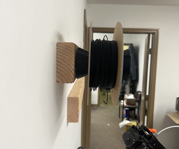

Hello,

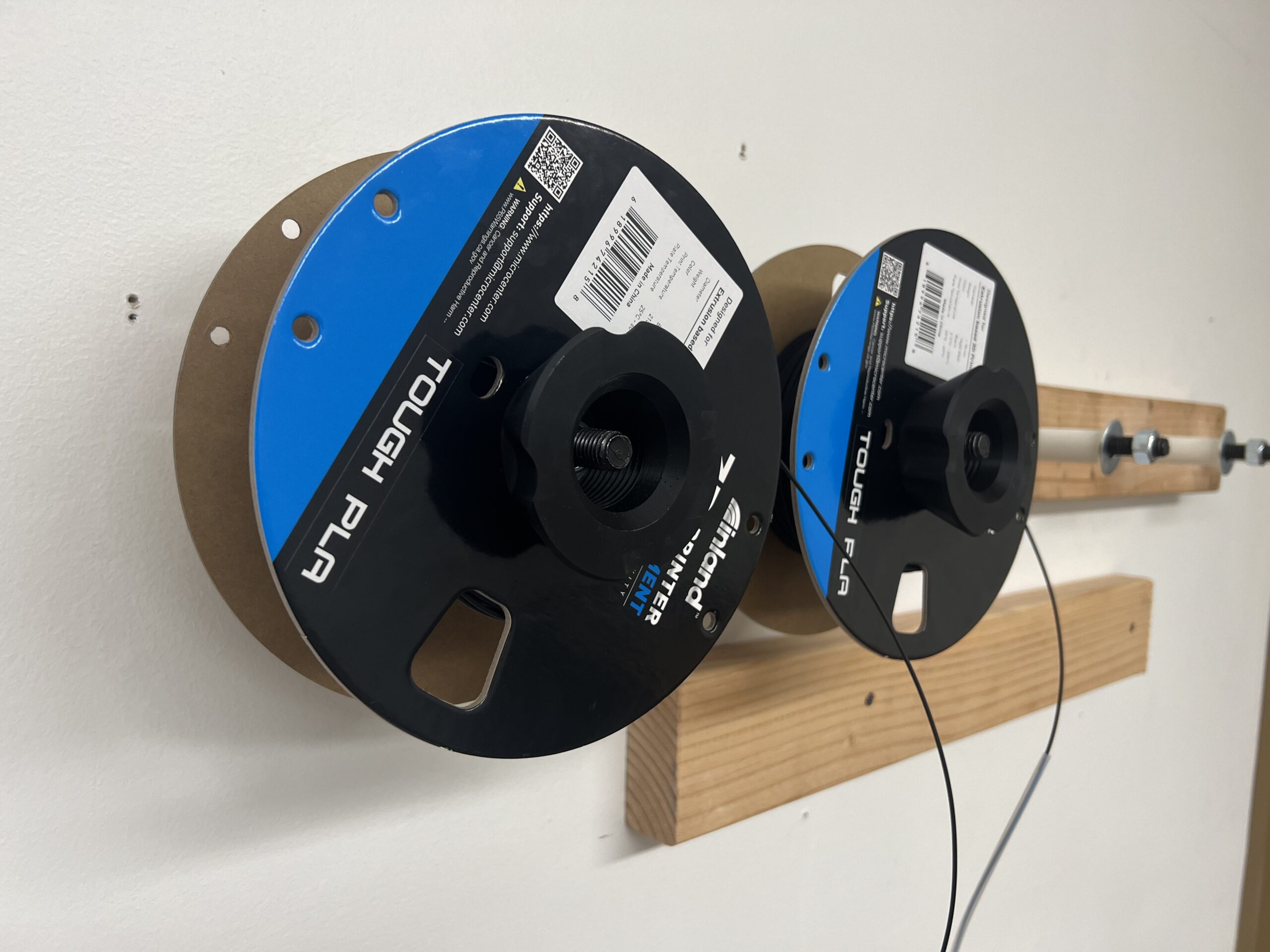

The small wheels have begun sticking, leading to significant surges in filament tension. My extruder starts clicking, intermittently at first, then more regularly, producing gaps in the prints, and ultimately failed prints.
I am working on a axle-based setup using these:
Spool Holder
The will be suspended on lengths of PVC pipe, affixed to the wall. This will allow easy access for swapping spools, and minimal filament tension.
Thanks. Brad.

Diem,
That seems like a maintenance item to me, and will always need addressing.
Truthfully, from an engineering standpoint, rolling on the rims of the spools is less than ideal, anyway. These small wheels have to turn more than seven times as much as the spool, and the axels are nowhere near a precision fit in the holder bodies. Plus, any deformation in the rims of the spool, which is very common, especially with the fiberboard spools, will manifest in variances in filament tension. Mounting these spool holders on PVC pipe is virtually frictionless, and only adds a minimal amount of labor to a spool swap.
Thanks. Brad.

So far, I'm very pleased with the performance of the new setup. I am in the process of printing a few more spool holders before finalizing the setup, but the spool I'm working from right now is working flawlessly. As soon as I get these spools done, I will be setting up to do a 26hr three color print that will, for the most part, confirm the viability of the setup. I'm currently working "open air", so my next adjustment will be an enclosure for the rig that will keep the active spools as dry as possible.
Thanks. Brad.

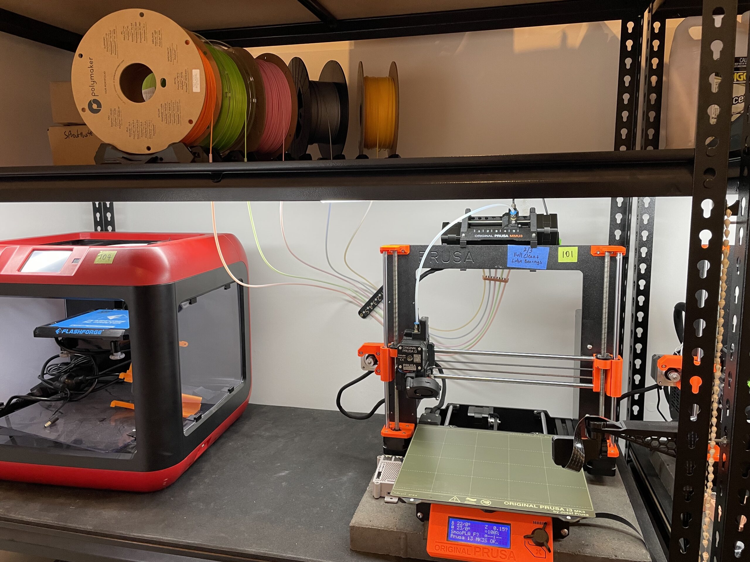

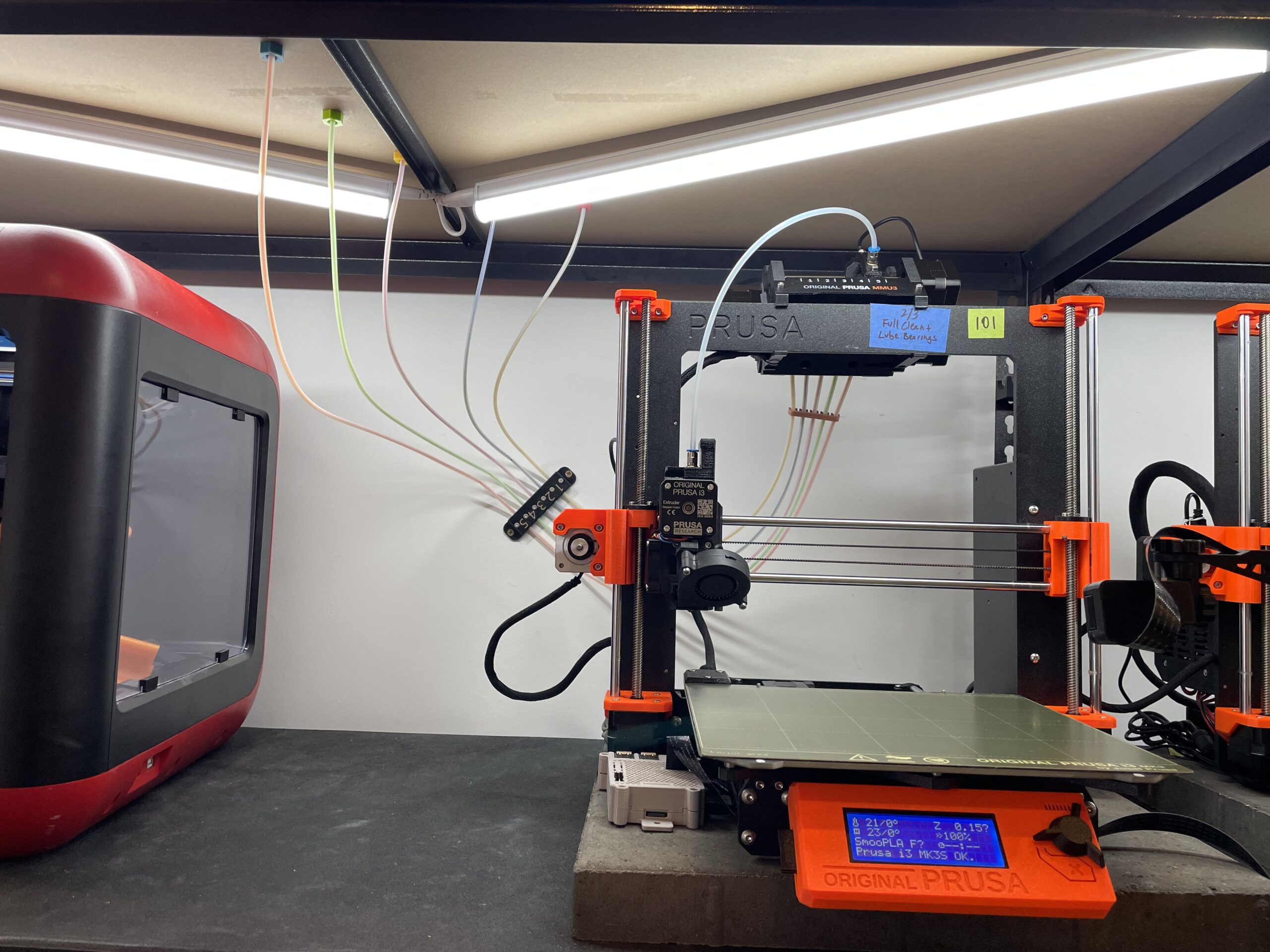

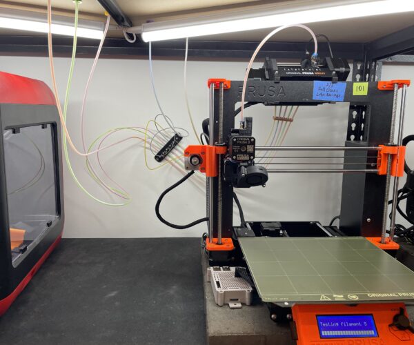

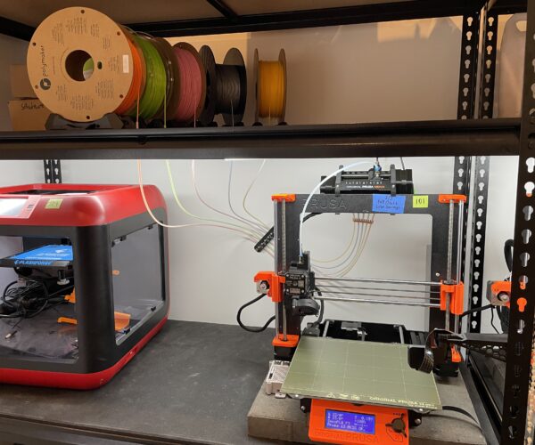

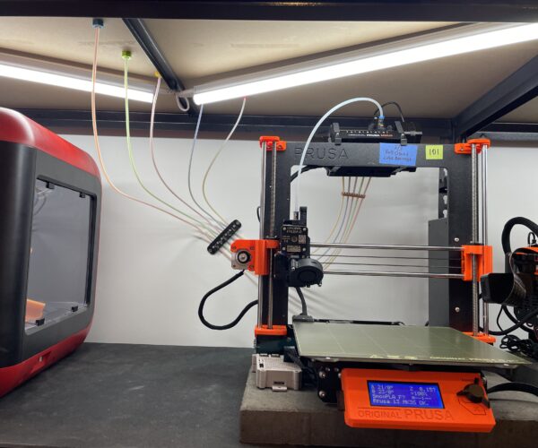

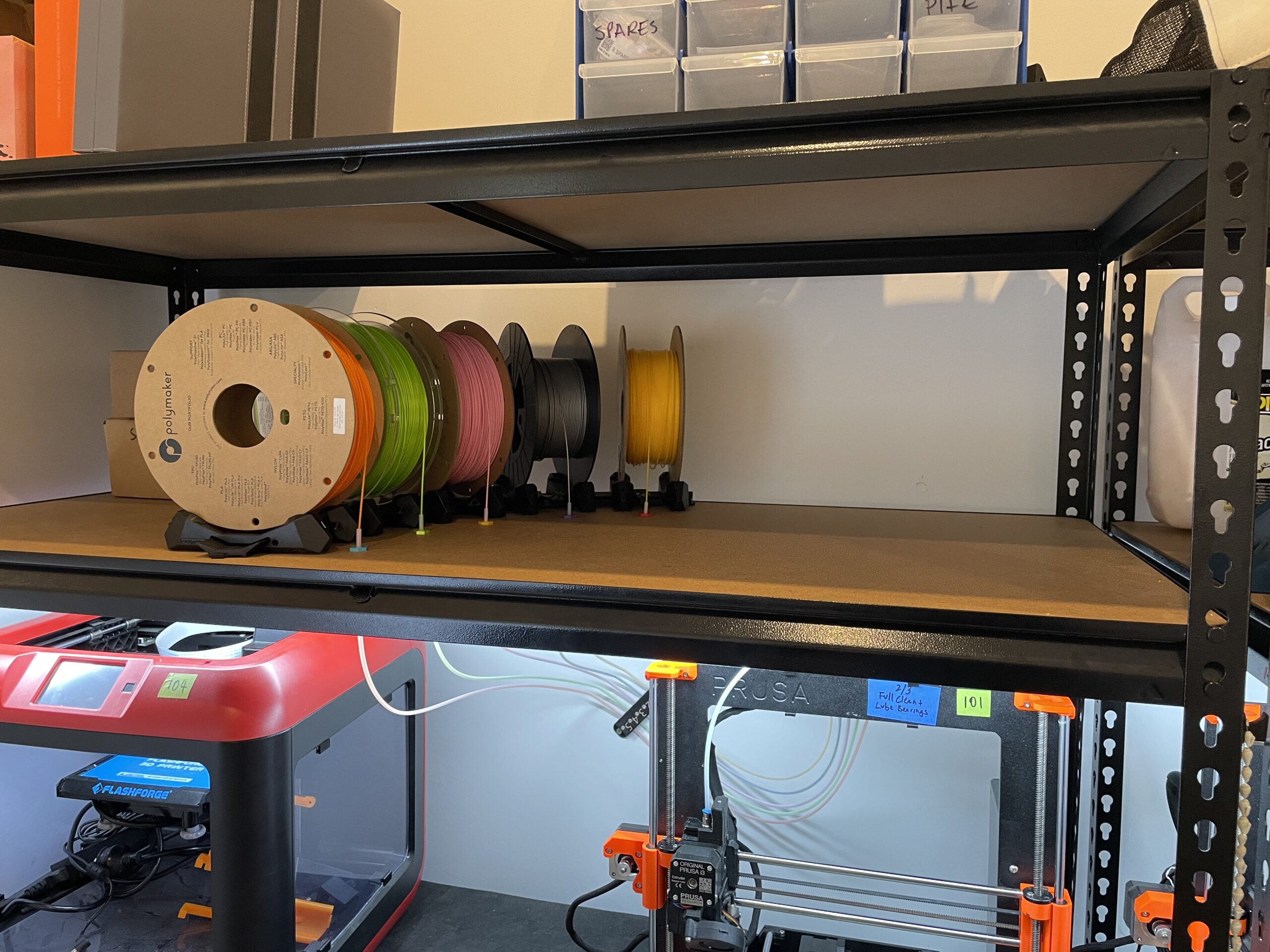

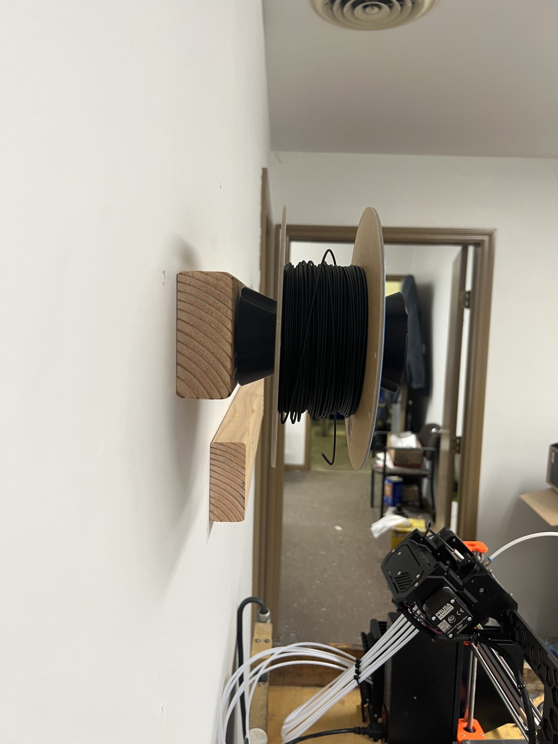

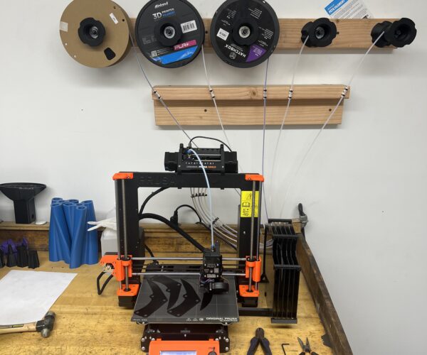

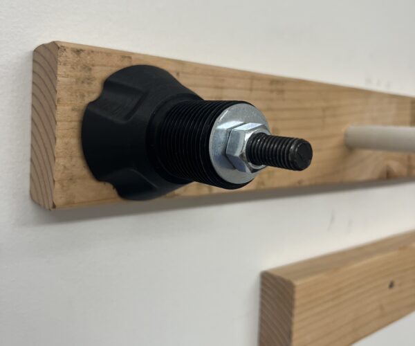

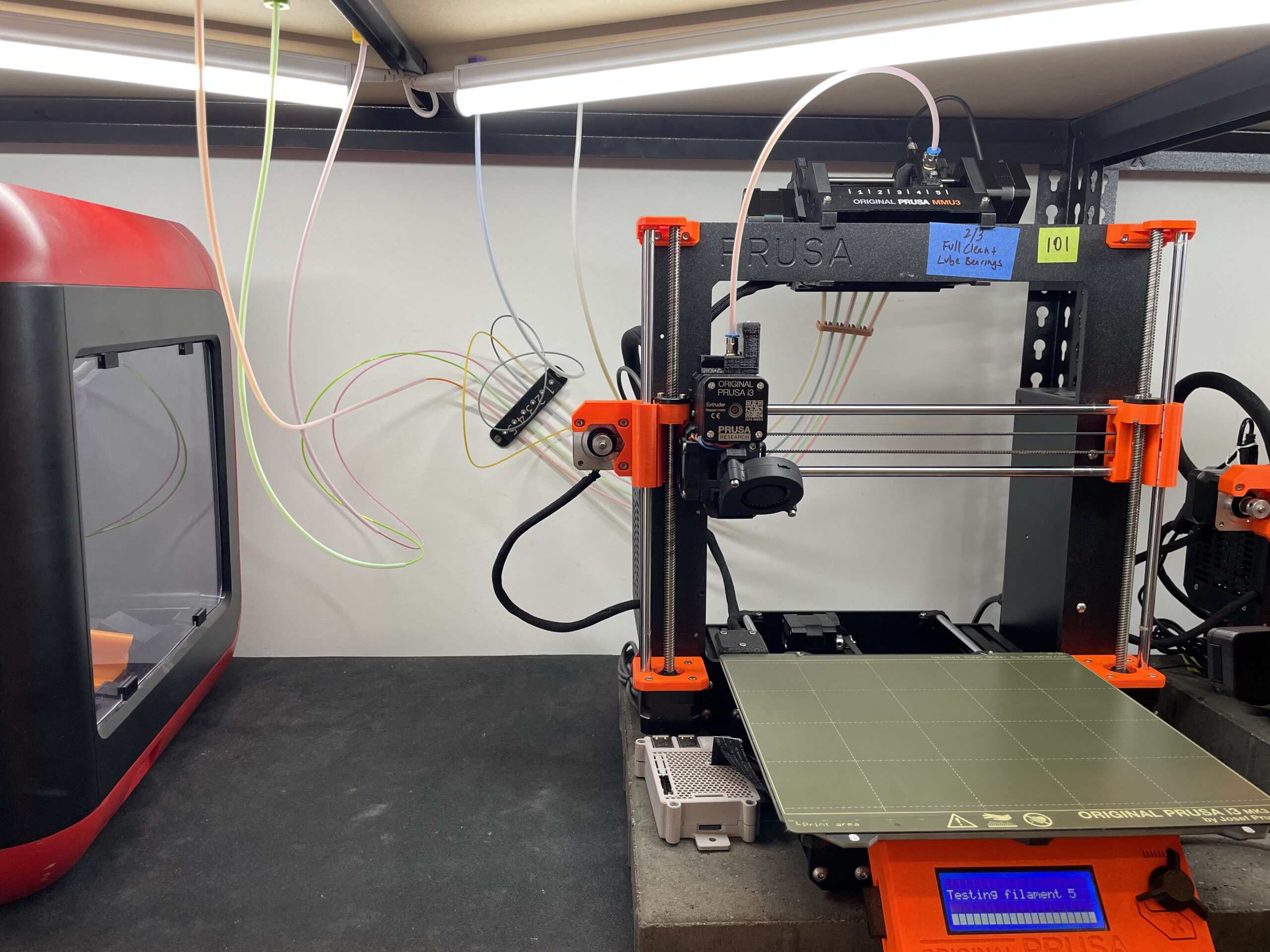

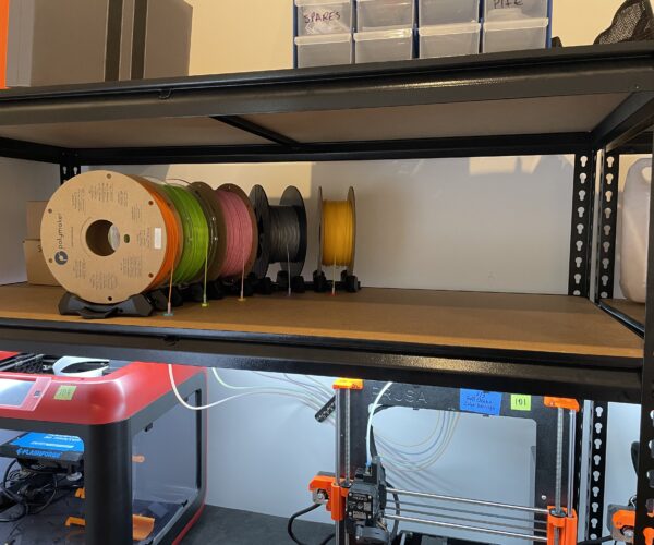

Firstly, sorry for necro-bumping, but this thread is the top result on Google for 'MMU3 Air Buffer' so I thought I'd add my setup to it for anyone else in the future.
Based on @joantabb 's description and diagram, I've setup my MMU3 in a similar way with the spools on a shelf above feeding to MMU tubes via hanging PTFE tubes. The buffering just pushes the filaments into the free space next to the printer, and so far there have been no tangles - it all seems to work really well!
Thanks for your old post @joantabb - it helped a lot!
Image 1: Spools loaded and unbuffered
Image 2: Top shelf showing filament passing through shelf via PTFE tubes
Image 3: Closer image showing the PTFE tube management
Image 4: All filaments fully buffered out into the air. The grey filament is nearing the end of the spool, hence why it is curled up the most.

This is my current setup, and I am very pleased with its performance. I have had a few incidents involving the ends of the tubes and the sight windows in the spools, but shortening the tubes a bit has resolved that. I still use the buffer that came with the MMU. It works fine now that I got my brains about me and load the filament as prescribed.
Thanks. Brad.
