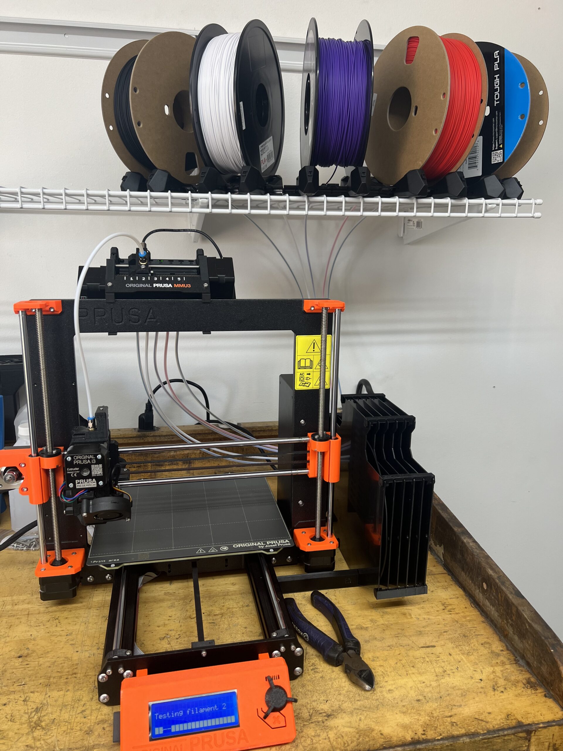

OK…. So now I’m going to backpedal a little bit.
Now that I’ve figured out how the buffer actually works (I forgot the cartridges come out, and was trying to load the filament with my hands between the buffer plates), I actually think I like it.
So my question is…. Why don’t those who don’t like it don’t like it? As a rookie, what am I missing?
Thanks. Brad.

Ok first it loads in and out the same side so if you've got your spools behind the printer that's a problem second of all on long prints fillament can come out the top third it's really annoying to load I'm going to try this one out https://www.printables.com/model/3292-mmu2-filament-buffer diffrent people have diffrent setups mah I ask what your setups like maybe a photo

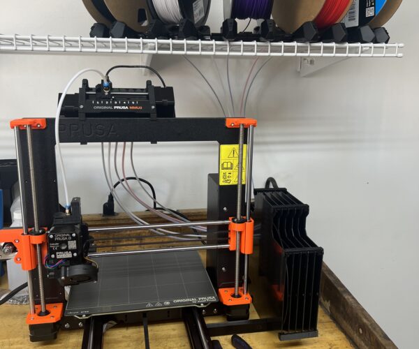

Hello,
I have not noticed the filament retracting enough to escape the buffer. It seems Prusa has worked out sizing pretty well. My only initial contention with it was that it was such a PITA to load the filament to the MMU. But, as I said, I was going about it all wrong. I had forgotten that the cartridges came out, and was trying to load the filament with my hands wedged in between the buffer plates, where there was obviously not nearly enough room for. I began to wonder what it was going to be like to have to swap filaments on a regular basis, or reload after emptying spools. But now that I’ve figured out the obvious; that the cartridges come out for the “load to MMU” process, I haven’t had any issues with the buffer. My question is in regards to those who say they don’t like it at all, going on the relatively safe assumption these individuals have gotten beyond my contentions with it, and have issues beyond that
Right now, I’m in the process of working out a better spool mounting setup, as the spool holders that are supplied with the MMU. They are…. Less than sufficient. And they are contributing to print issues and failures.
This is my current setup, aside from the fact that the spool holders are slated for the scrap pile.
Thanks. Brad.
