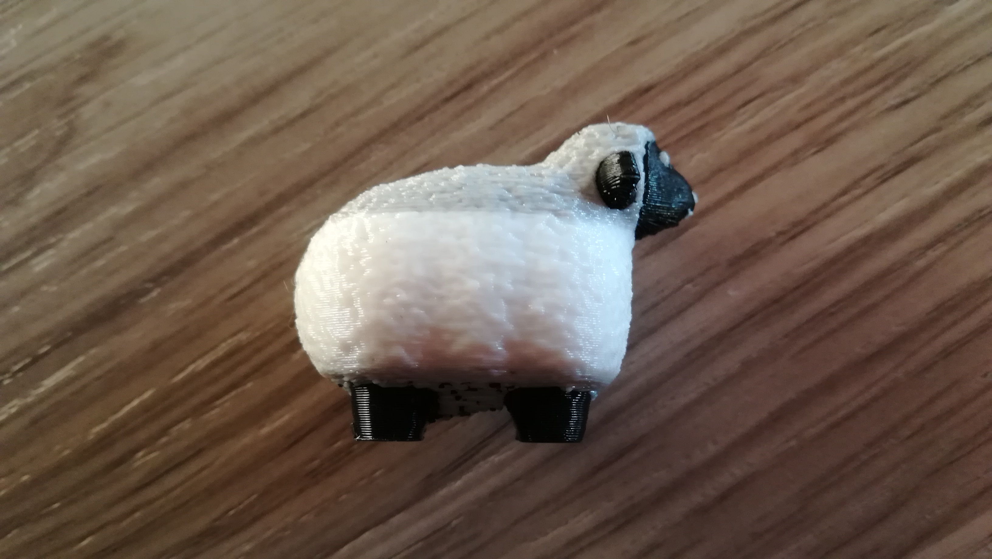

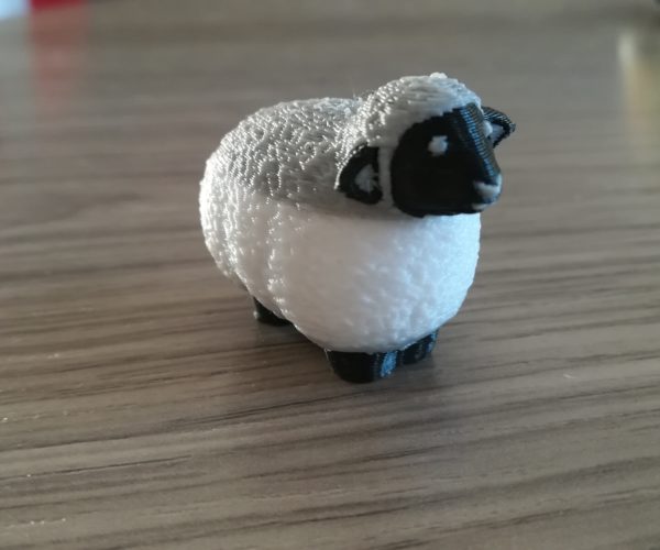

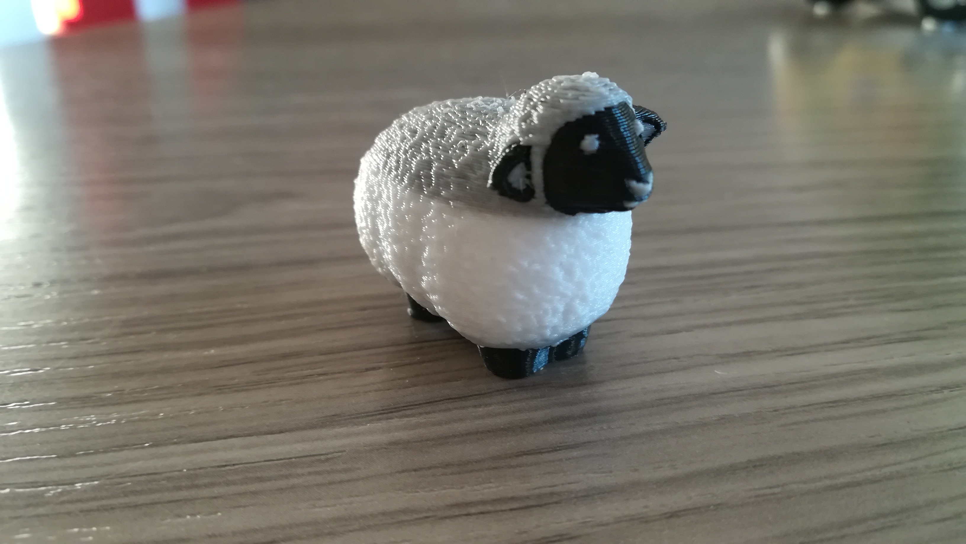

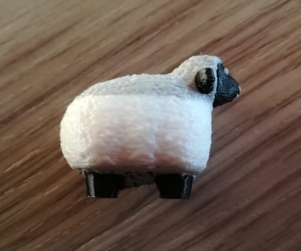

j'ai une MMU2S, sur MK3S, et lors de la première impression sur la carte SD fourni, j'ai eu un souci comme vous pouvez le voir sur la photo.
En effet , le mouton est un GCODE tout pret sur la carte SD de chez Prusa , donc GCODE parfait, qui est en théortie fait pour tester le blanc et noir, comme indiquer dans leur handbook MMU2S, et pourtant lorsque sur la meme couche il y a les deux couleur, le blanc devient gris....et ensuite dès que il y a que du blanc sur la même couche , il redeviens parfaitement blanc, avez vous déjà eu ce problème ? est ce un problème de filament (noir prusament et blanc giantam), merci d'avance de votre retour ou expérience

Some colours are difficult to purge. so when you slice the model, you can increase the purge volume for the colour change, black to white

Thank you for your answer, that's what I thought, but what I don't understand is that it's not me who is "slicer", it's the test of "prusa" special white and balck , do you think that with white filament from "prusa", it will work?

If you used different colours it may work.
I think the problem colour is the black,
RE: problème couleur qui se mélange GCODE test
it is strange because the black filament is of the brand prusa filament,
therefore of good quality, and the gcode is made just to test the two colors difficult to print together,
white and black,
I saw videos of people print the same gcode file, with black and white and it was perfect,
I will try with a larger purge tower,
again thank you for your time

I never said the filament was defective.
the situation is that when changing colour with the MMU2, some filaments are harder to flush out of the extruder. in the example we saw Black to White resulting in a lot of Grey. where as white to black didn't seem to result in Grey...
Red to White is often a problem,
Any dark colour to Yellow, seems to give a problem...
if you try to use Prusa Code, for the Sheep, then YOU have to manage the colours, to find ones that play nicely,
If you choose to slice the models yourself you cn change the Purge ratios, to improve your results.

Sinon oui (merci Joan) c'est le blanc qui est pollué par le noir mais regarde attentivement ce noir si tu ne vois pas un peu de blanc.
Est-ce que tu as choisi la purge par remplissage car on voit que pour la partie blanche la surface est importante donc purge conséquente (comment est l'intérieur visible pendant l'impression ?) contrairement au noir où la tête entre autre est petite. Montre nous le bloc de purge plise lovmidou 😊

Et pour mon problème , comme je l'ai dis plus haut, je n'ai pas créer le gcode, c 'est le gcode de test de Prusa , spécialement conçu pour le noir et blanc , d'ou mon étonnement , sinon , évidement j'aurai augmenter ma purge, et pas demander d'ou venait le problème, c 'est pourquoi je trouve étonnant de la part de Prusa d'avoir fait un gcode de ce style .
Et donc mon post était la juste pour savoir si d'après vous , qui avez plus l 'habitude avec le MMU2S, le fait d'avoir peu etre un filament de mauvaise qualité peu rentrer en compte dans cette purge qui a mal fonctionner.
